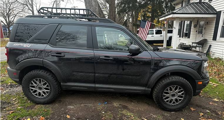

I'm a Mickey Thompson fan. My Baja Boss tires plow through elements (mud/sand/snow) I wouldn't try to walk through and they wear like iron. Just fine in wet weather as well. Some might say they are noisy and a little stiff, but if I was looking for a soft, quiet ride, I would have bought a Lincoln, not a 4 wheel drive.

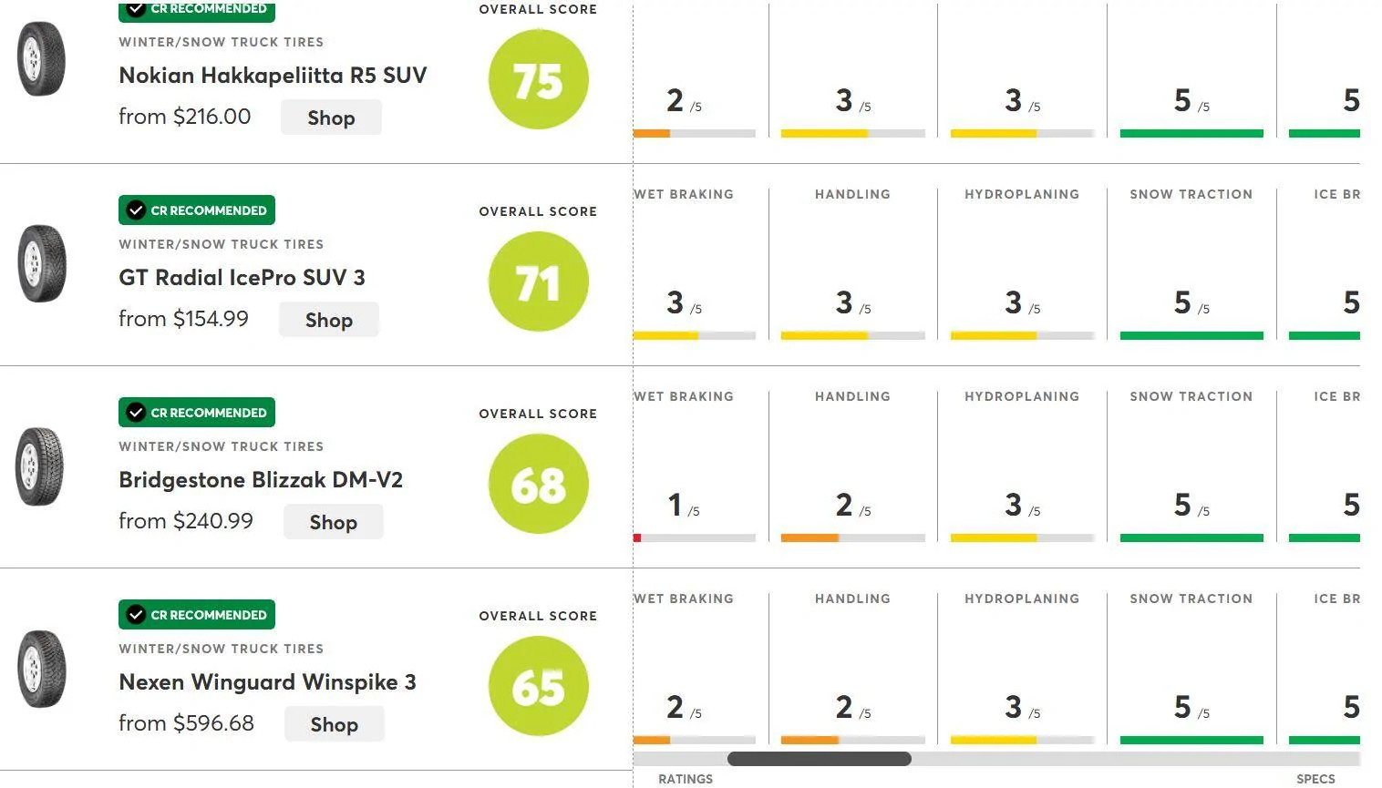

The DM-V2's are very good, but when you are ready to replace them, there are even better choices:
Ford Bronco Sport Winter Tire Disappointment 1733523976592-fi
There are more columns of data. I split 'wet braking' and 'ice braking' to show as much info as possible. Not shown is "owner satisfaction" which is 5/5 for both the DM-V2 and Nokian.
Looking at just what's visible above, while the Nokian is best overall, the GT has a notch better wet braking (3/5 = good or average). That's actually a good score for a winter tire -- they are almost always fair-poor for wet braking. Something to consider, although from my time in Wisconsin, I don't recall much "wet" -- primarily just sand mixed with snow, until the spring thaw sometime in May... :cool:

Not to be negative but since all of the tires above are rated excellent (5/5) for snow traction and ice braking, it shouldn't make much difference which ones you use.
In the OP you said braking is not as good. Obviously the AWD system does not affect braking, but if there is a difference between the two AWD systems, that might account for a variation in accelerating and hill climbing on snow & ice.
