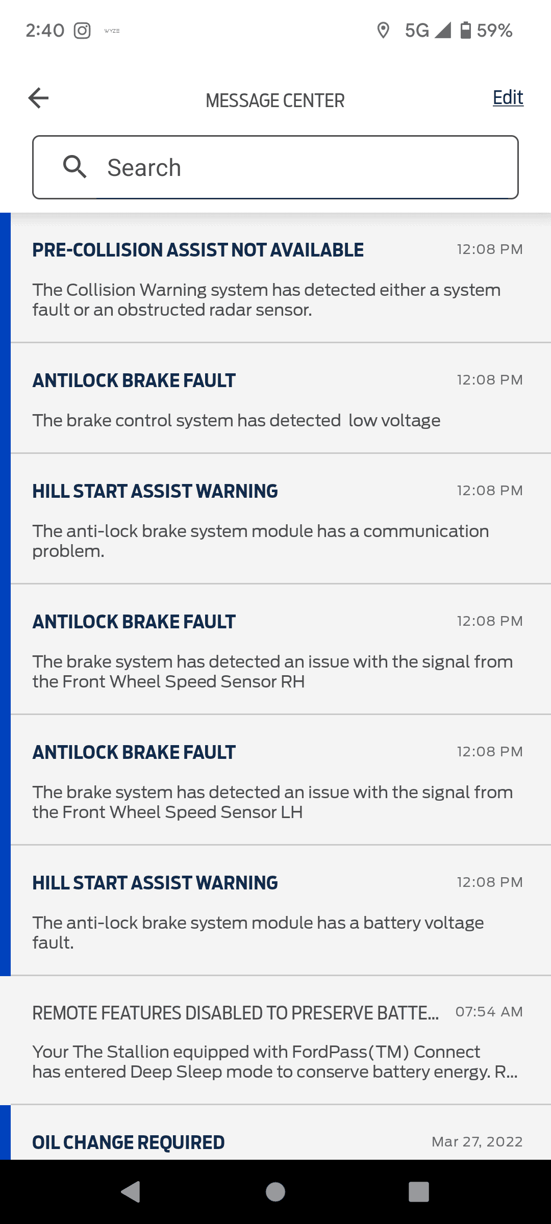

Given the collection of errors, if the BS required a jump start, it probably needs some time for the battery to be charged. Electrical errors like this, especially in this quantity out of the blue, generally means the battery is low on charge or possibly bad.
Yeah, the battery might have drained due to the original issue that occurred while driving.
