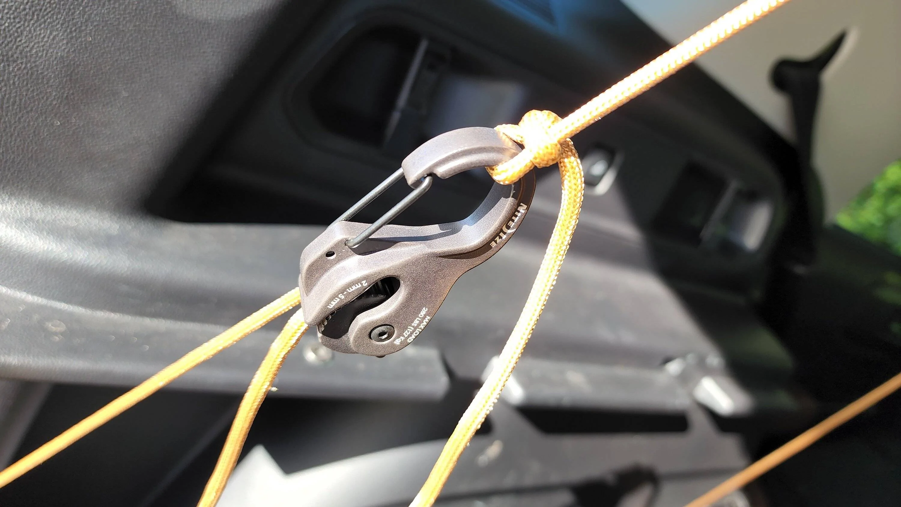

  2. Alternatively, buy two of these CamJam XT from REI for $13.50 by NiteIze which come with paracord:

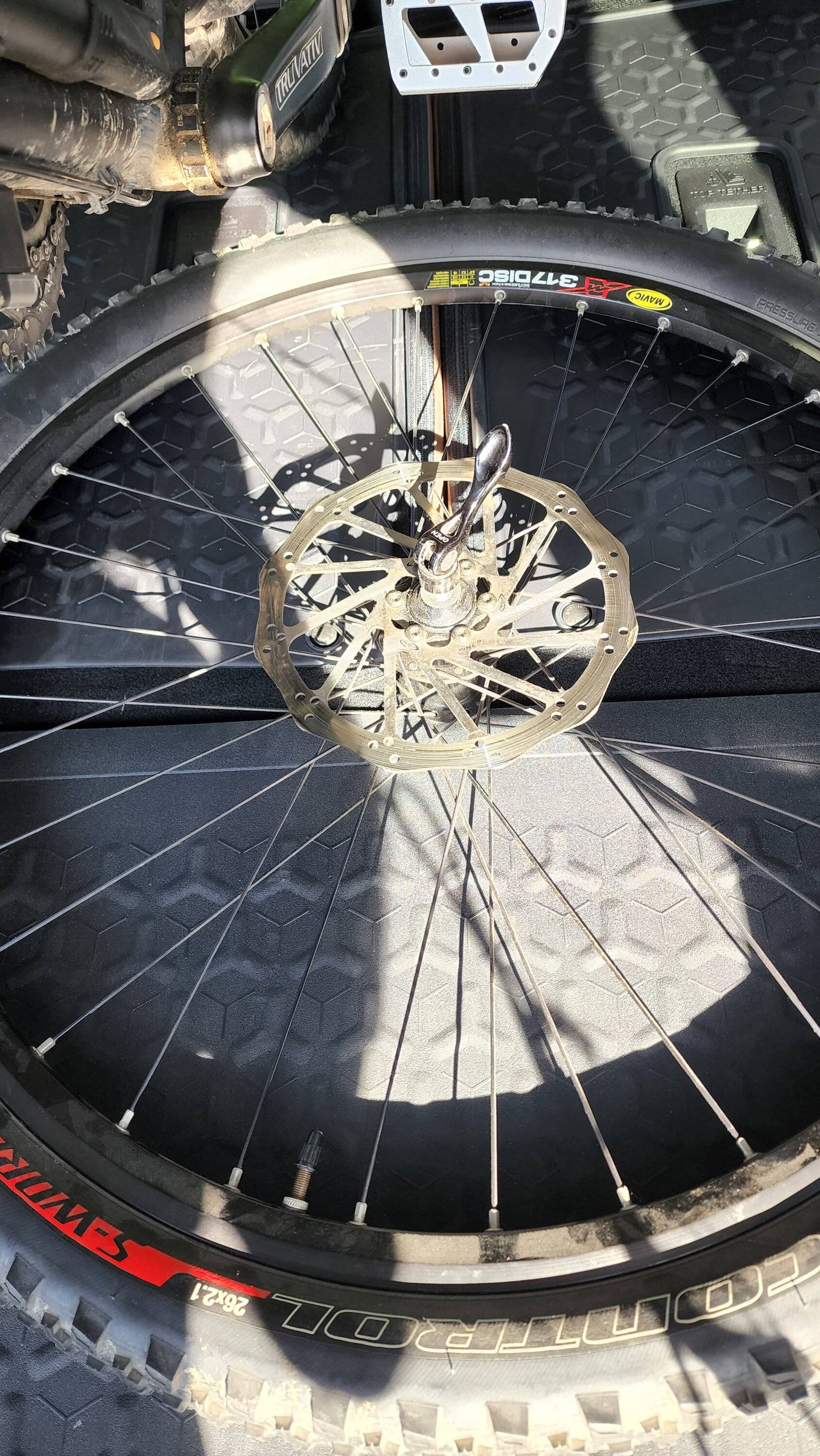

  3. Fold down rear seats and remove bike front wheel and seat

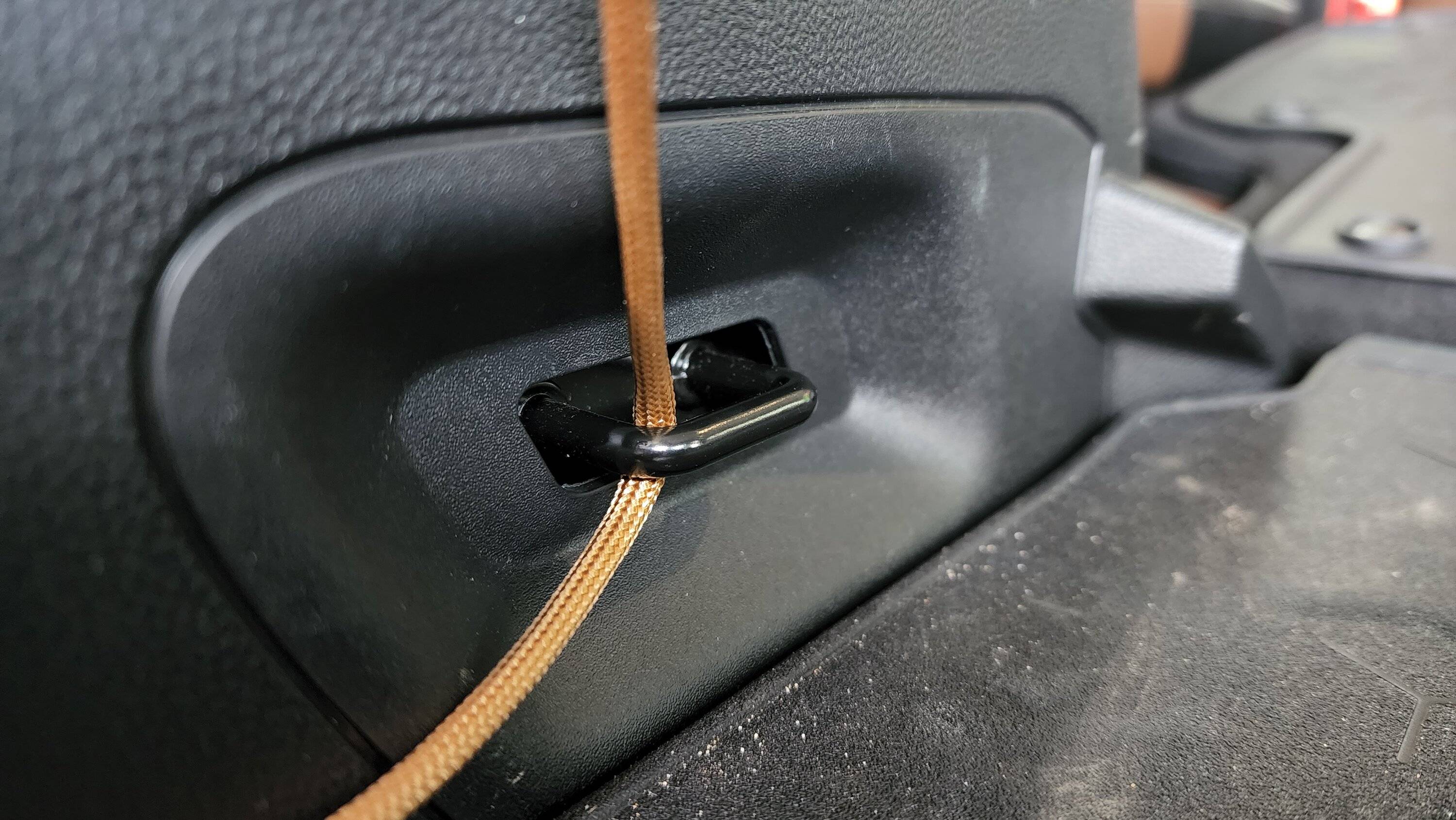

  4. Run the Paracord through both metal anchor points:

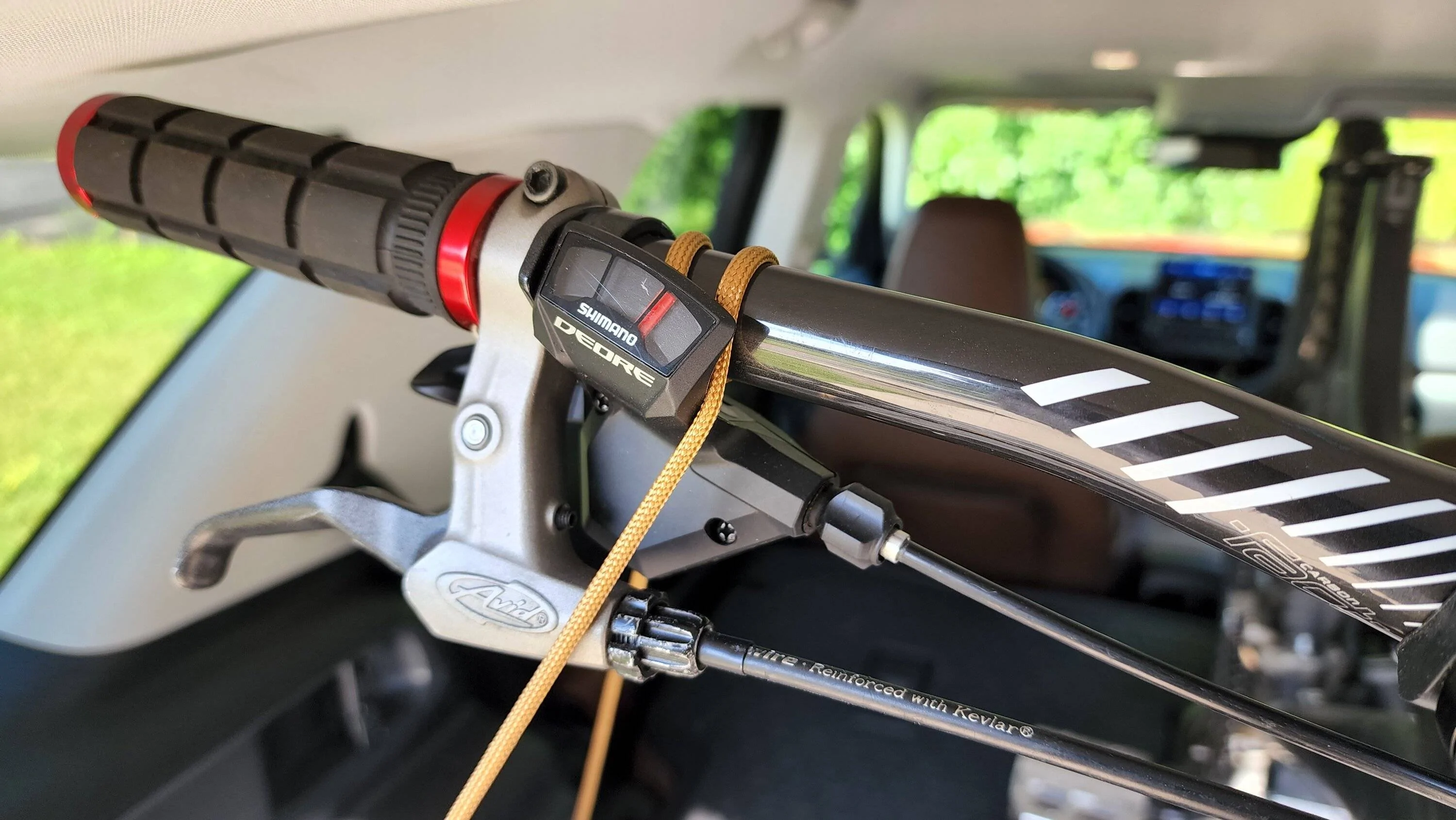

  5. Run the cord that's coming from the front metal loop over the handlebars and loop around the handlebar once close to the grip:

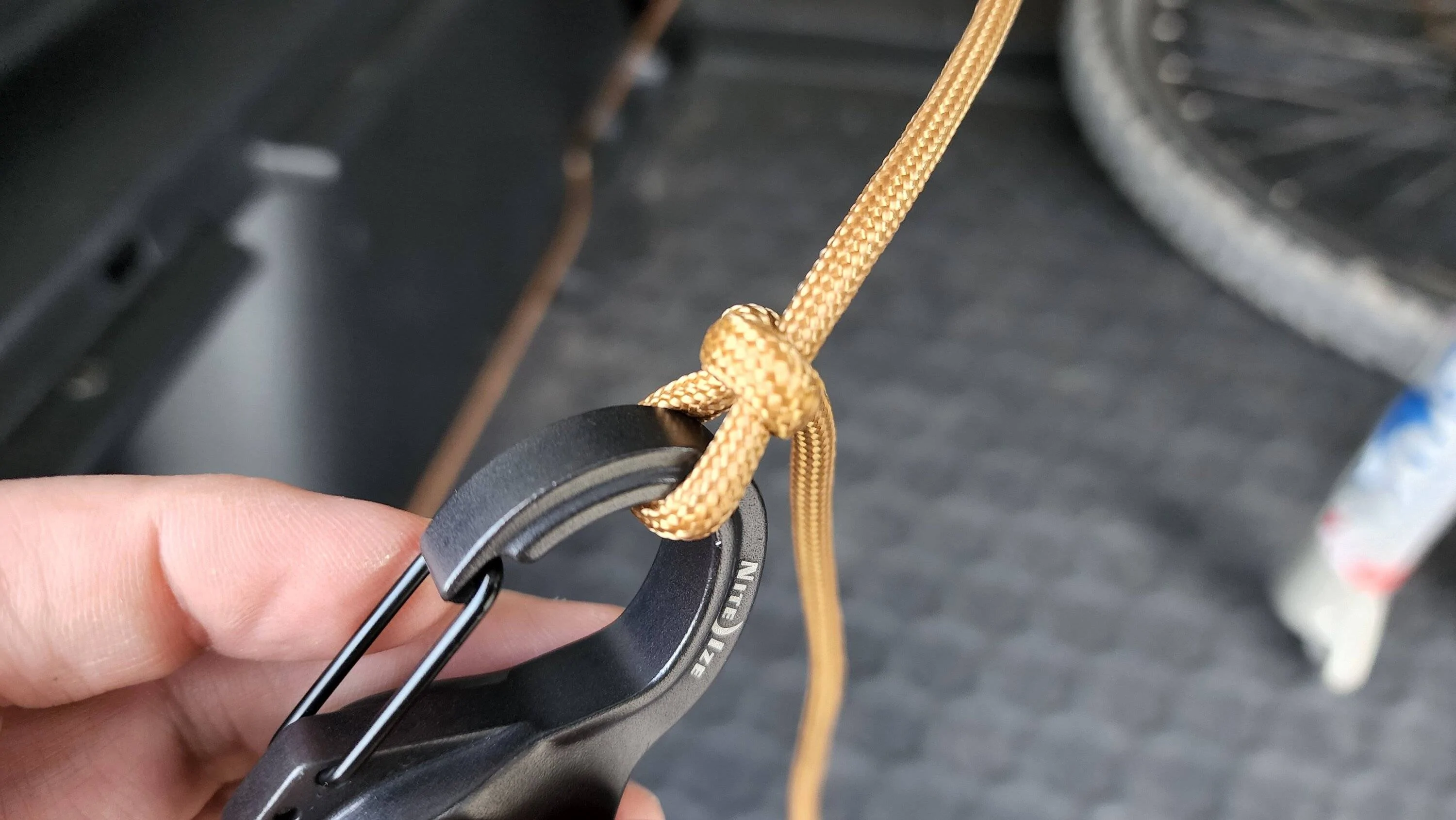

  6. Take the loose end and tie a slip knot like this for the hook to attach to:
    Ford Bronco Sport TUTORIAL: How to rig a bike in the back of your Bronco Sport 20220710_191043
  7. Attach the hook to the loop and tighten the slip knot:

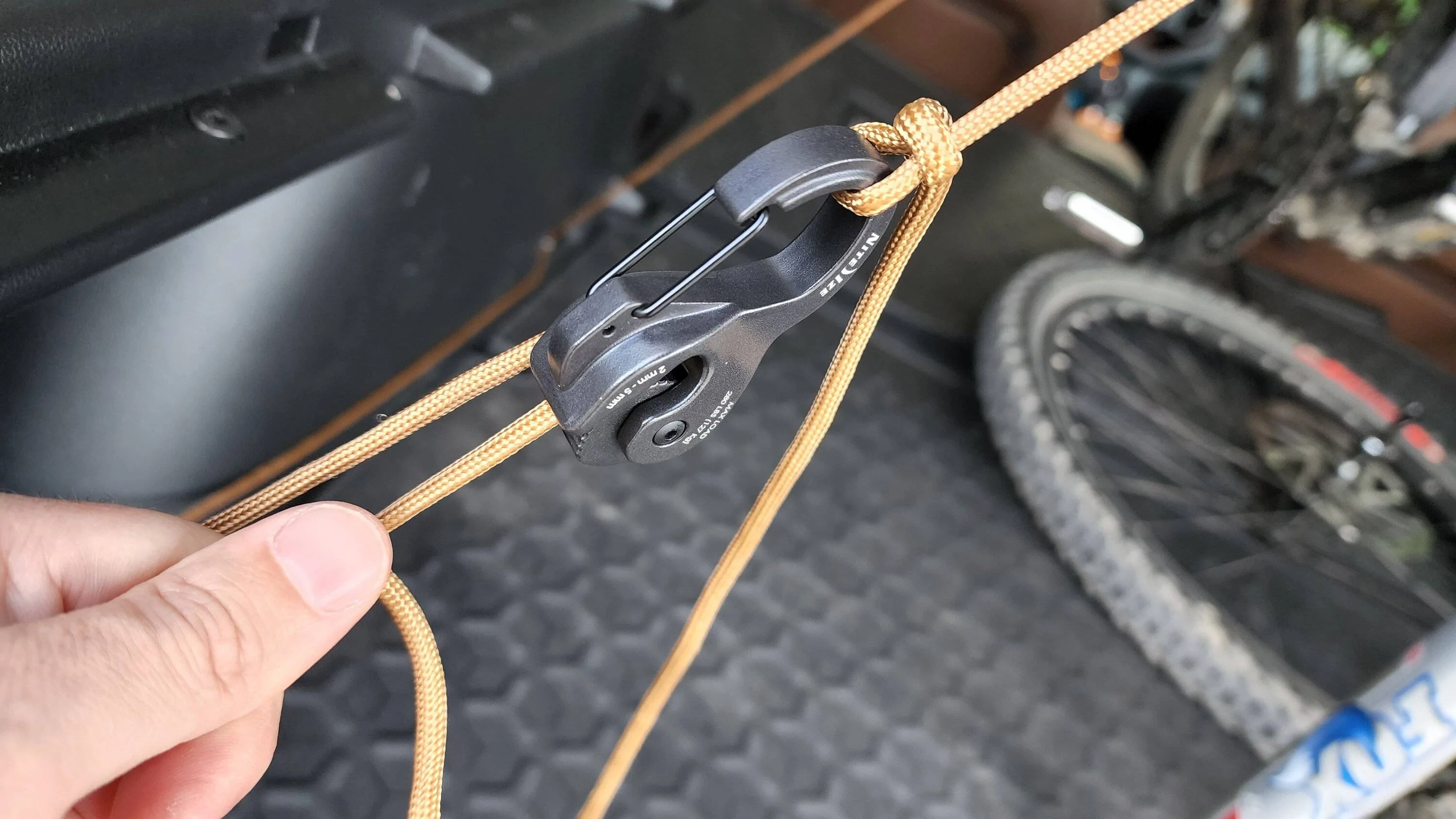

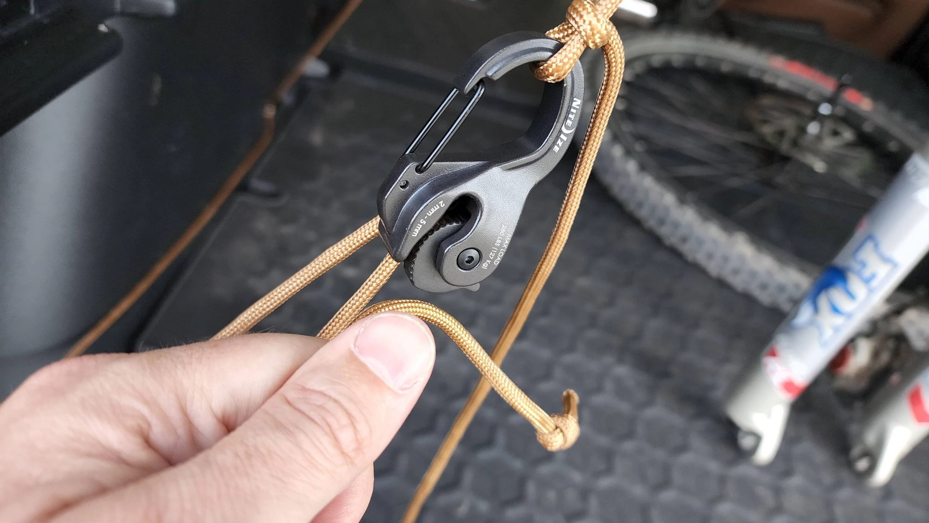

  8. Pull the knot end of cord through the cam mechanism of the metal hook:
    Ford Bronco Sport TUTORIAL: How to rig a bike in the back of your Bronco Sport 20220710_191118
    Ford Bronco Sport TUTORIAL: How to rig a bike in the back of your Bronco Sport 20220710_191138
  9. Tighten the cord until the front suspension on the bike starts to compress:
    Ford Bronco Sport TUTORIAL: How to rig a bike in the back of your Bronco Sport 20220710_191142

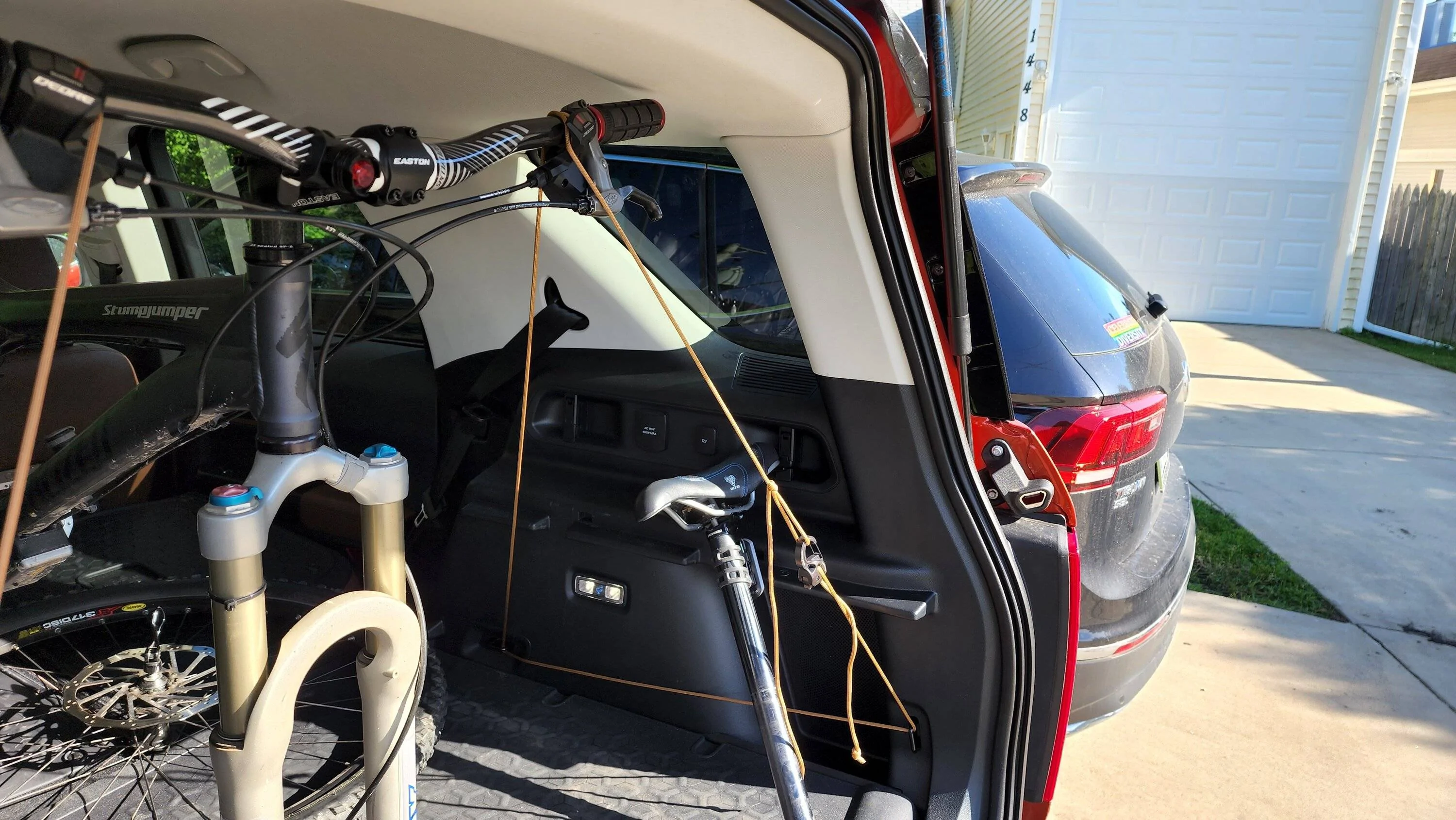

  10. Repeat for the other side:
    Ford Bronco Sport TUTORIAL: How to rig a bike in the back of your Bronco Sport 20220710_172550

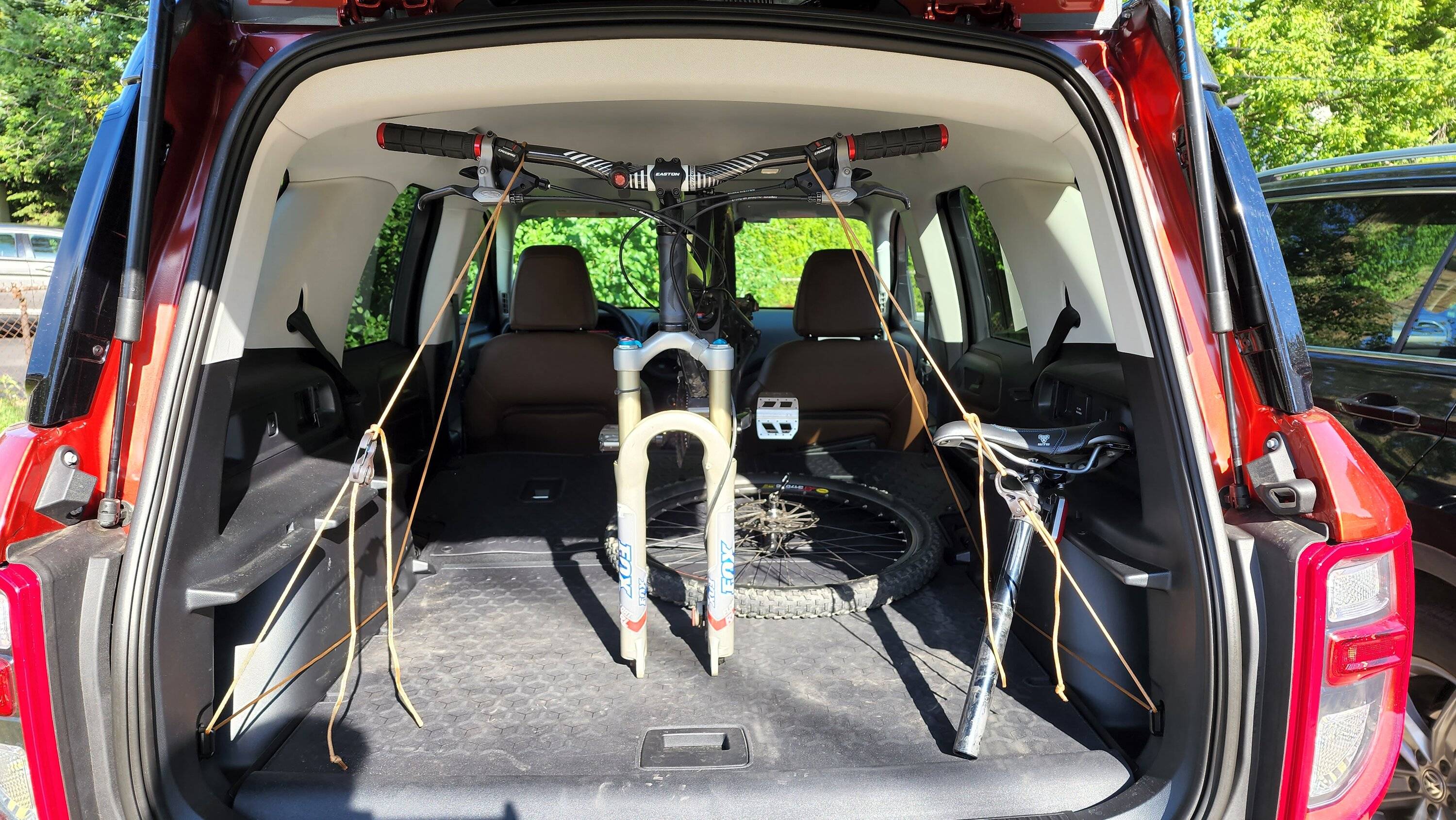

The bike is now secure.
Ford Bronco Sport TUTORIAL: How to rig a bike in the back of your Bronco Sport 20220710_172509
Alternatively, learn how make a Truckers Hitch and you can skip the hooks and just use Paracord. Bam! You just saved yourself $200.

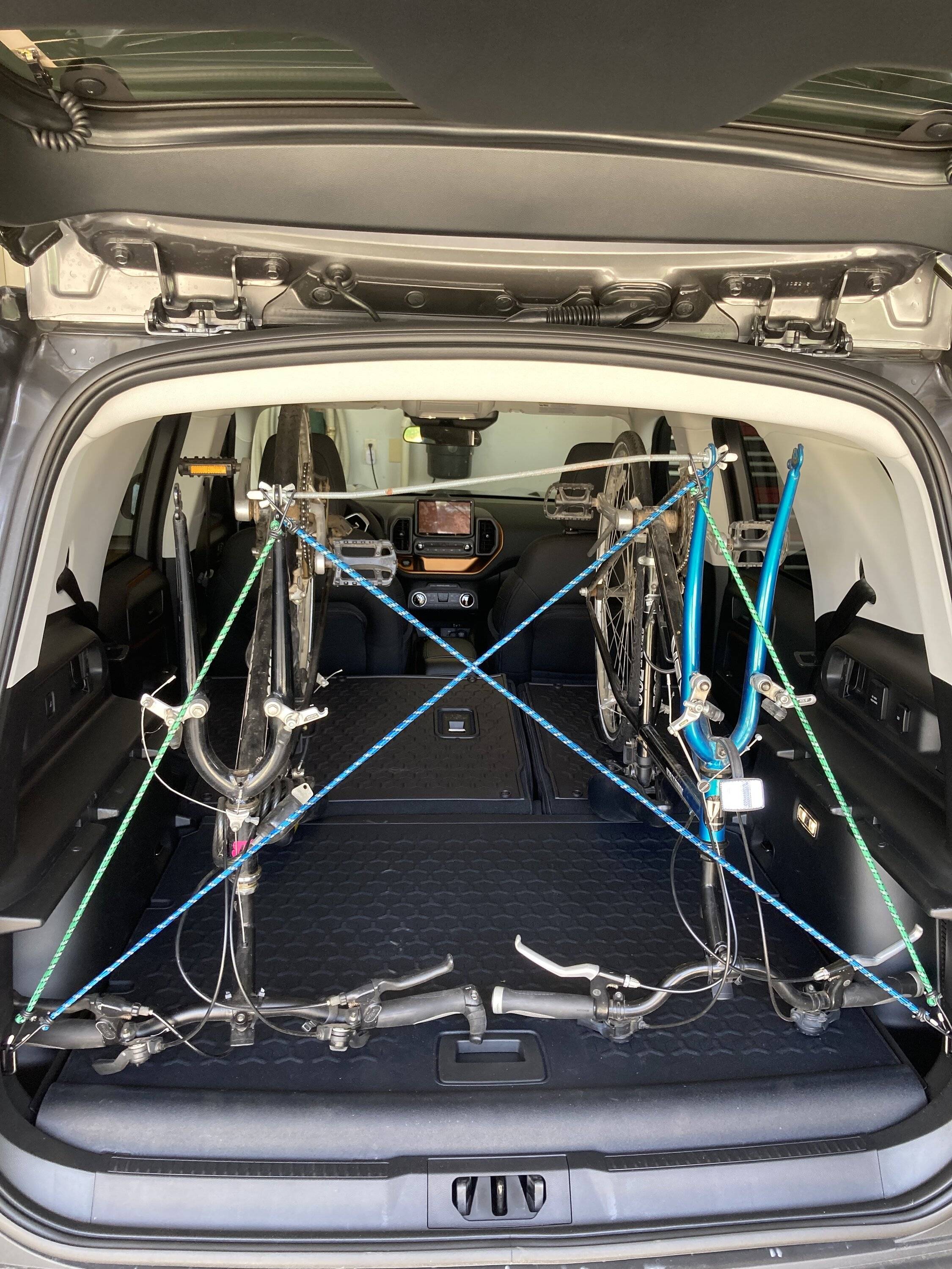

Here is my solution to that:

I thought about inverting mine too. How secure is it?
