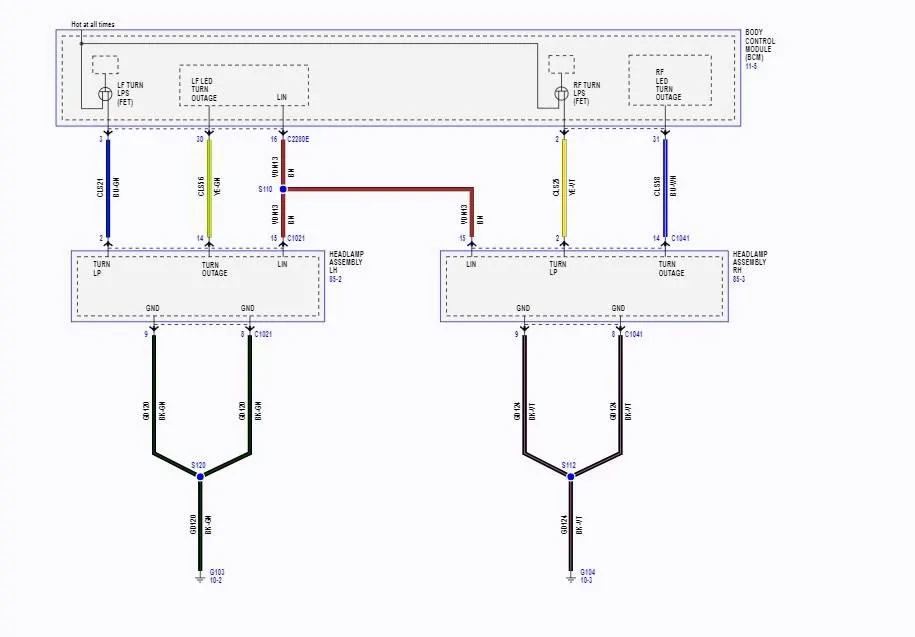

Just a wild idea I have been tossing around, but if someone wants to add turn signals- like a signal on the mirror, where might you tap into that harness? The headlights seem to do some sort of advanced internal switching which turns off the DRL and turns on the blinker. So is there an easy way to tap that line, or is it all logic gated internally? Would it be better making a run from off the rears?

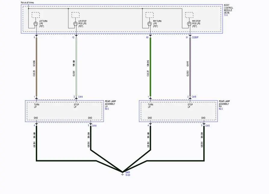

Here is the wiring for the turn signals, front and rear.
Ford Bronco Sport Turn signals TurnS1
Ford Bronco Sport Turn signals TurnS2
Also can be found at the towing connector. Yellow is Left, Green is Right.

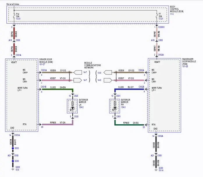

Edit: Looks like this is also found at the door modules. Calls out the mirrors actually.
Ford Bronco Sport Turn signals TurnS3

Thanks for these! Tentatively it looks like we'd want to sample signal-power from the BCM side FETs driving the "Turn LP" (Turn Lamp) in each of the headlight assemblies for front-right (CLS25 Yellow-with-Violet-Stripe) and front-left assemblies (CLS21 Blue-with-Green-Stripe). I say "sample" because the circuitry around the FETs might be instrumented to gauge load through the FET, so the possibility of driving LED strips directly might need to be balanced against driving low-power mechanical relays or SSRs instead.
Alternatively, if the BCM is programmed to drive the driver's (DDM) and passenger's (PDM) door modules and the leads are populated in the downstream wiring harnesses, it might be possible to leverage the mirror-signal circuits directly.

This is sort of what I was afraid of in the OP. Most all of the Badlands lighting is LED modules and they can be finicky about voltage and loads. But the taillamps are traditional incandescent bulbs. That's why I was wondering if the rear is a better tap point. Must have something to do with trailering connector compatibility.

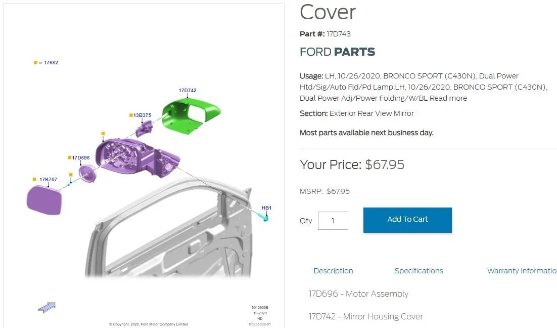

I found something interesting while looking around the parts catalog. Here is a Bronco Sport mirror... listed for a LOT of options I have not seen. Including Turn Signals, Puddle Lamps, and Auto fold.
I cant seem to track down the part numbers for the lamp, but it definitely exists.
Anyone see this before?
