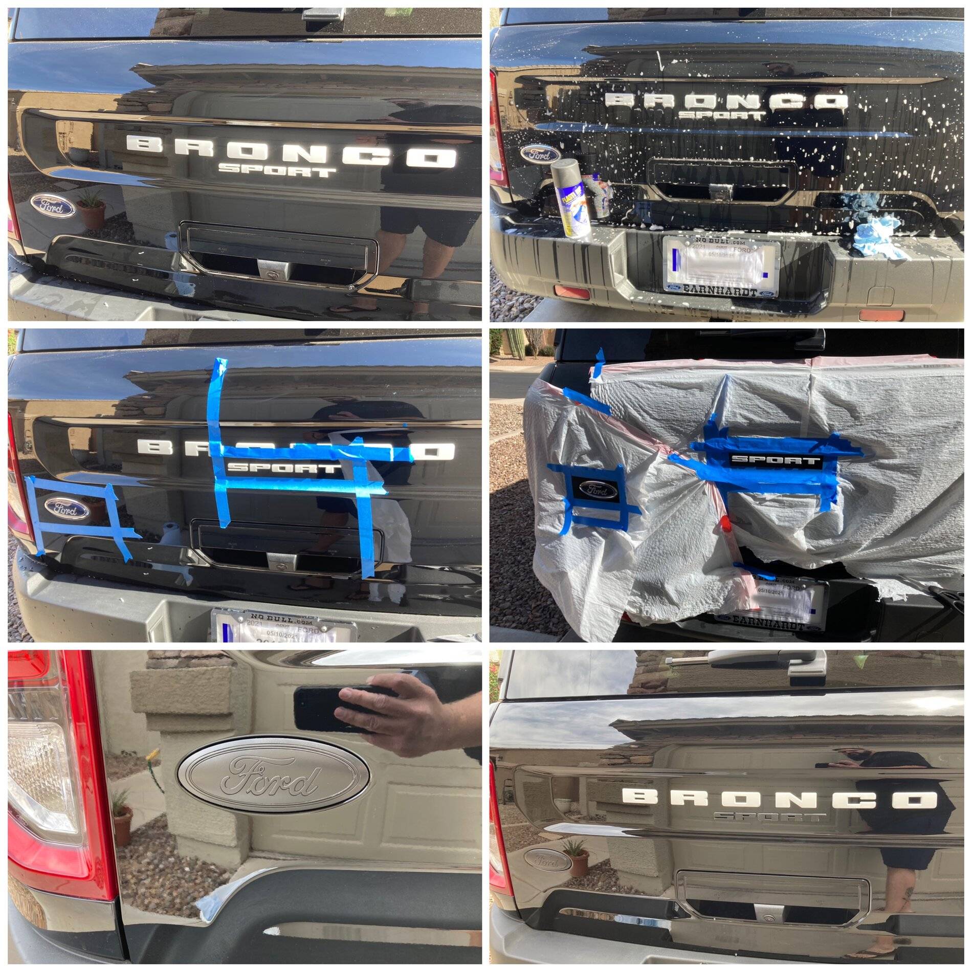

I Plasti dipped the letters on the back of mine, it will not harm the paint at all, but obviously you don’t want to get plasti dip everywhere. So take the time to cover and apply several layers of plastidip starting with a light coat. Many videos on how to do this an YouTube. Have fun!
