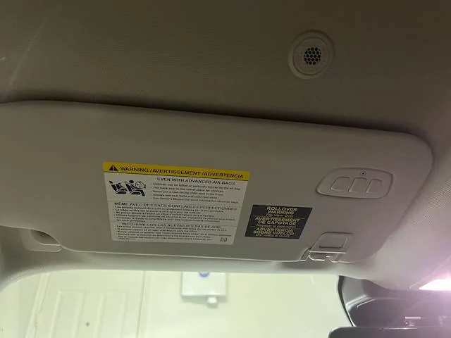

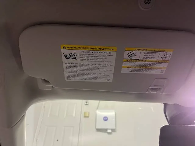

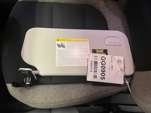

Bought a '24 BS Homelink sun visor for $75 off evilBay from a breakers yard. Had a few grease smudges on it from whom ever removed it from the original vehicle, but easily cleaned up with some interior cleaner.
Plastic trim removal tool, Torex T20, removed old visor, installed in my '25 BS BB, and programmed. Total time less than 15 minutes. Hardest part was getting the angle (approx 45 degrees) just right to release the plastic J channel side of the mount.
