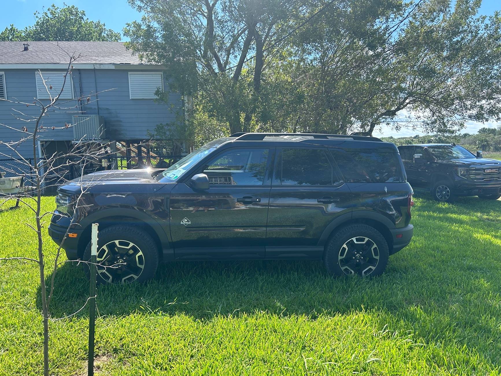

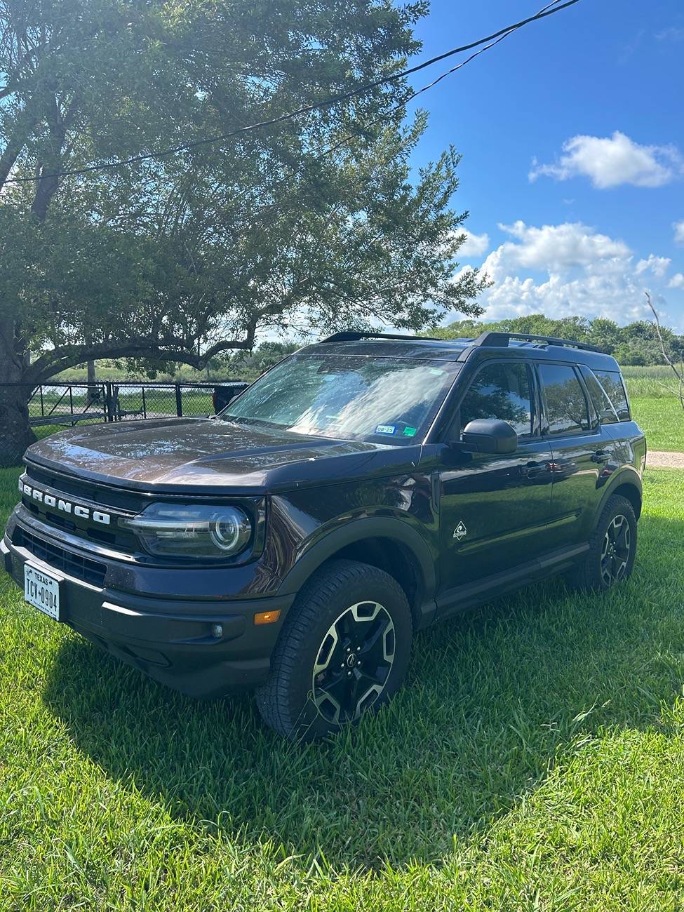

I recently installed the 2” lift from flat out suspension and put bigger tires on my wife’s outer banks. The past 2 days she has gotten a service advanced track, the brake assist not available, powertrain fault, stability control, hill start assist and pre collision assist warnings/failures.
Had anyone else experienced this? Went with falken 235/65/18. Looks great on there but not if it’s going to lead to these issues.
