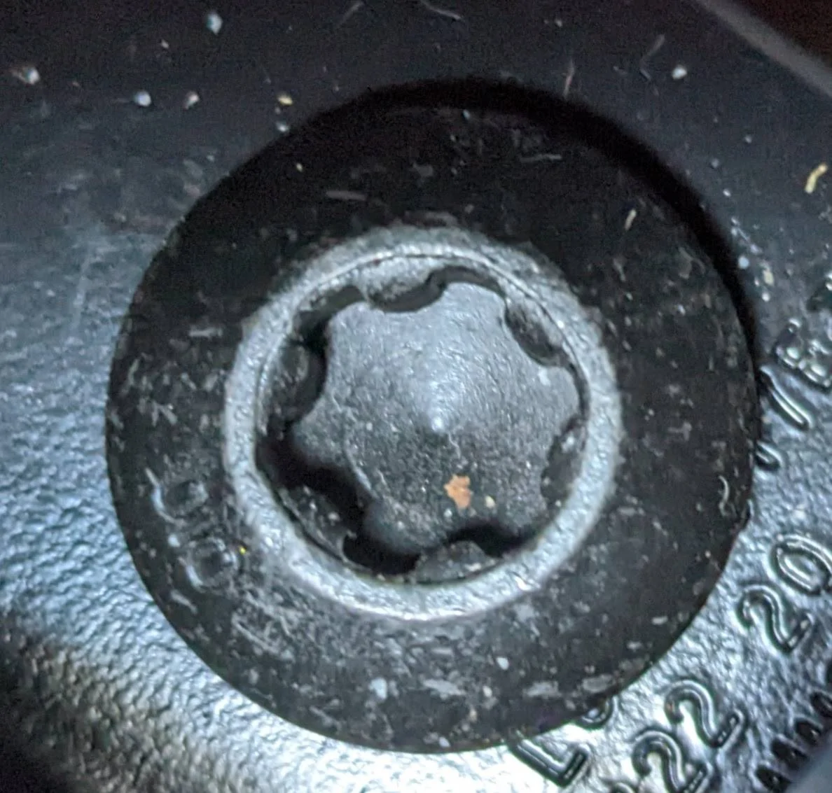

Yeah torx bits. You may have a local hardware store that’ll let you try sizes or could just buy a set. Are cheap enough
3,515
5,174
3,515
5,174
Torx T50 was too small
What size was it? Normally T50 is for the seatbelt bolts. I think there are only two other larger sizes T55 and T60.
3,515
5,174
Not sure. I ordered the two larger sizes
Where exactly is the bolt located? Is it under the small black rectangular cover? I looked for it with no success.
3,515
5,174

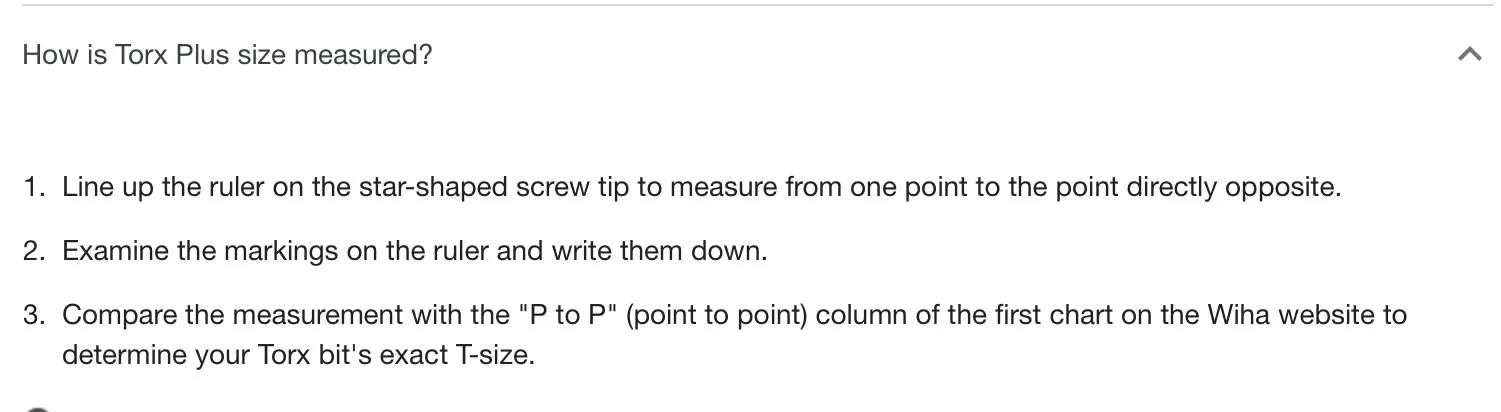

Based on a closer look at your picture, it appears to be a Torx Plus type.
On the front of the seat track rail there is a rectangular cover. If you pry that open it's under there.
