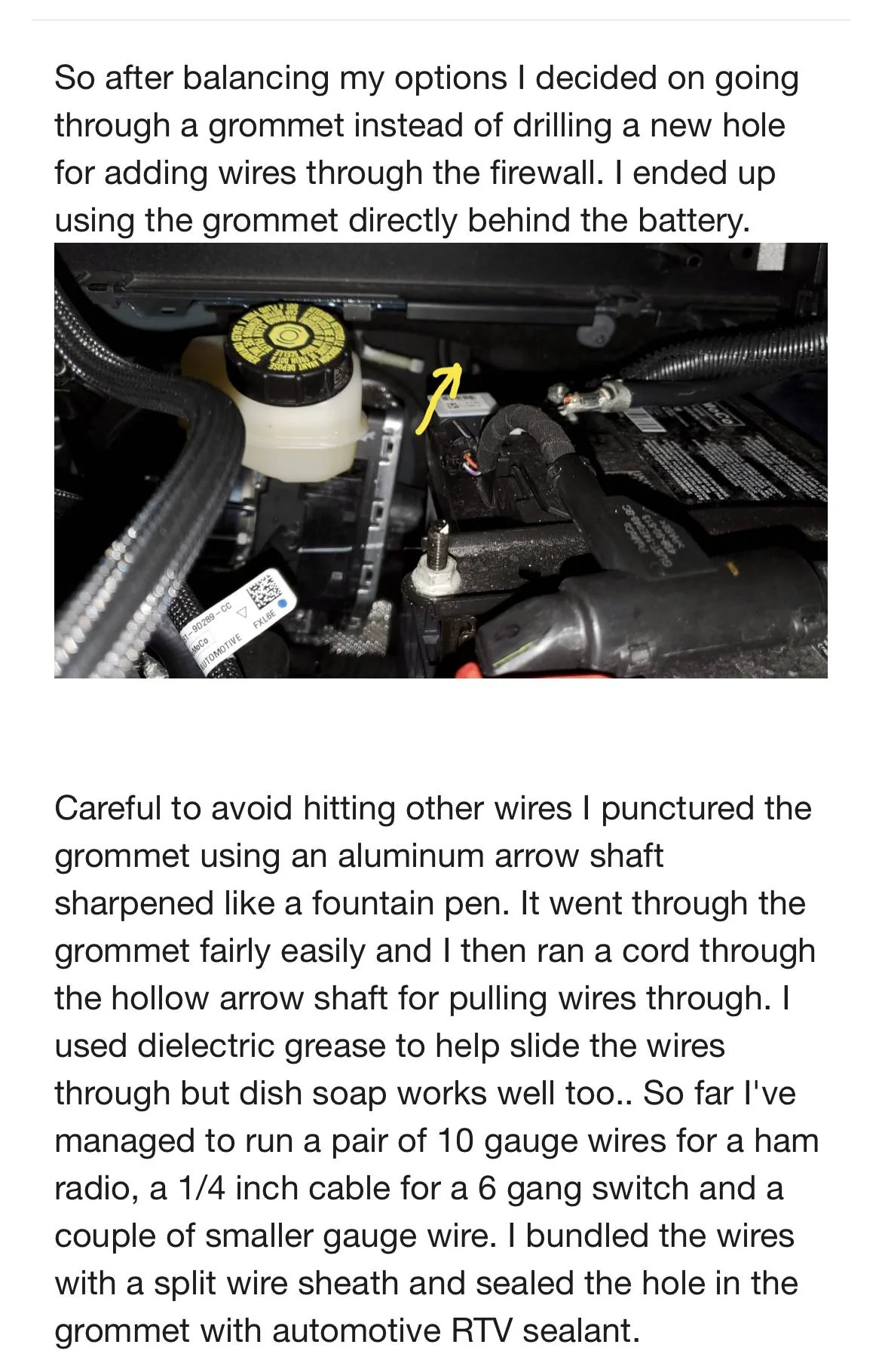

Like to thank whoever suggested to use grommet on driver door post. Just used this method it is very easy I just used a piece coat hanger at a downward angle and fiddled around a bit and it goes right through near brake pedal. Tape string or wire and pull right through. Thanks again works great

What I did was cut the tip off the Nipple on that gromet. Its at the 5 o'clock position. Then once I ran my wires I put some RTV to seal it. That nipple is a pass through.

Do you have some pics? Getting ready to do the same
