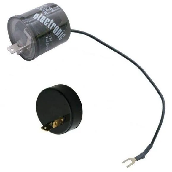

This is common when replacing with LEDs. Visit the SuperbrightLED website and they have the resistors and steps for installing the resistors to make the hyperflash go away.

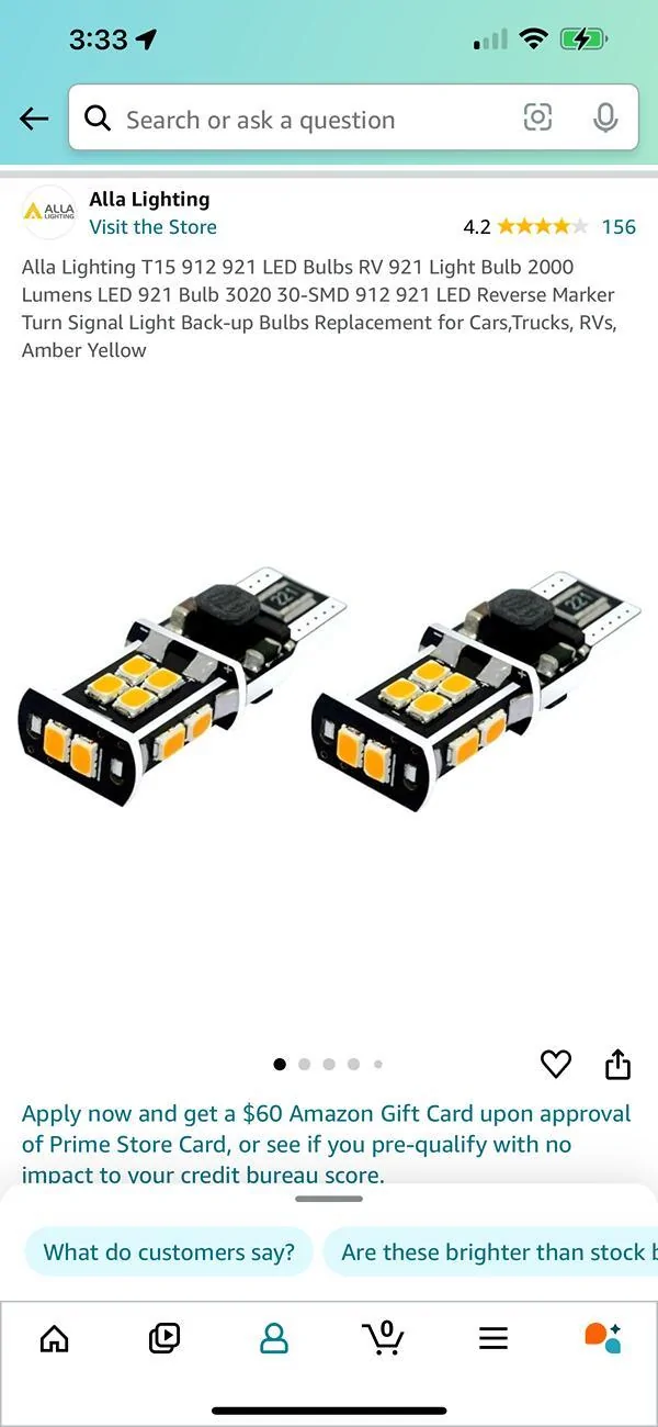

I used this one
Thanks!!
Was just curious on why flipping the bulb solved your fast blink, the description and some of the review comments I read didn’t indicate the product has resistors
“plug-n-play, yet for some vehicles with CAN-BUS system, load resistors maybe required to avoid the error code” (aka fast blink)
https://a.co/d/2Zh0NfR
Richard
Aug 24, 2024
there was a reviewer on one of the forums that stated it changes the polarity and would fix it and it did.
