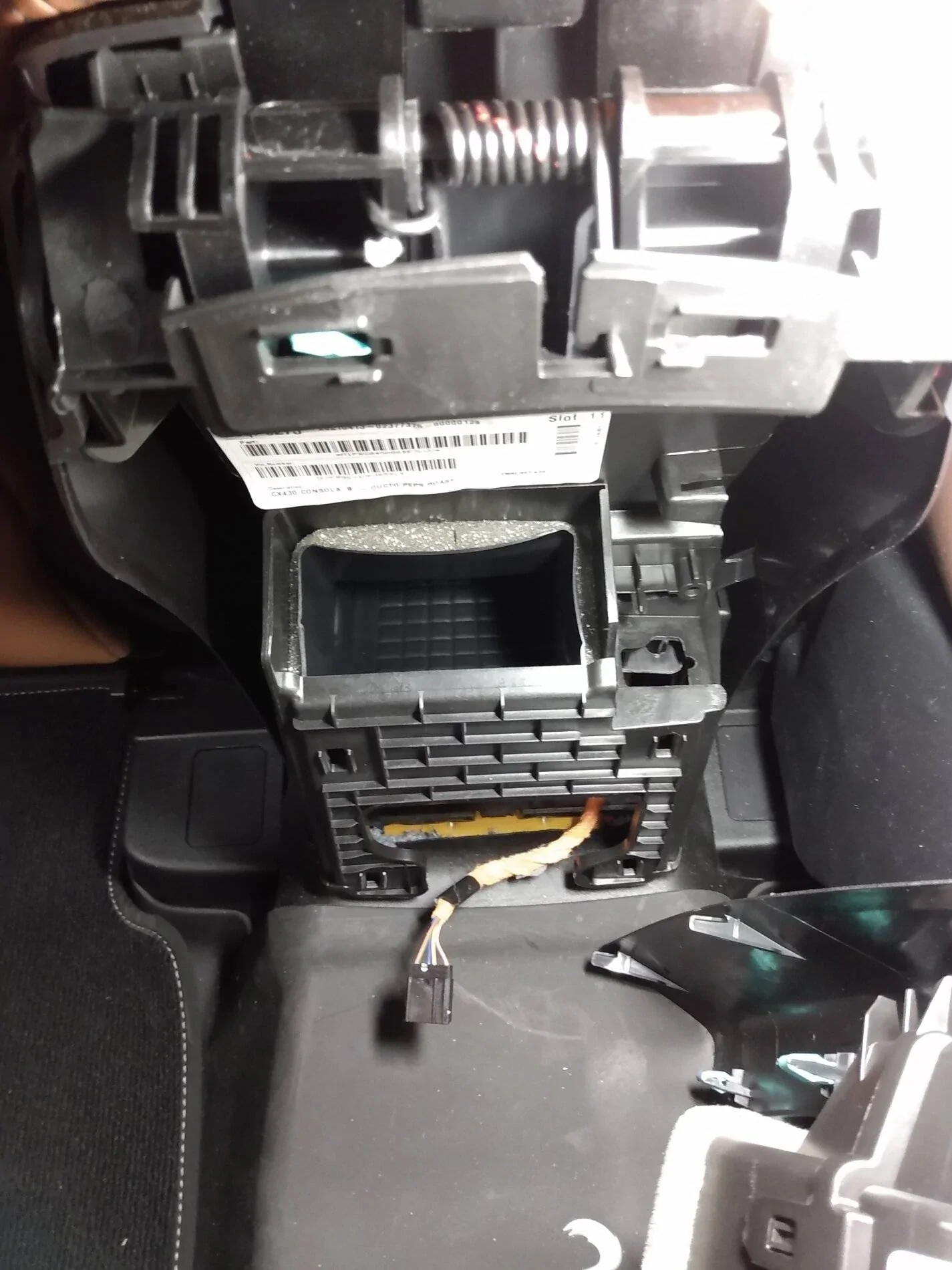

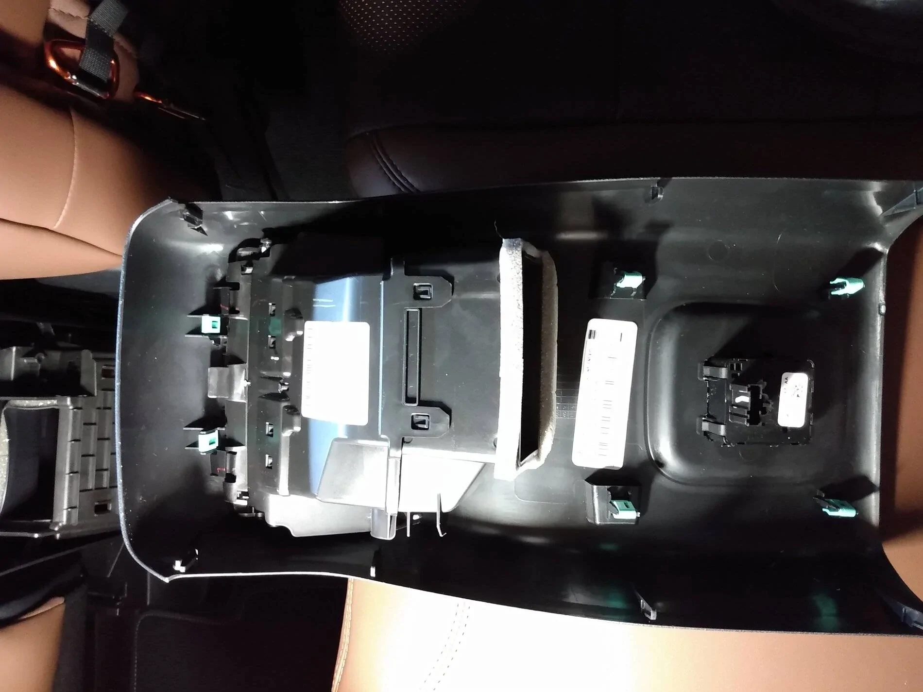

I am looking to remove my console for some work and by Googling, this was the only thread that came up anyplace. By looking at the Fort parts site, I was able to determine the answer for this one. So if anyone else comes along and needs to get access for lost treasure or even to open and clean out the dusty ducting in later years, the answer is simple.
I opened the lid and grasped the rear very firmly on the sides at the top. If you pull evenly with enough force, the clip retainers will pull out. Pull it back and lift out the bottom. Gone are the days of spring metal clips... these are plastic. They are the minty green things on the panel in the photo below. I didn't break any, fortunately, but they are really cheap if you did. Notice one came off in the first pic, and I had to reinstall it after finding it.
