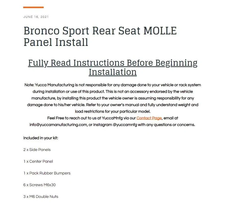

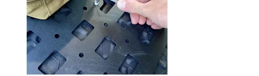

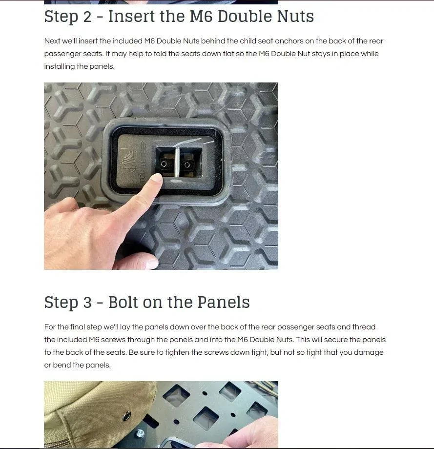

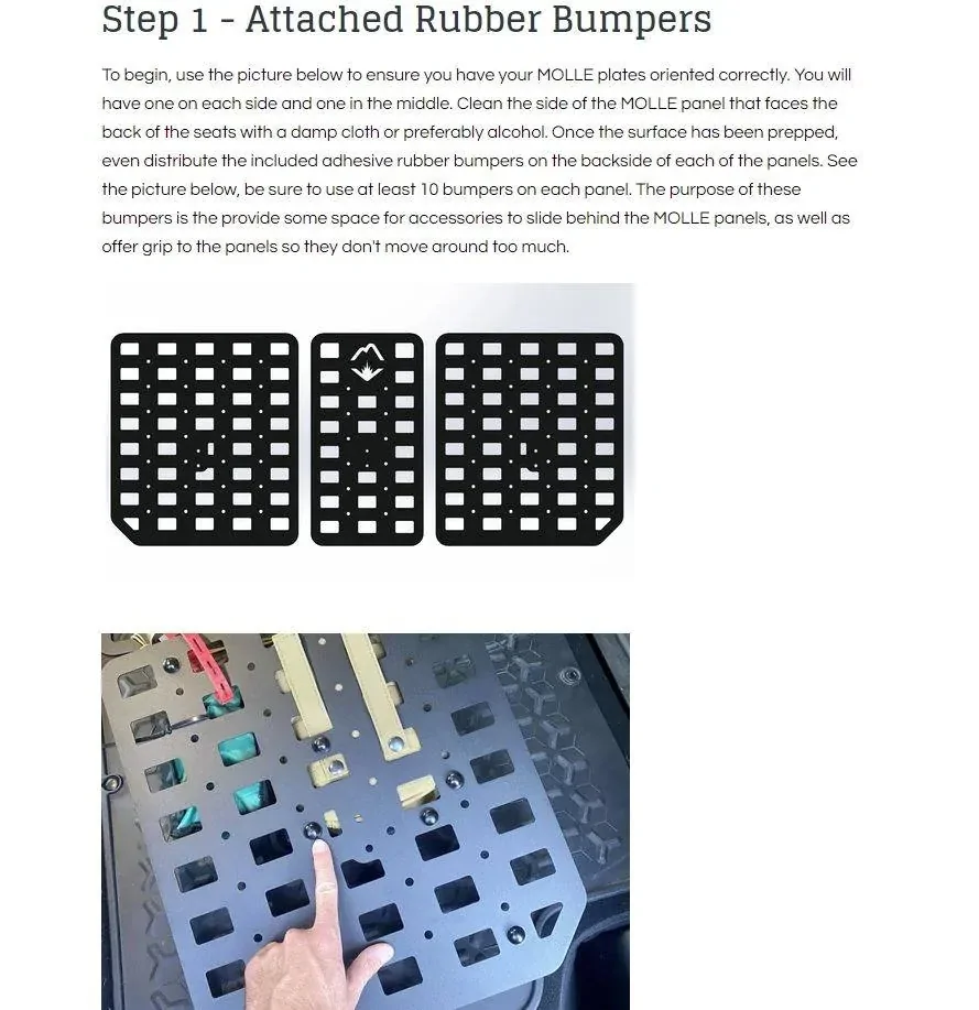

Maybe someone that installed one can provide a better picture, but for the sake of posterity, here is the Yucca information with the best pics their site had:
Ford Bronco Sport Rear seat / trunk grid based mount system Captur
Ford Bronco Sport Rear seat / trunk grid based mount system Capture2
Ford Bronco Sport Rear seat / trunk grid based mount system Capture3
Ford Bronco Sport Rear seat / trunk grid based mount system Capture4

Thank you for this, it's definitely the one I was trying to find. Wouldnt be hard to diy this so may give that a try.
