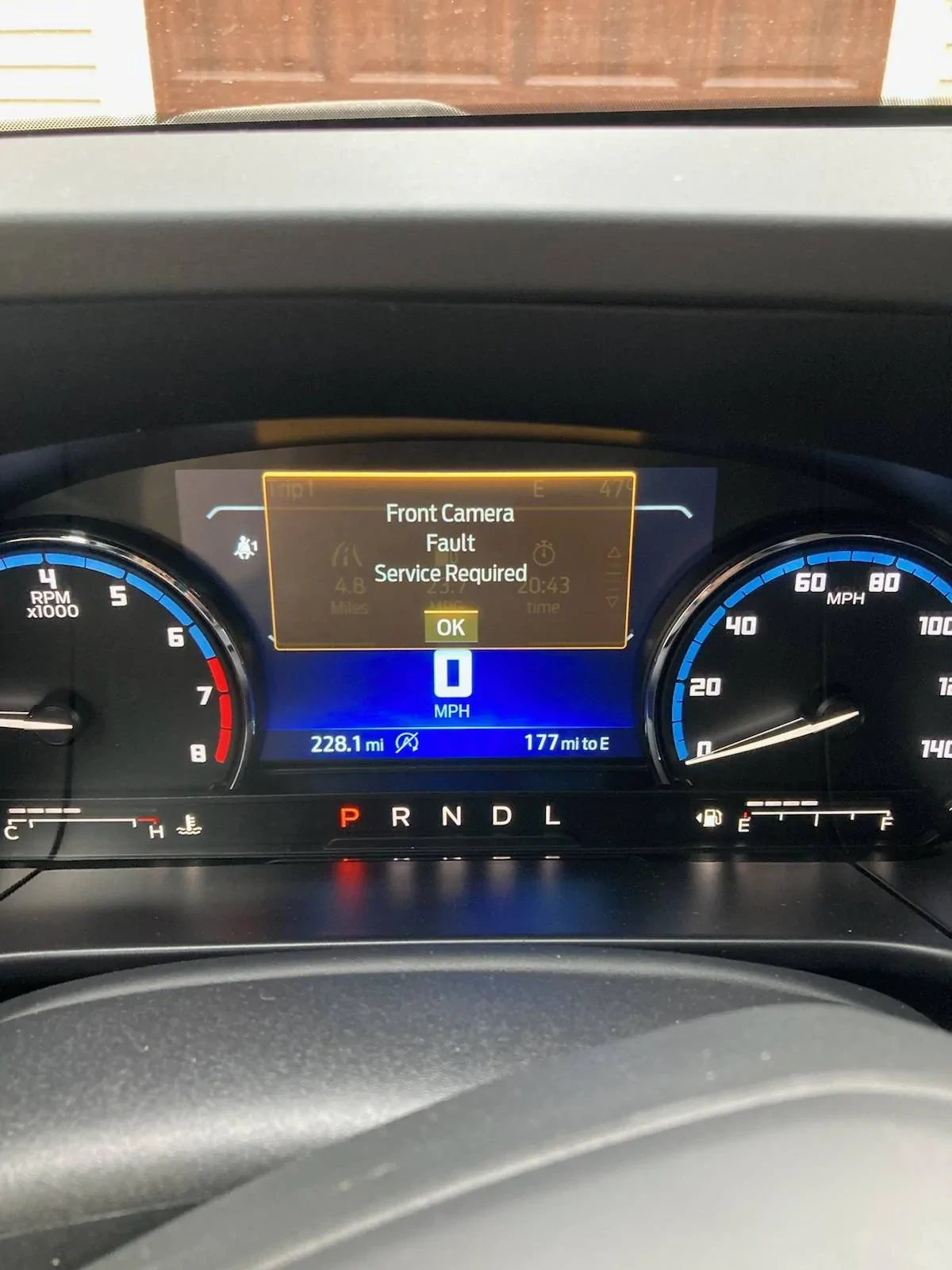

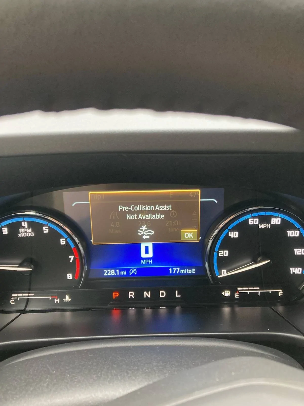

So you think its the back camera, because I looked and I don't have a front sensor. And I don't have the 360 package. So maybe its the back camera thats dirty..
I stand corrected . I cleaned the back camera just to see and no go it still error.

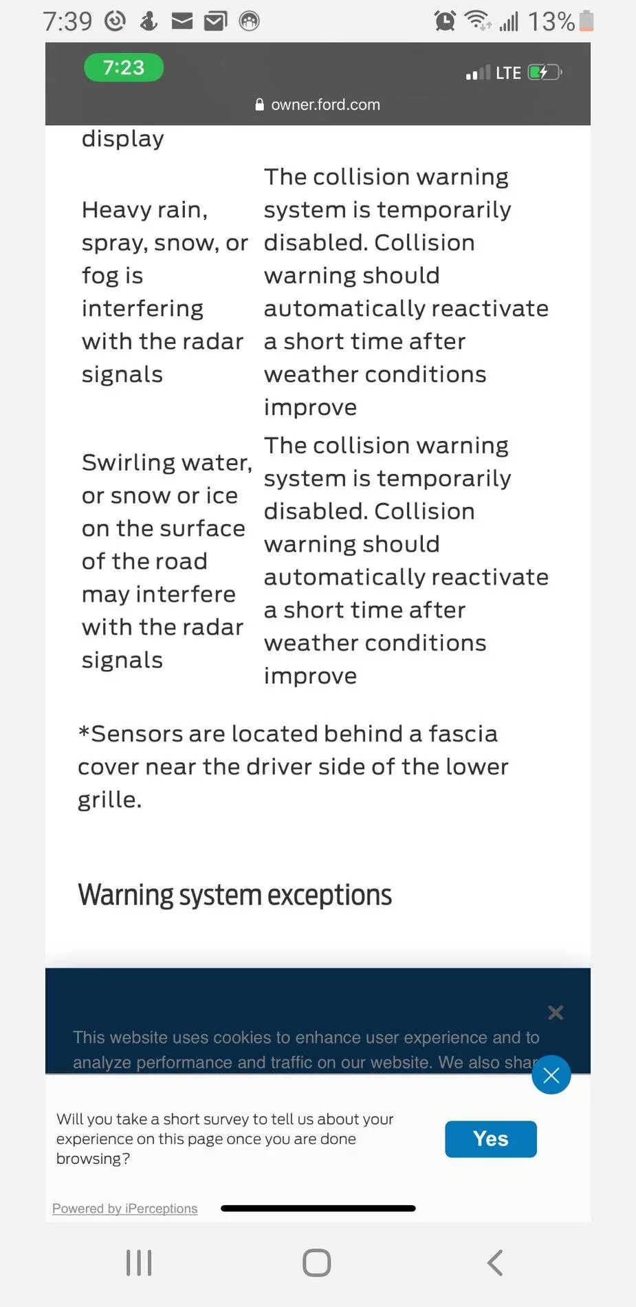

That is actually for the 360+ distance controlled cruise control. My car has pre-collision assist and does not have the square sensor you circled Bc I don’t have the 360+ Assist. I think it’s a combination of the front camera and the sensors within the rear view camera housing. I say the front camera due to the error that was shared, Bc all of the Bronco Sports have the 360 system, but only 2 (Badlands and 1st Edition) have the front camera.

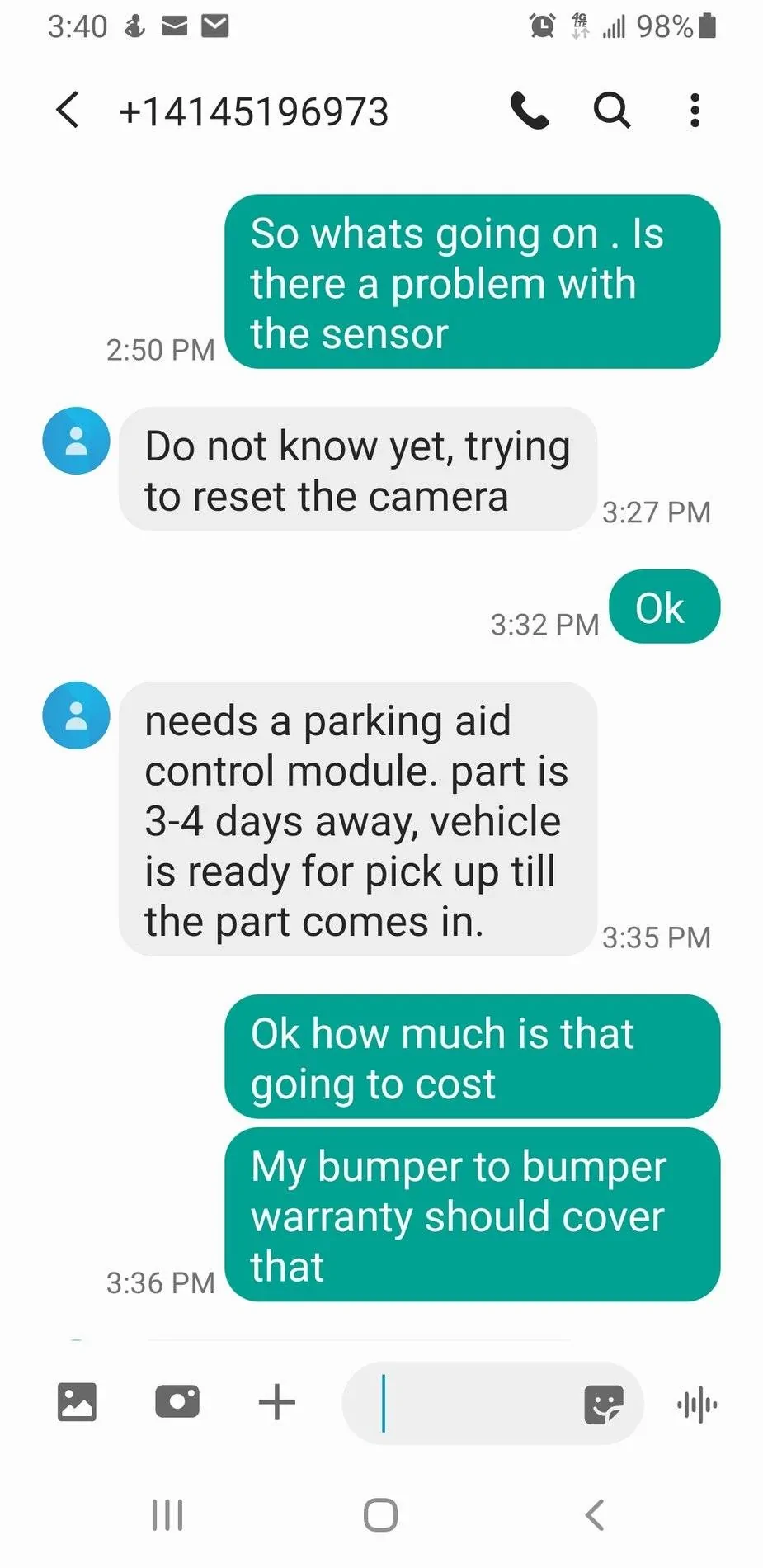

Thx for the info on the windshield chemicals.. Just picked up my sport back from the dealership. They said the warranty will cover it. What is a module That went out so its electrical. Dealership was pretty good to me because I bought my Chevy Silverado from them 6 months ago. Anyway hope this fix my problem will keep everyone updated.

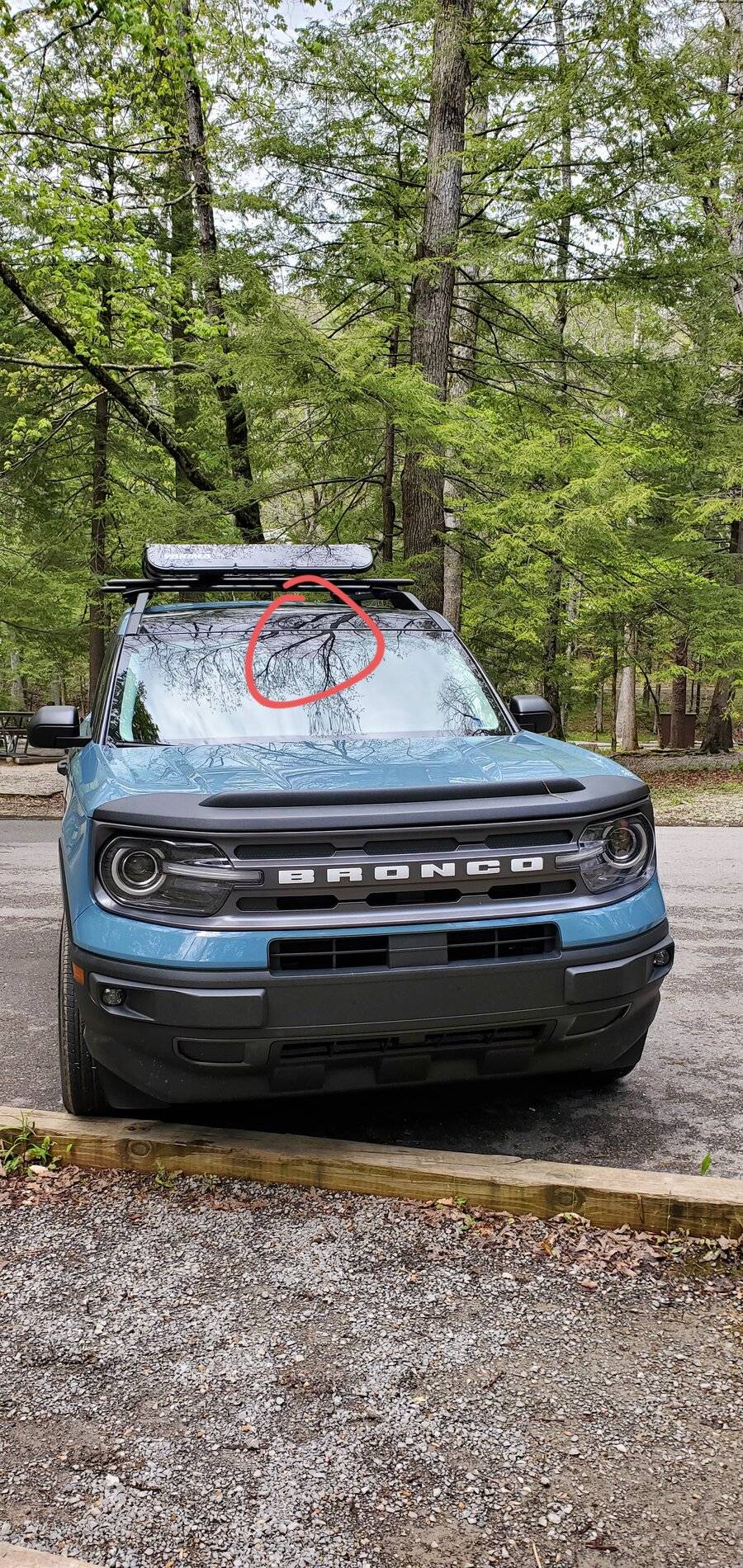

Check the windshield right here...
