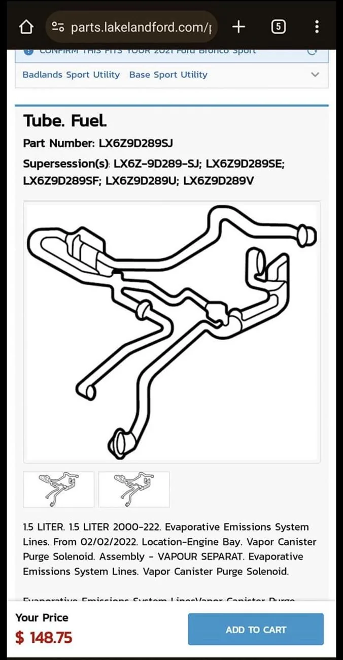

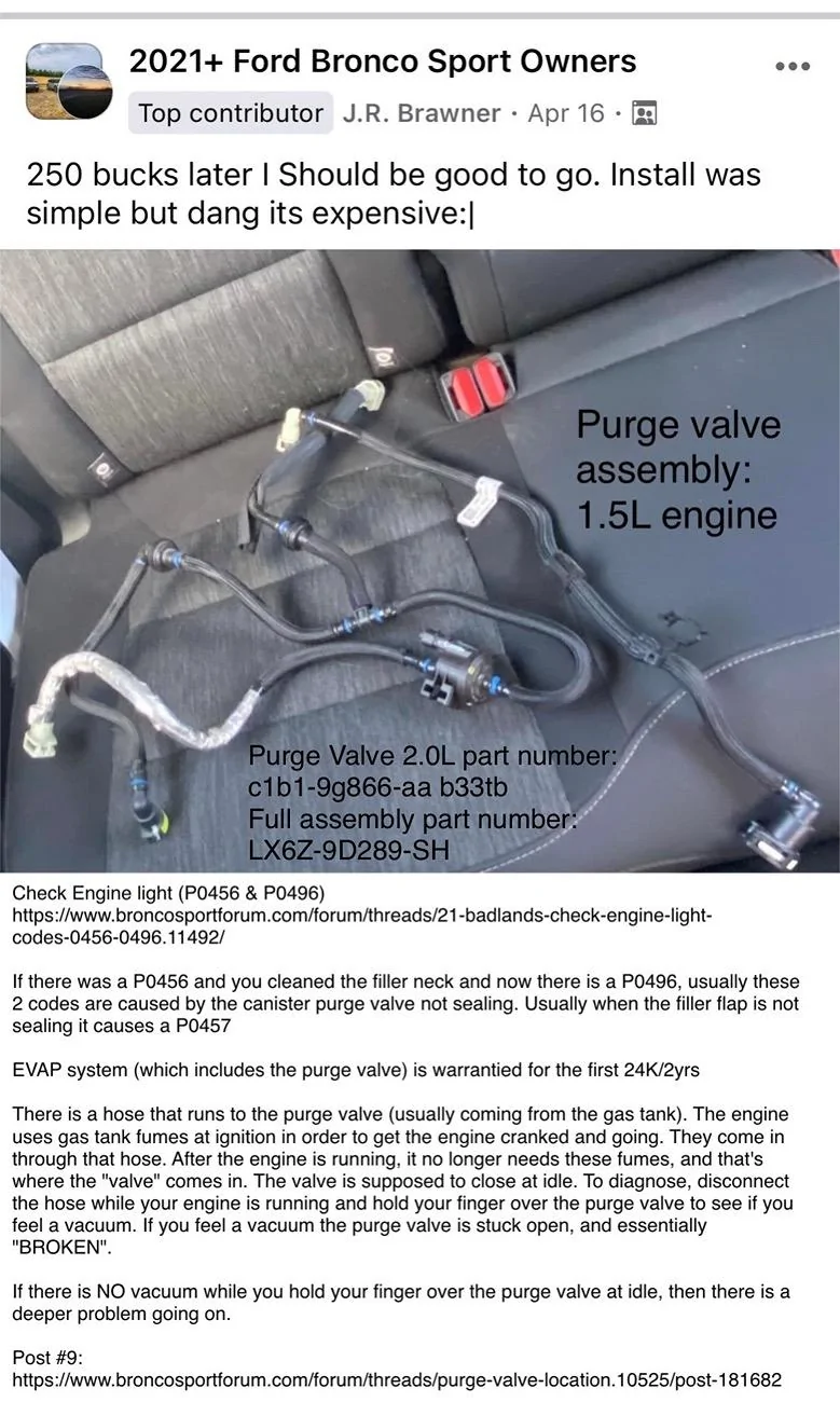

Just as reference for anyone needing to know. This part# for the 2.0 is as stated above LX6Z-9D289-SH. The part# for the 1.5 is LX6Z-9D289-SJ.
I think those part #s are for the full assembly right? As shown in the posted pic:
