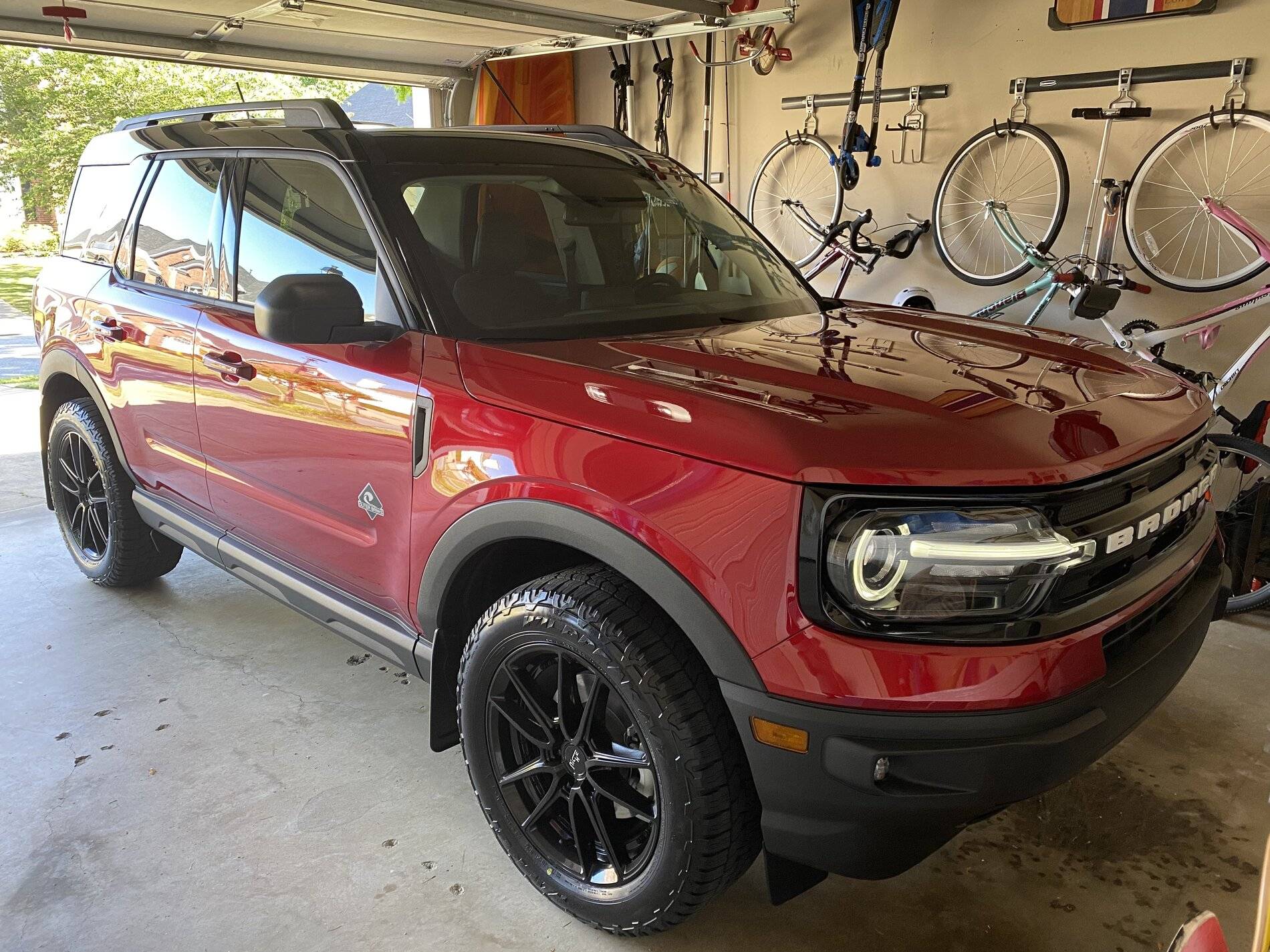

I have the Falken 255/55r18’s on my OB. They fit under the fenders without a lift. Mine are not stock rims, so you’ll have to check the width the rims can handle.
Ford Bronco Sport Outer Banks New Tires? Will 255/55r18 fit? A49E07AA-426B-44F8-BA34-AF23DB395F4A
What rims do you have on it? Do you think you could send a link to them?
