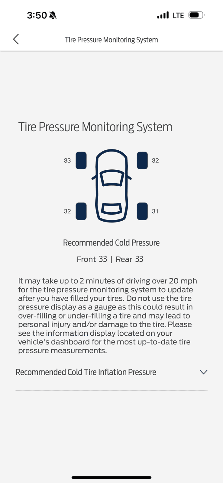

It actually changed to this today. I haven’t measured manually, so not sure if the pressure actually changed or if the app just isn’t that accurate.

Looks like you have the proper inflation on your tires- 33 is the proper cold inflation. I try to have mine matched whenever possible.
