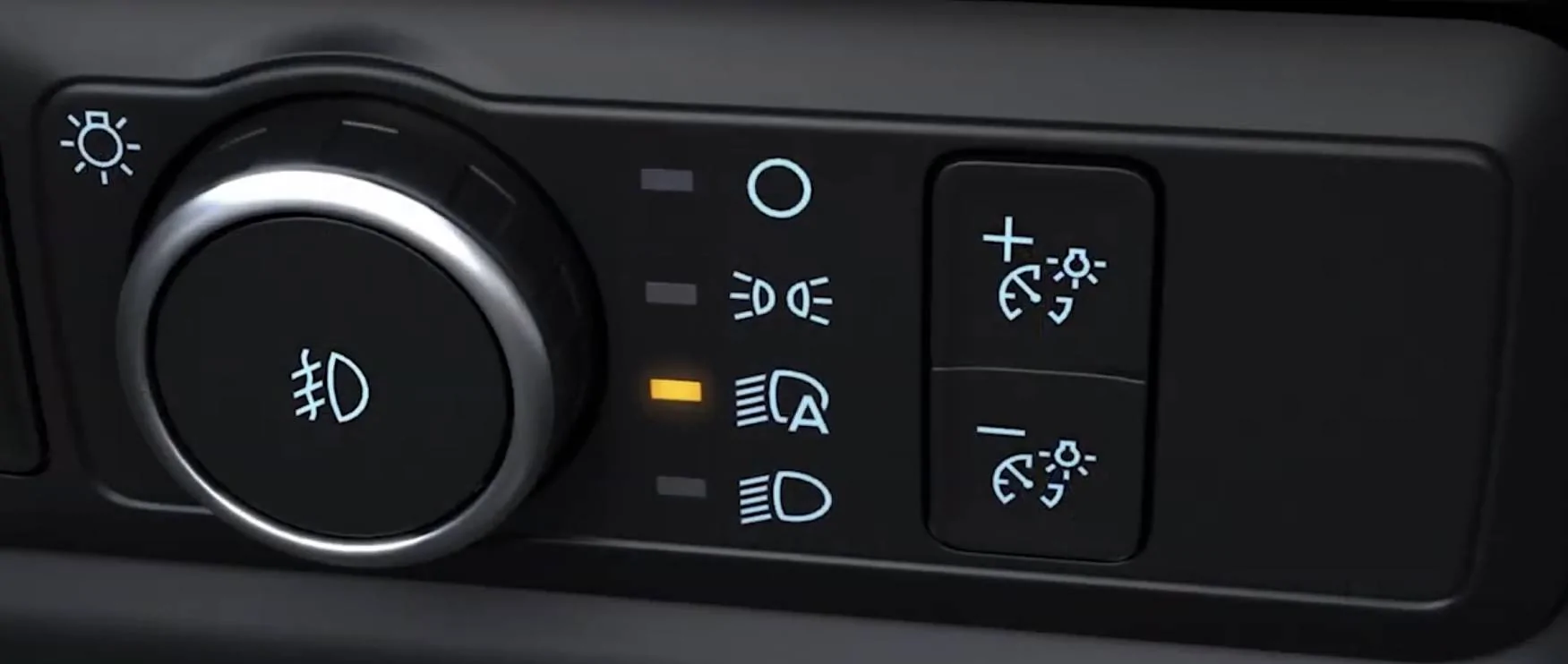

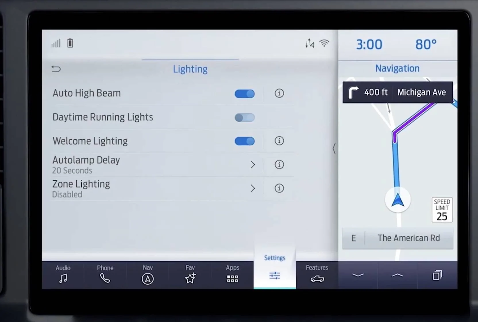

IIRC - DRL’s are the law in Canada. On my Sport they are automatic as long as the lights are turned to Auto. I don’t know how much difference the trim level makes, but here are a couple of pictures of places to check..
Ford Bronco Sport No daytime running lights 162EF1F1-85E9-4A5D-A9E4-89AFEB855472
Ford Bronco Sport No daytime running lights F3D73197-58F3-4175-8FF1-857543F7FDBE
If this slide is in the off position, as pictured, you’ll need to change it to On.

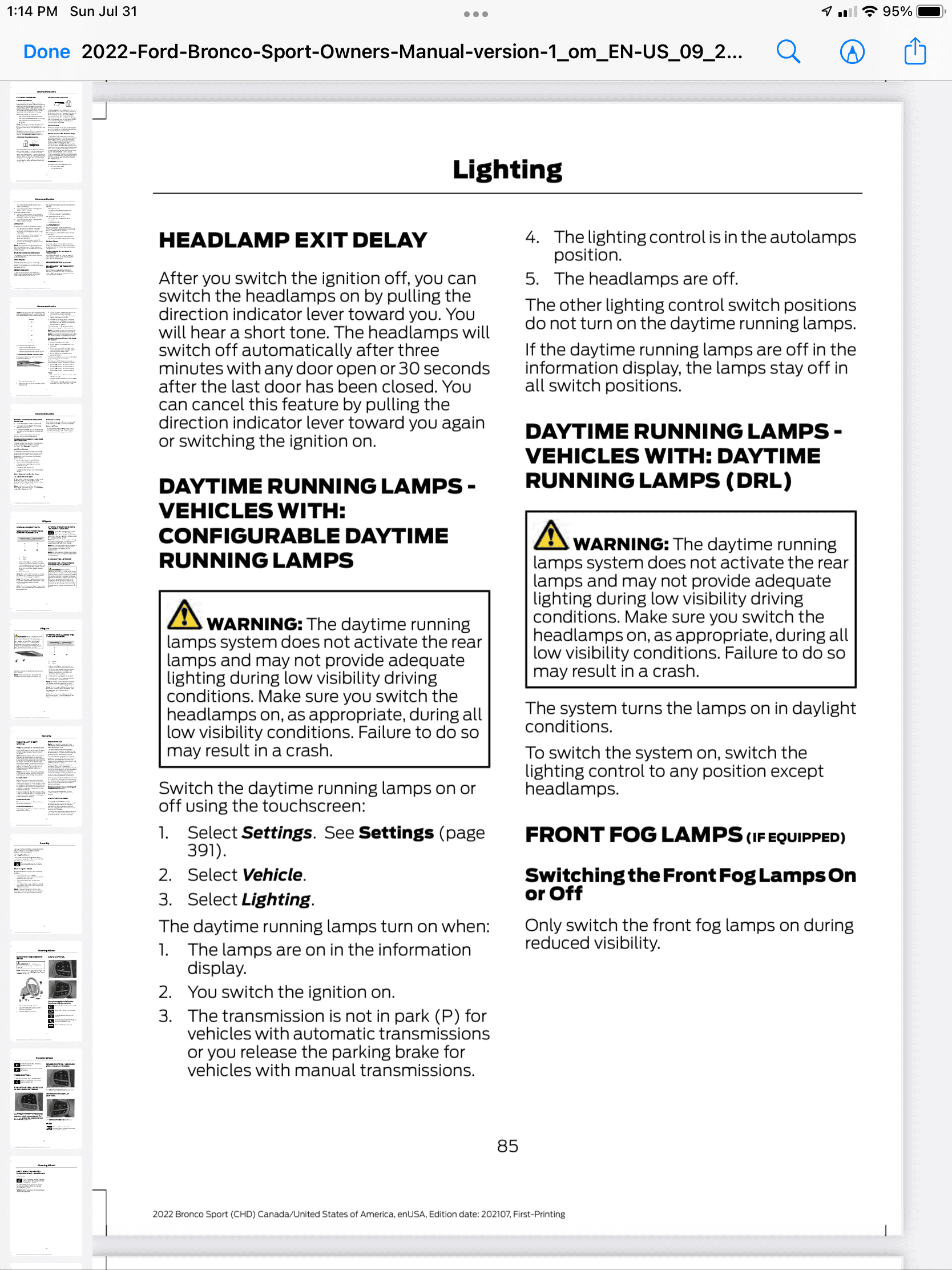

Thanks for the help. I don't think the DRL slide is on the Canadian version as I was on that screen. I think they are working when I looked at it. Not sure what she's talking about. Just said that her escape was different. They may not work while in park as the manual states so I guess I'll have to drive around in circles to show her they work. Either that or it's time to put her in a senior home. Lol
Feint
Jon
Jun 21, 2022
135
224
Chicago
2022 Badlands
Lol. Yeah they don't work when in park.

The owners manual has the answer's.
Better yet, if you have Ford Pass, the owners manual is accessible from their as well, and what makes it even better, it's searchable.
I just typed "day time running lights" in the search bar, and like magic the answer was displayed.
