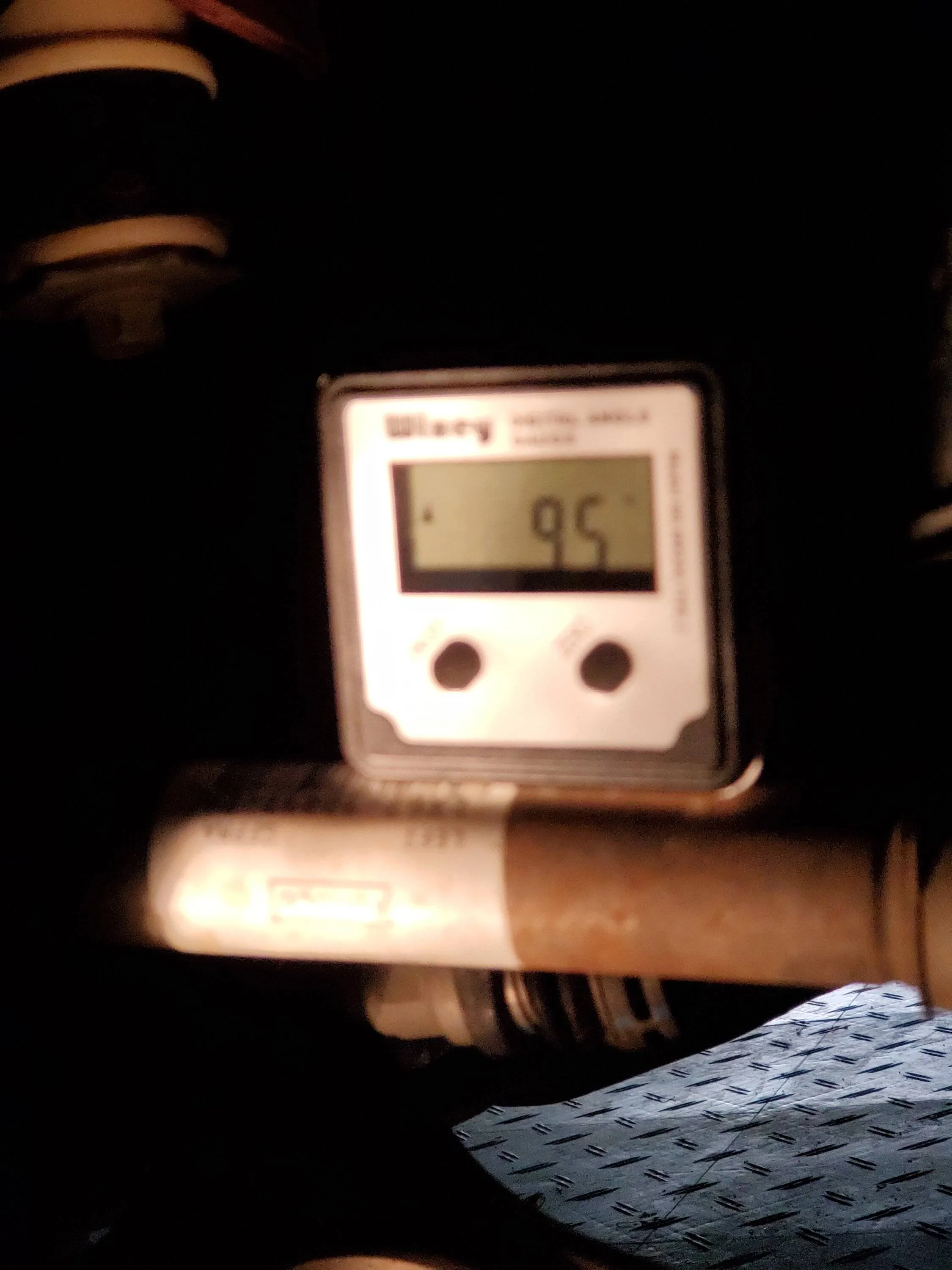

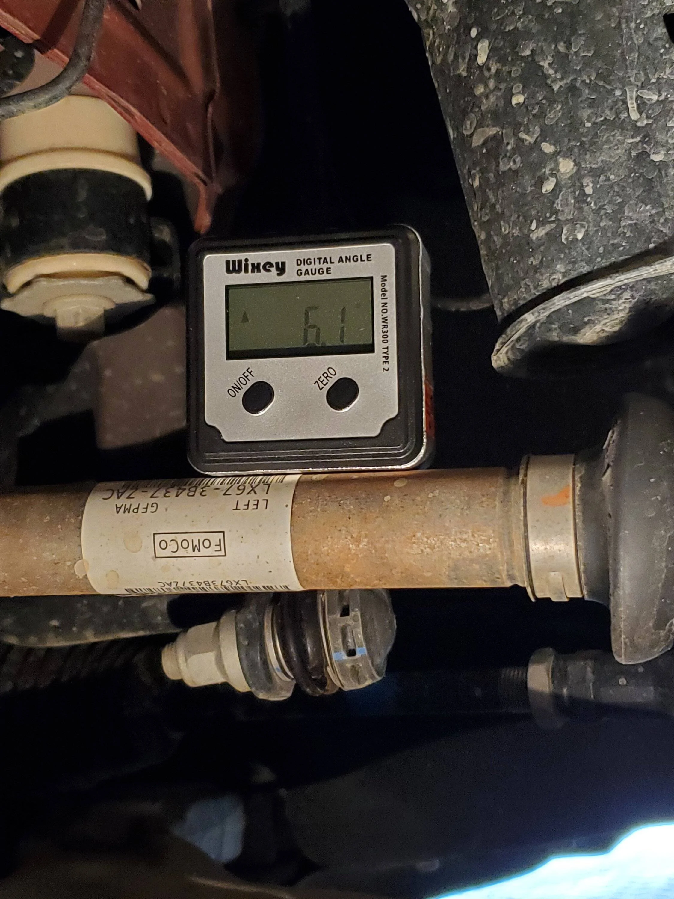

I was curious what the stock cv joint angle is on my front and rear cv drive shafts, and I used my digital angle finder to see what they are. The front is at 6.1⁰ and the rear is at 1.3⁰. I then jacked up my front end to see what angle it would be at with a 1.25" lift kit, and it is at 9.5⁰.
I contacted HRG offroad, and Ben was kind enough to measure his bronco sport badlands with a 2.5" lift kit installed, and the picture he sent me is right at 15⁰. So, it appears that a 2.5" or less lift kit will not cause any premature wear on the cv joints. As always there are numerous other factors that cause cv joint, suspension, and steering component wear. I am impressed with the customer service at HRG off road, and I'll be buying my lift kit from them.

I have the hrg lift installed on mine. The 1.5ā€ on my badlands. My CVs are good. I checked after it was lifted. Static and at full droop and was ok. I wouldn’t go over 2ā€ at max even with drop spacers. That’s another thread lol. But the CVs are good. Just check them occasionally like with any lifted. The ribs on my CV boots don’t rub on themselves either. You’re more than ok.
