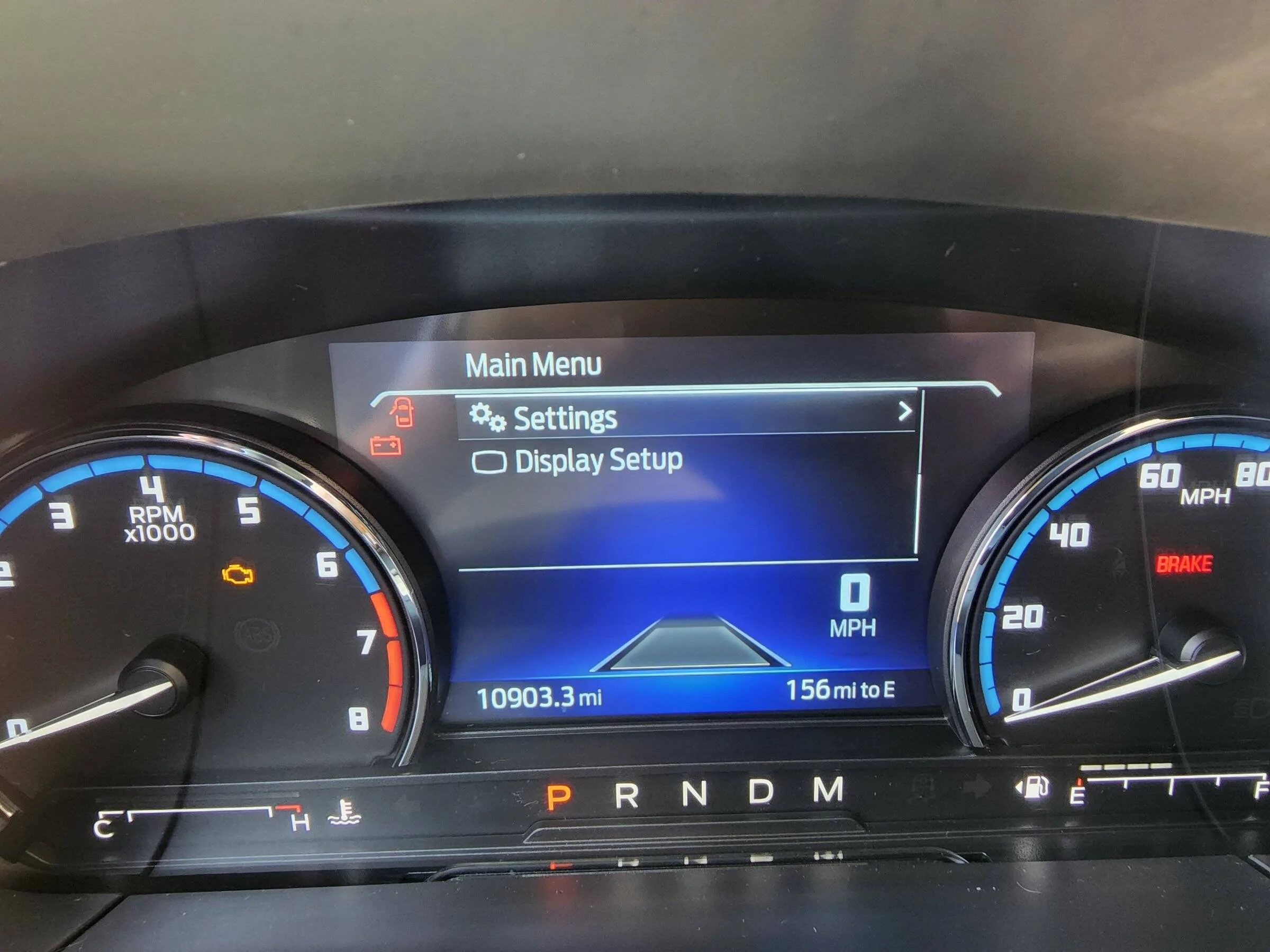

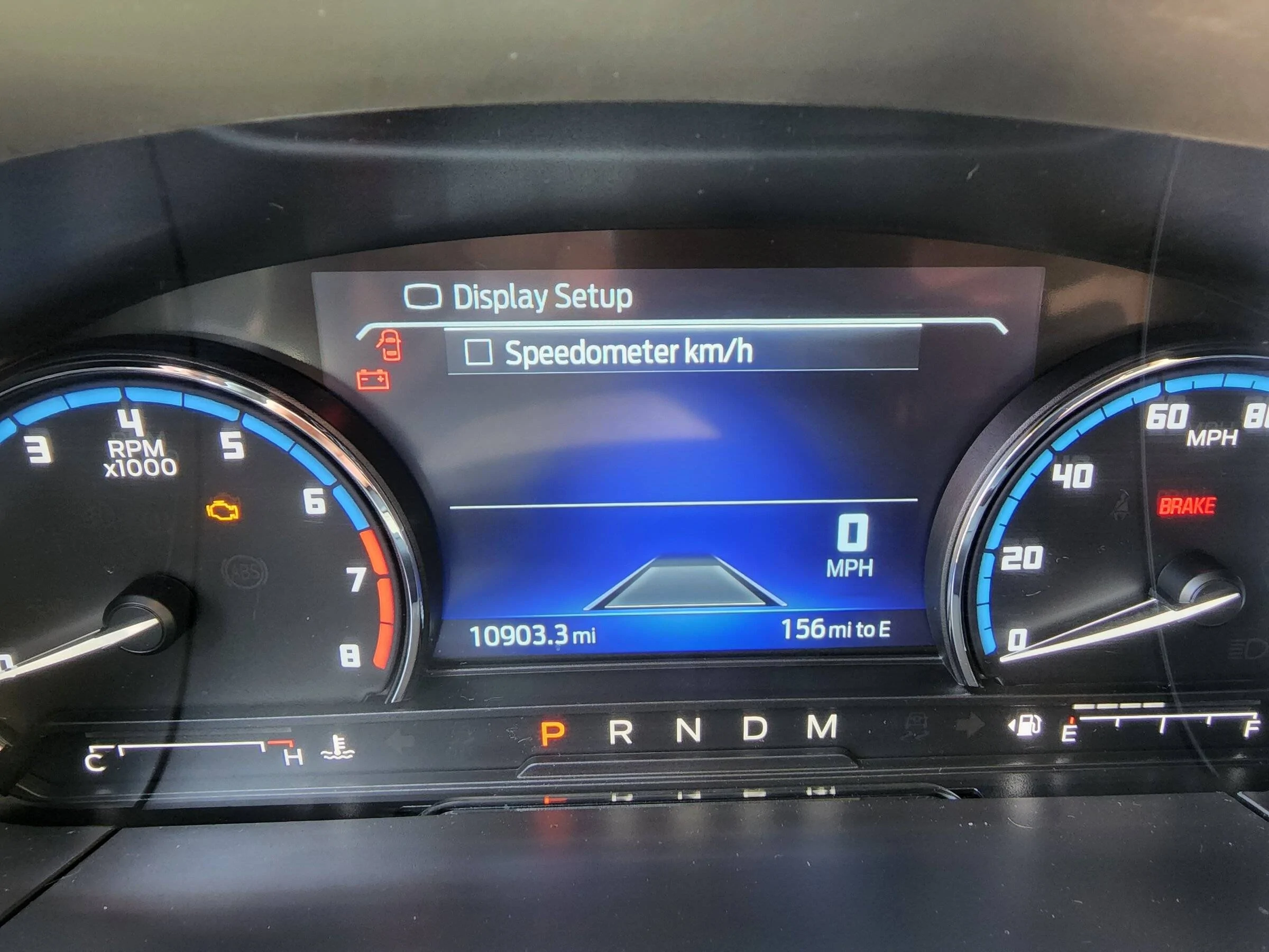

So I noticed about a month ago that I was missing most of my instrument cluster menus. I still have the trip summary screen (shows miles, mpg, and time), the fuel economy screen, the music/now playing screen, and my TPMS screen. Everything else is missing. Below are pictures showing what my settings menu looks like.
I had used FORScan to disable the double honk when exiting the vehicle and increase my tire circumference. I also tried to disable my DRLs turning off with the turn signal a while back but it didn't take. I've since reset to factory defaults by loading the backups I made when I first hooked up to the car but I'm still missing menus.
Anyone have any thoughts?

Make sure the engine is running, I noticed not all settings show unless it's running.

As noted above I do believe the engine needs to be on before additional menus are given. Based on the pictures provided the engine is off and in accessory mode. This is the same on my f150. Though since you did do a reset, once the engine is on, you may need to go back into your settings to reenable most menus.

Thanks for your suggestions. I see the exact same thing when the engine is on.

Did you ever get an answer to the original question? I had this problem yesterday and found that the other menu items were up. It page scrolls at top and bottom of options instead of line scroll. If it's not scrolling at the top then hold the menu button and up toggle. Now I have all the things and added in the menus I wanted that the salesman blazed past on setup.
Lol I'm a dumbass. This was the solution to my "problem." I guess it's safe for me to correct my tire circumference again! Thanks for the help!
