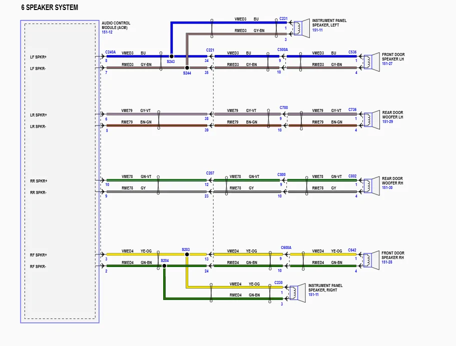

I bought while it was on sale a Kicker 10 in hideaway sub. I am not trying to figure out the easiest way to install it. Where I am going back and forth is either a radio harness or tapping the rear speaker wires. I have a 2025 Outbanks without the B and O radio. Can anyone give me input on how you potentially wired an amp in your Outbanks? I am trying to do this with minimal work and minimal permanent changes to the car......

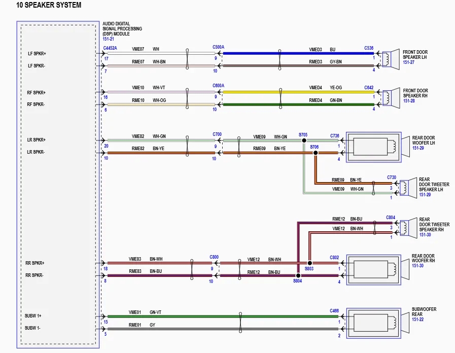

I have not done it in our BS, but I added an amp/subs to my B&O powered F150. I tapped into the factory sub to get the signal and use an LC2i to eliminate the bass roll-off at higher volumes. I am not sure if the bass roll-off is an issue on these, but you can get a used LC2i on ebay for cheap if needed.
Sub wires are green/gray according to the wiring diagram if you was to grab the signal from the DSP.

I appreciate all the input but I do not have the B and O system. So gotta find a way to this in under this config.

I misread the OP. I thought you said you did have the B&O. Below is the one for the 6 speaker one. Everything is powered by the ACM in your case, so easiest (IMO) would be to tap into the rear door speakers. Those are referenced as woofers, so it should give you the signal you want.

car is a lease so I’ve been avoiding permanent changes, but I think this is what I am going to end up doing……
