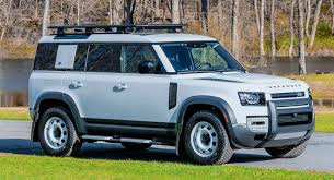

Are you looking at the white wheels with circular holes around the perimeter?
Ford offers that wheel for Sport, people call them steelies, except it comes in a dark Grey color.
