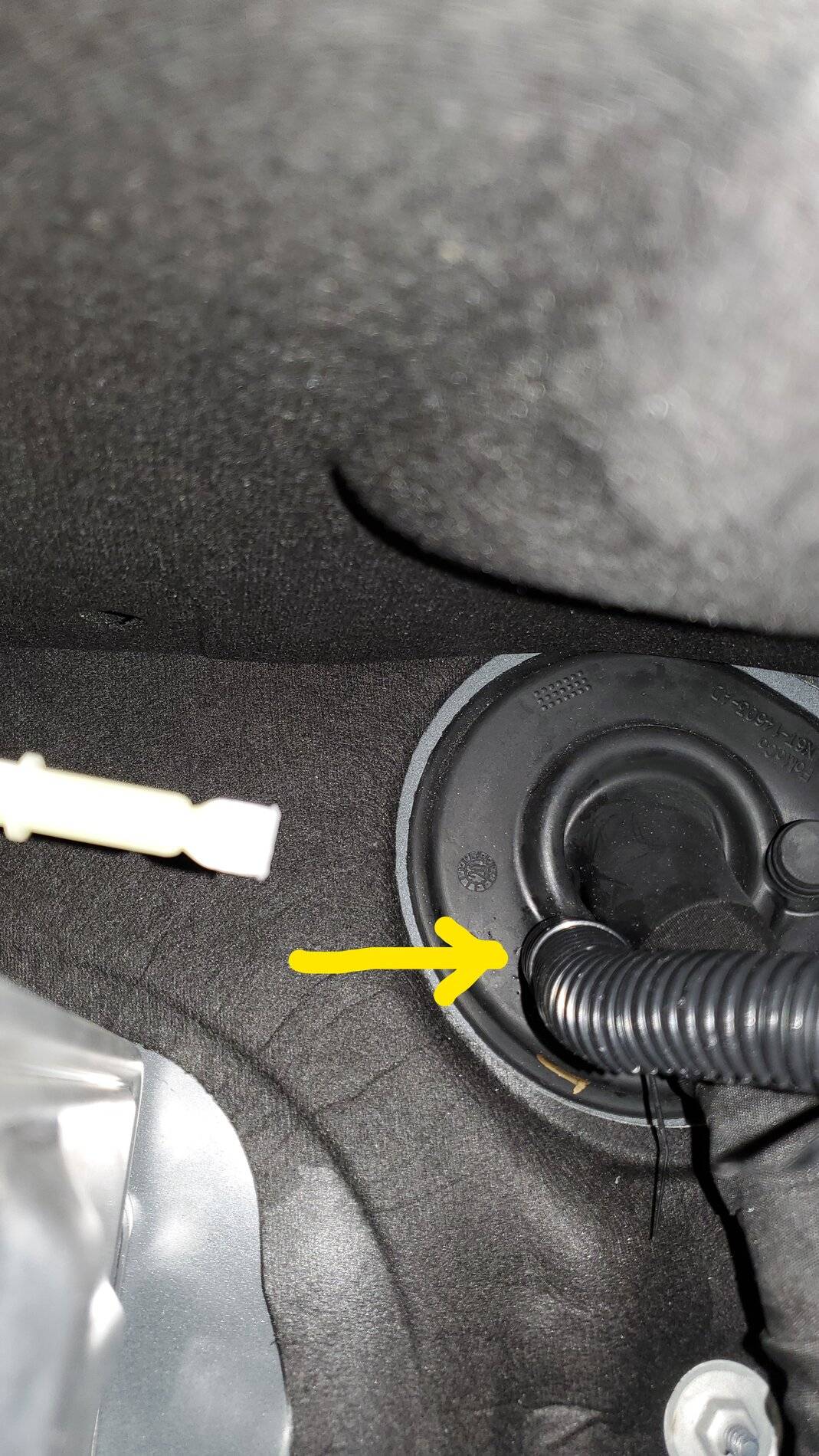

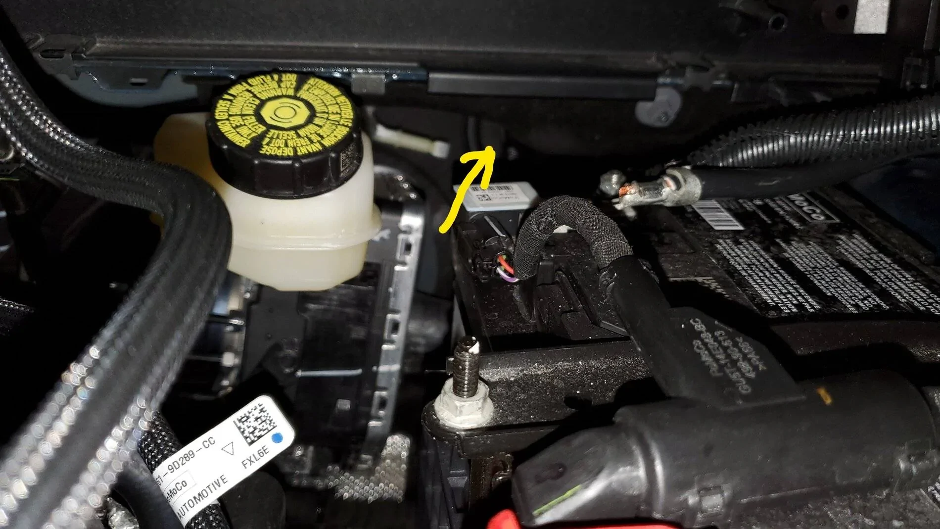

So after balancing my options I decided on going through a grommet instead of drilling a new hole for adding wires through the firewall. I ended up using the grommet directly behind the battery.
Ford Bronco Sport Firewall Penetration - for power lead, antenna, cable, etc from under the dash to the engine compartment? Inked20210205_131354[622]_LI
Careful to avoid hitting other wires I punctured the grommet using an aluminum arrow shaft sharpened like a fountain pen. It went through the grommet fairly easily and I then ran a cord through the hollow arrow shaft for pulling wires through. I used dielectric grease to help slide the wires through but dish soap works well too.. So far I've managed to run a pair of 10 gauge wires for a ham radio, a 1/4 inch cable for a 6 gang switch and a couple of smaller gauge wire. I bundled the wires with a split wire sheath and sealed the hole in the grommet with automotive RTV sealant.
Ford Bronco Sport Firewall Penetration - for power lead, antenna, cable, etc from under the dash to the engine compartment? Inked20210205_131237[619]_LI
So far so good. No smoke, flames or error codes.

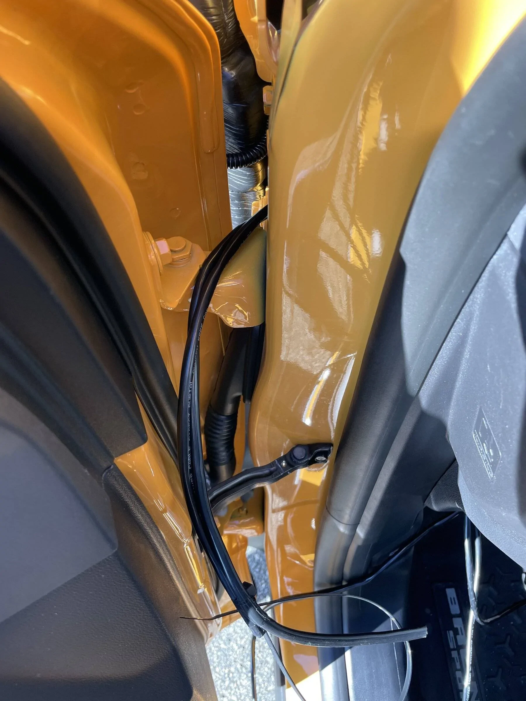

There’s a round grommet on drivers side door which has easy access, it pops right out.
I used a couple of long zip ties to fish my wires through. The hole under the dash is about 2” lower than the opening where the grommet is so it takes a bit of fiddling to push it through. I just cut a small hole in the grommet to push my wiring through. Zip tied the wiring up above pedals etc and you can push wire through behind the heater box easily to get it to the interior fuse box.Some pics attached:
Ford Bronco Sport Firewall Penetration - for power lead, antenna, cable, etc from under the dash to the engine compartment? 4A9B277F-AEC2-4E40-B631-C6AD635A6368

There’s a round grommet on drivers side door which has easy access, it pops right out....
Interesting spot for engine access. Keeps the firewall integrity. I was wondering, though about whether the wiring gets crushed by the door which over time could be damaged and short or it's compromising the seal from the outside environment. I live in a place where if it's not raining and we see a really bright object in the sky (not sure what it's called), we all run to underground shelters - it's very scarry (^_^).
