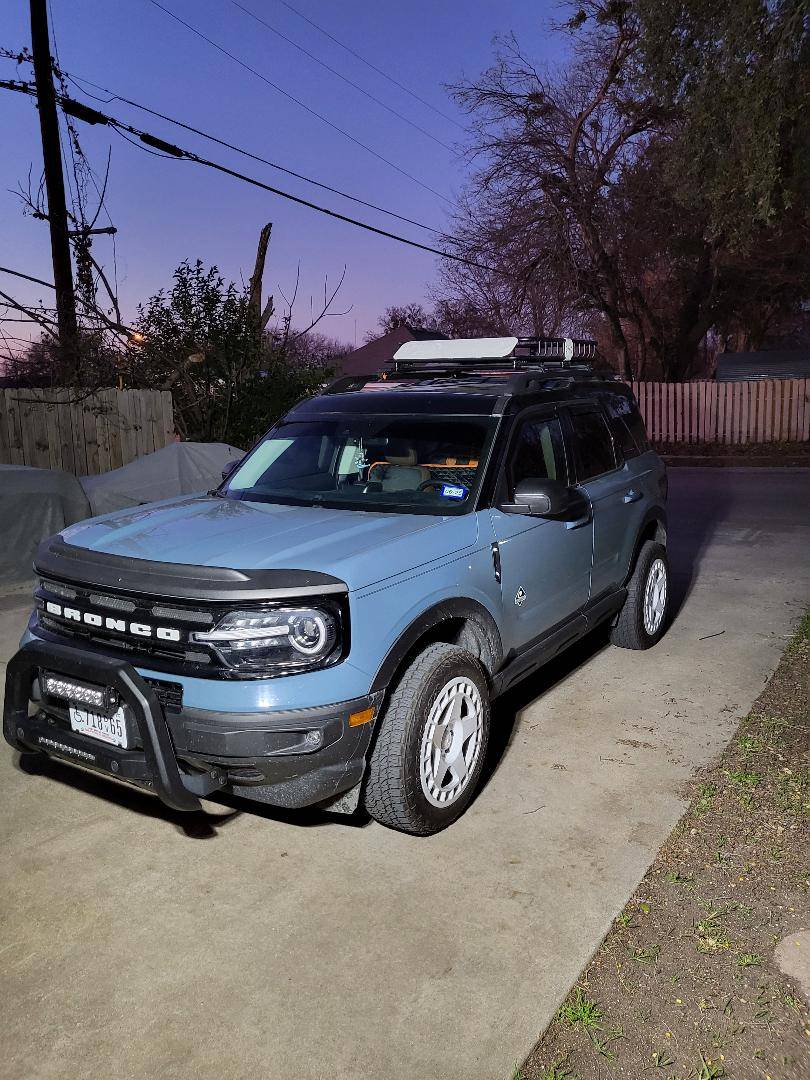

I did the same thing but kept the wheels and tires the OEM sizes
Ford Bronco Sport Does this combo of wheels / tires / lift make sense? brnc
