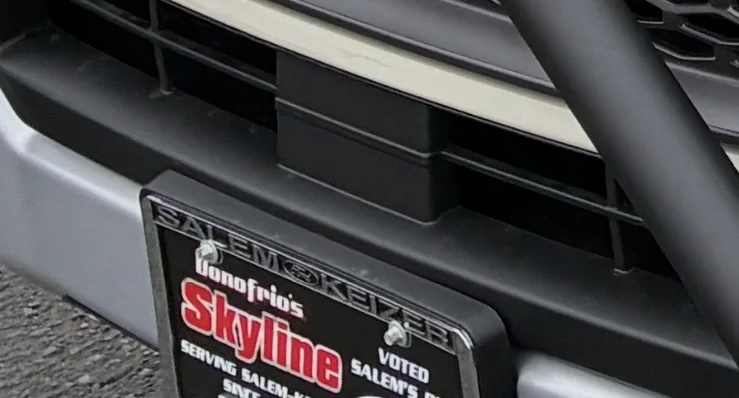

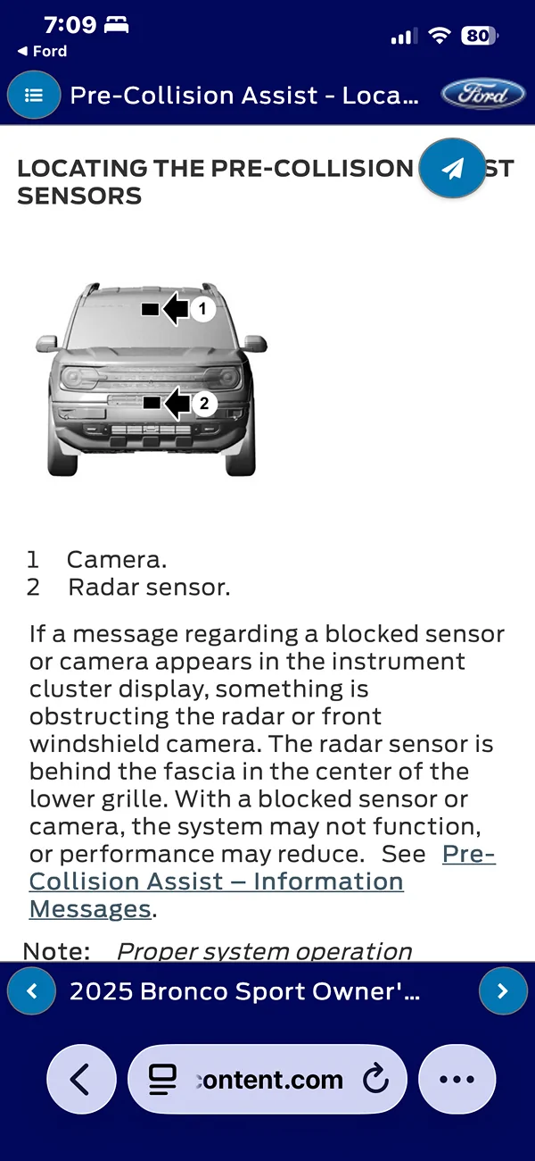

The other morning I was coming back from taking my son to school and clipped a deer. There was no body damage to my Bronco but now I get a warning that my Pre Collision Monitor is blocked and not working. I’ve tried searching for the location of the sensor but cannot find the location. Any suggestions? Thanks
I have the 2024 badlands and I don't know much about mechanic repairs on these, but I do know a little about the sensors located in the back and front that control the probs your indicating. In the front, you'll see a 6in. Wide by 4in high pc of plastic above the front license plate and below the "ON" of the Word BRONCO on front grille. Let's put it this way, if you were to put a metal pc(like a metal decal) with adhesive on the back of it over this pace, all the things you stated will not work and will be indicated on the dashboard as not working, just like mud over it or ice. It shuts down everything. So I believe you have damaged the back sensor and should be fixed pronto. Take it to Ford, check it out for damage repair costs. Let me know, that would be very interesting. Also note if you want to blow a bronco owners mind, attach a metal decal over this area in front and watch what happens. Sorry I have first hand experience with this, and I DID IT TO MYSELF by accident, when I applied a Badlands metal decal on that area. When I drove it the first time after wards, I shit my pants, nothing works it blocks the signal.
