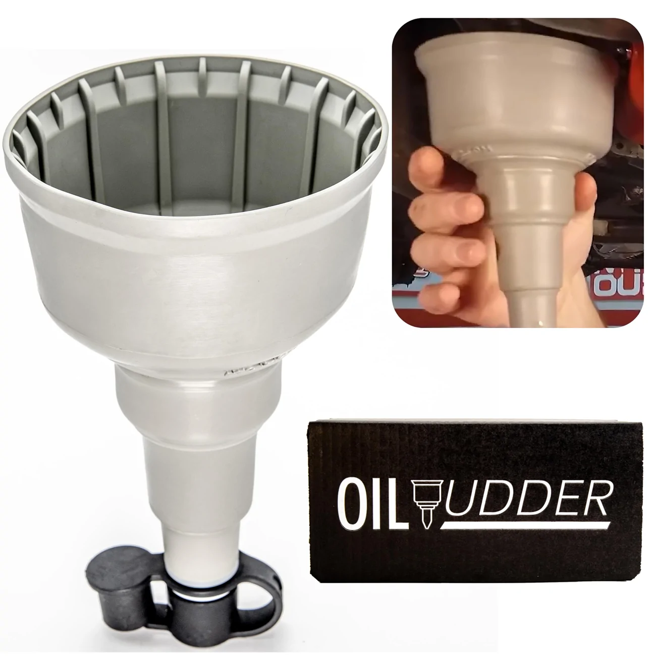

Thanks for the user report. I'm going to stick with my puncture and baggie approach for now. I loosen the filter with the filter tool, punch a couple of holes in it, and let it drain a bit. There will still be oil between the filter and the filter mount, so you can't completely drain the oil. To catch the rest I slide a quart-size baggie around the filter and over the filter mount before spinning the filter off completely. With a bit of care you can catch all the remaining oil remaining in the baggie.This beats using rags to catch drips or sticking something in the way to get runoff.
