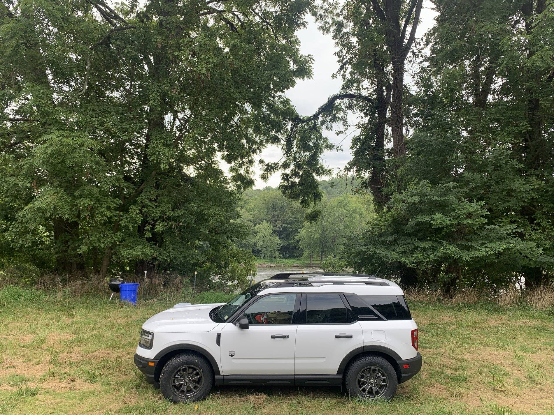

I'm interested in getting some more aggressive looking tires than the stock Continentals that come with the BS Big Bend.
I will be keeping the stock wheels as I like how they look. The two tires choice brands are the Wildpeak A/T Trail or the Open Country A/T III.
So I was set on getting the 235s, but the 245s have me intrigued. I'm thinking about doing 1.5" lift in the next few months.
So do I need a lift if I get the 245s or will I be okay for the time being? I'm not super concerned about my mpg dropping a little bit.
Or can I get the lift and have the 235s?
Thanks for your help!
-Zach

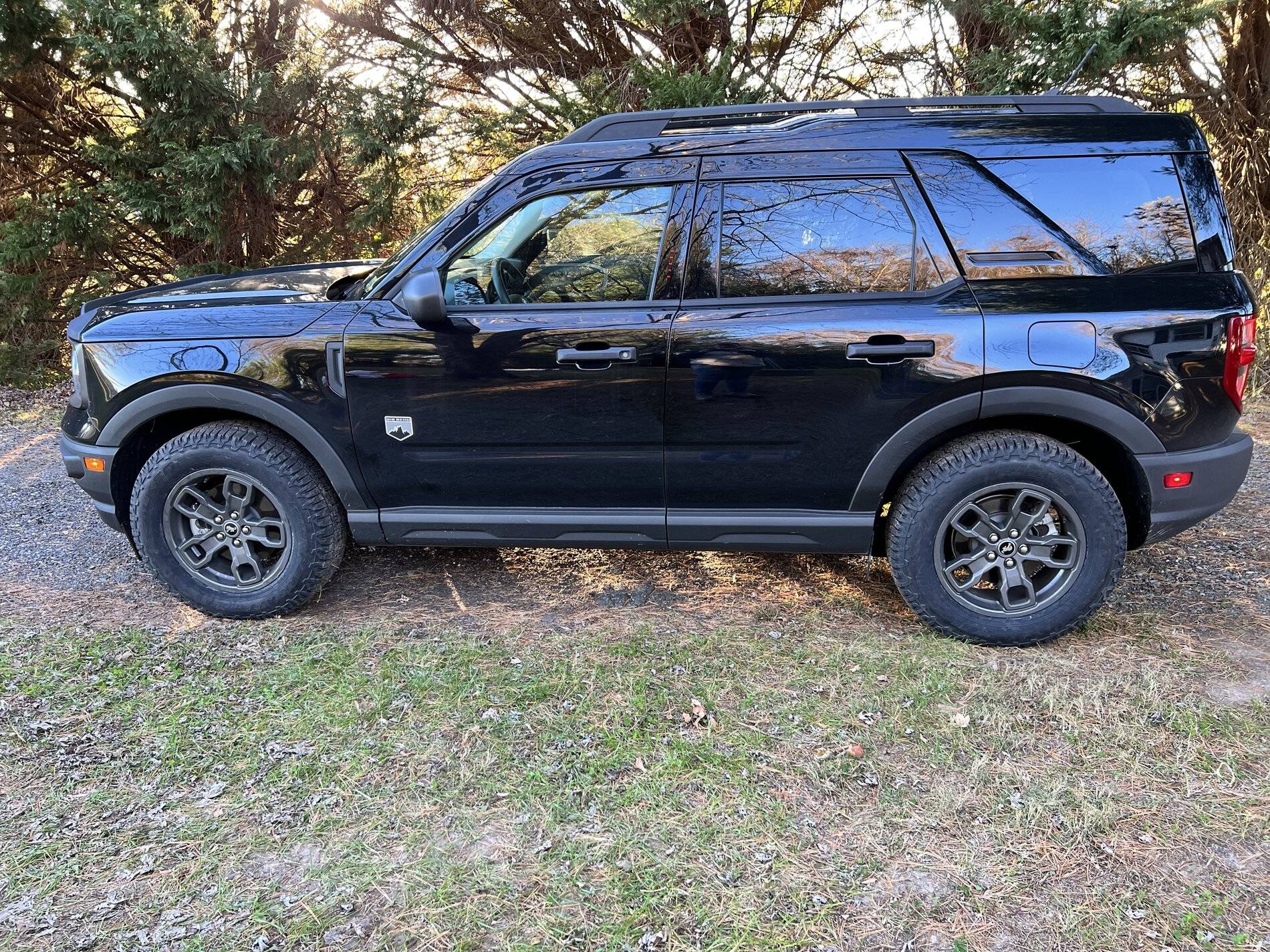

Here's my 245 momo's. They fit great! Where I got the idea Screen shot below Built Right Industries.
Ford Bronco Sport Tire Decisions 235s vs 245s Screenshot_20211201-091546_Chrome
Ford Bronco Sport Tire Decisions 235s vs 245s Screenshot_20211117-201159_Chrom

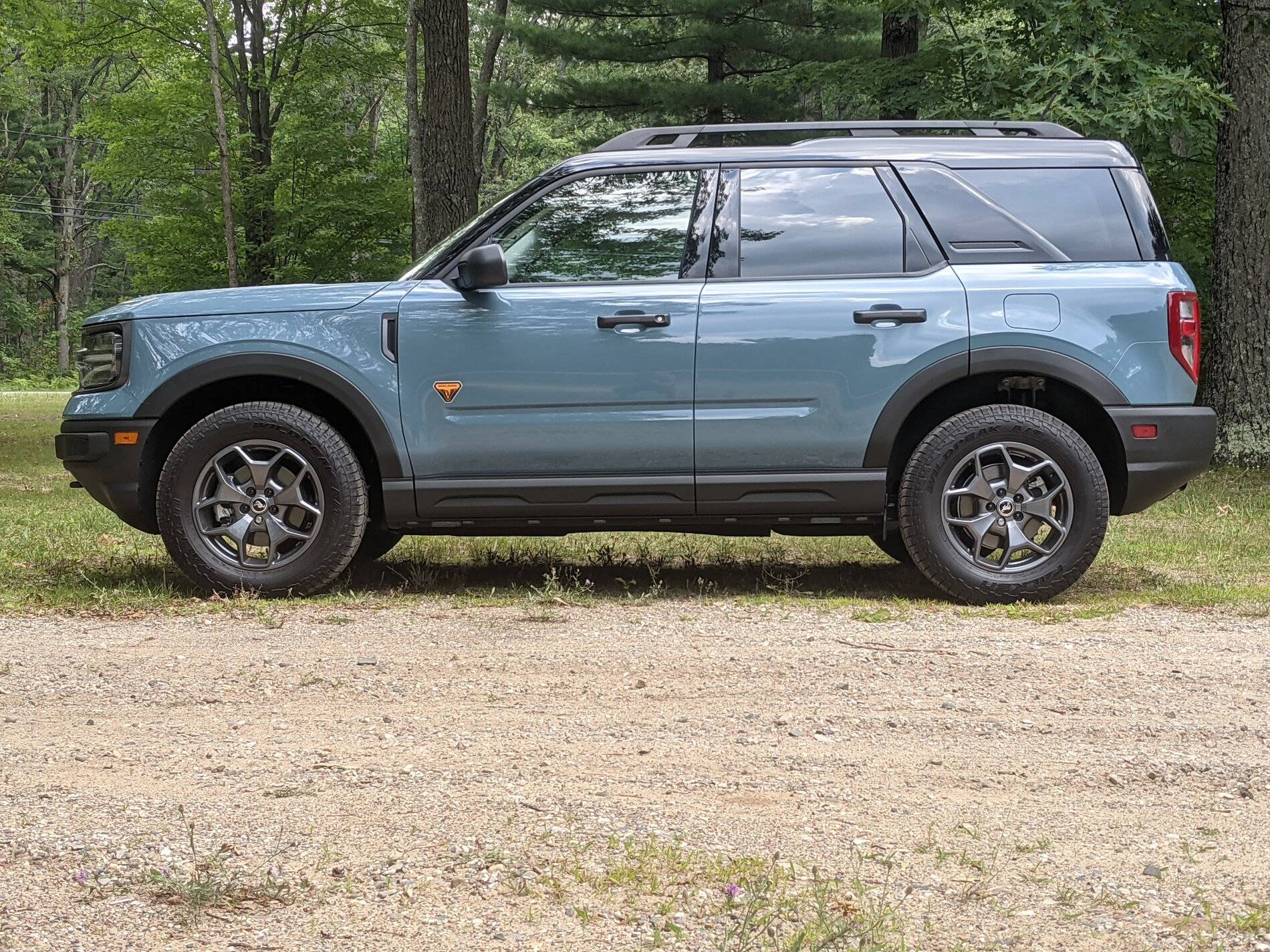

You can do the 245/65r17s without a lift but there have still been a handful of claims that they will rub at full lock on the 3 lower trims (I can't substantiate those claims because there haven't been any pics of the rubbing). On a BL or FE, they fit all day long because of the .75" longer lift springs. 235s will fit all day on any trim. Don't try to go up to 245/70s as those will take some minor pinch weld and plastic trimming to fit, even with a lift.

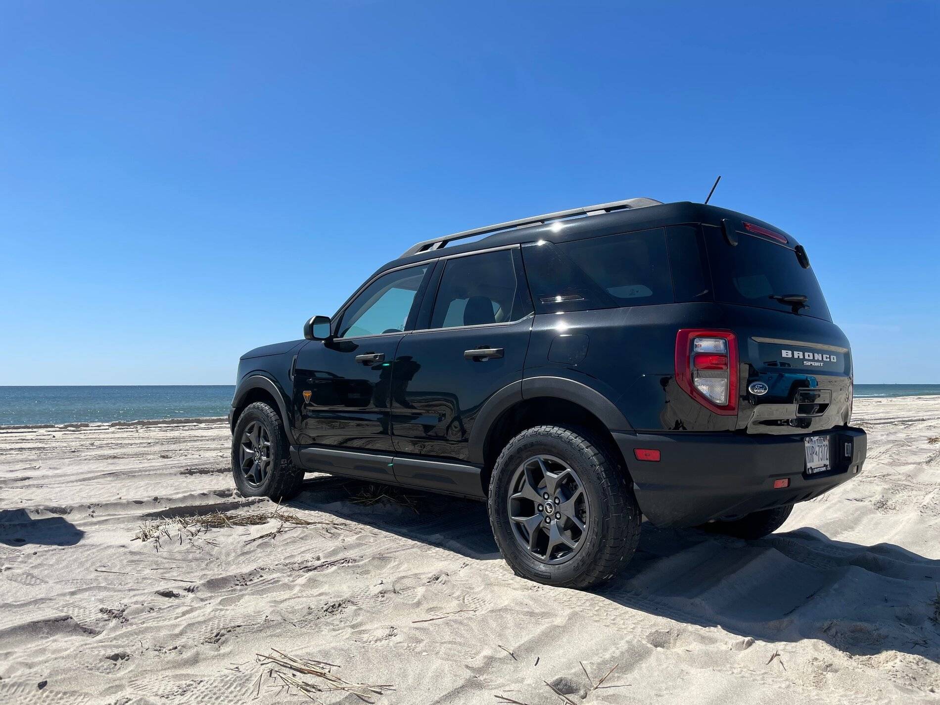

I have 245/65/17 KO2's on my Badlands, no lift. I've never experienced any rubbing, but I've never turned full lock under maximum articulation. Driving forest roads and moderate trails, these tires have worked great for me.
