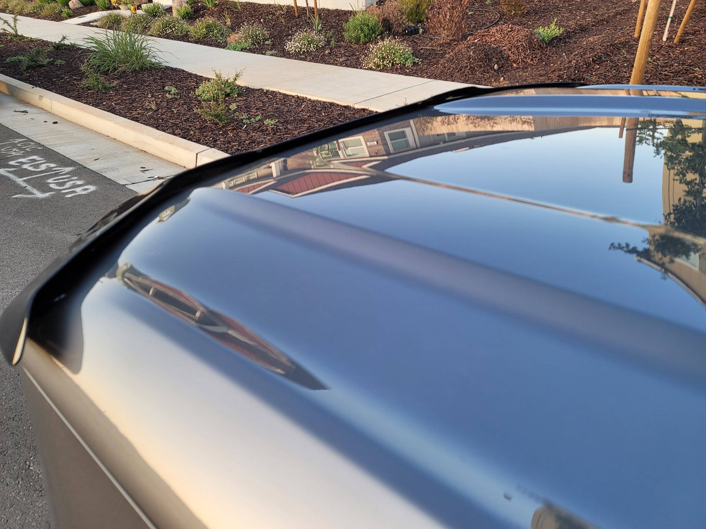

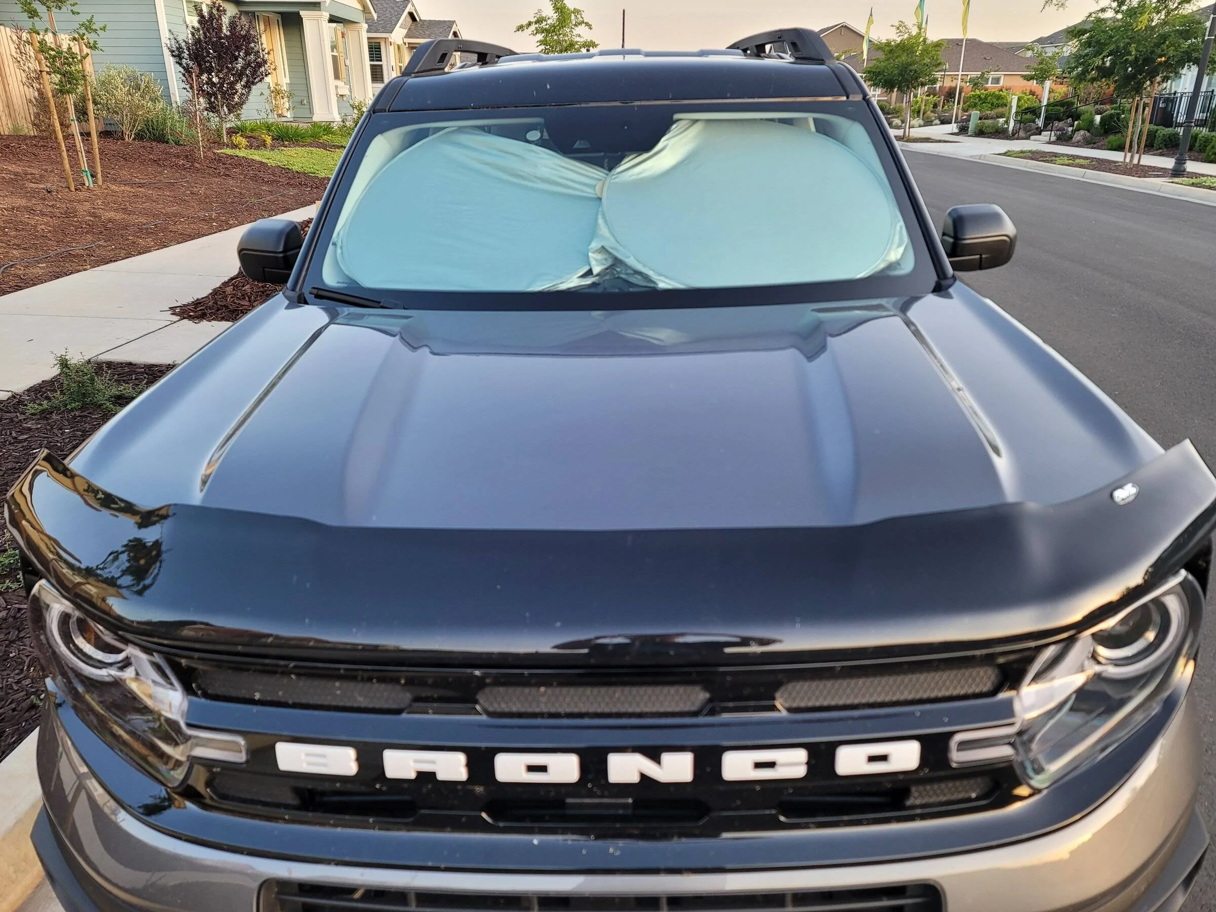

I also have the AVS 2 bug deflector. I was not able to close the hood by pressing down on the hood neither. I raised the hood a good 2 to 3 feet and just let the hood drop close and it worked. I didn't have to adjust the hood bumpers neither.
Ford Bronco Sport Can’t secure hood with new AVS Bug Deflector 20220417_192818
Ford Bronco Sport Can’t secure hood with new AVS Bug Deflector 20220417_192826
