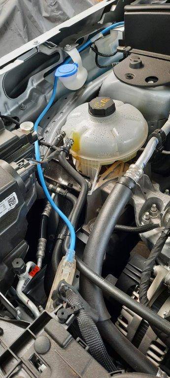

Here's what I have been doing:

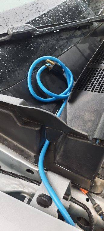

I bought a 6 ft cold weather block heater cord and ran it (loosely) from the heater plug to the passenger side front and through the drain.

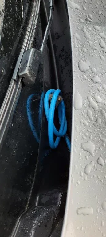

When I am not using it, it is coiled up underneath the tremendous gap under the rear of the hood, passenger side.

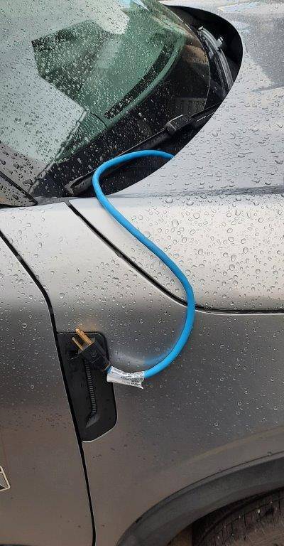

When I need to plug in, I uncoil and put a shammy (not pictured) between the finish and the cord and plug, and plug in the cable from my home outlet.

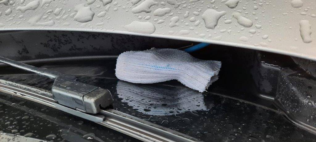

When I am ready to drive, I coil it back up and stuff in an old sock cut in half so there is no chance of anything unravelling...primitive but it works.

Thanks for the tip, Andy
I'll definitely try this. Never thought of going backwards towards the windshield. My mechanic even took off the front grill and could not find an opening to rout the cord. Especially since the grill has moving flaps. I have the Bronco in a garage/shelter ... so not need for the cover. But I'll look for one of these plastic plug covers or a cord that comes with on, to keep the prongs from icing up.
Cheers

I also routed the cord as Andy suggested. The sock is a good idea. My previous car had a much smaller opening for the wipers. And even that would get full of ice that was impossible to remove.
My BS is outside today, getting covered in snow, but I filled the wiper gap with two pieces of bubble wrap about 30 in long, rolled about 3 in in diameter. When it stops snowing I should be able to pull the bubble wrap out and take most of the ice and snow with it.
