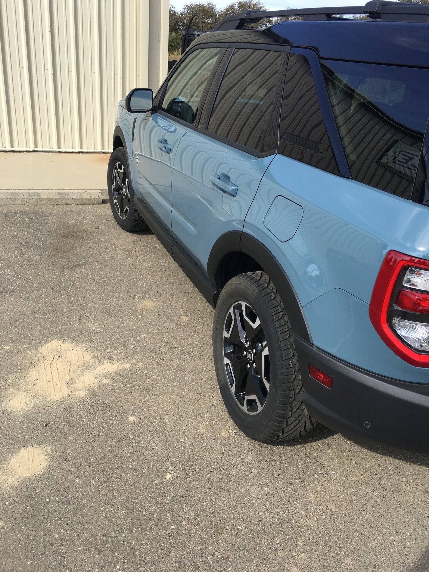

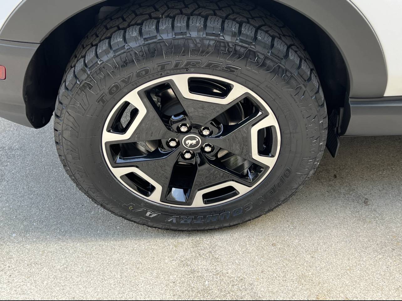

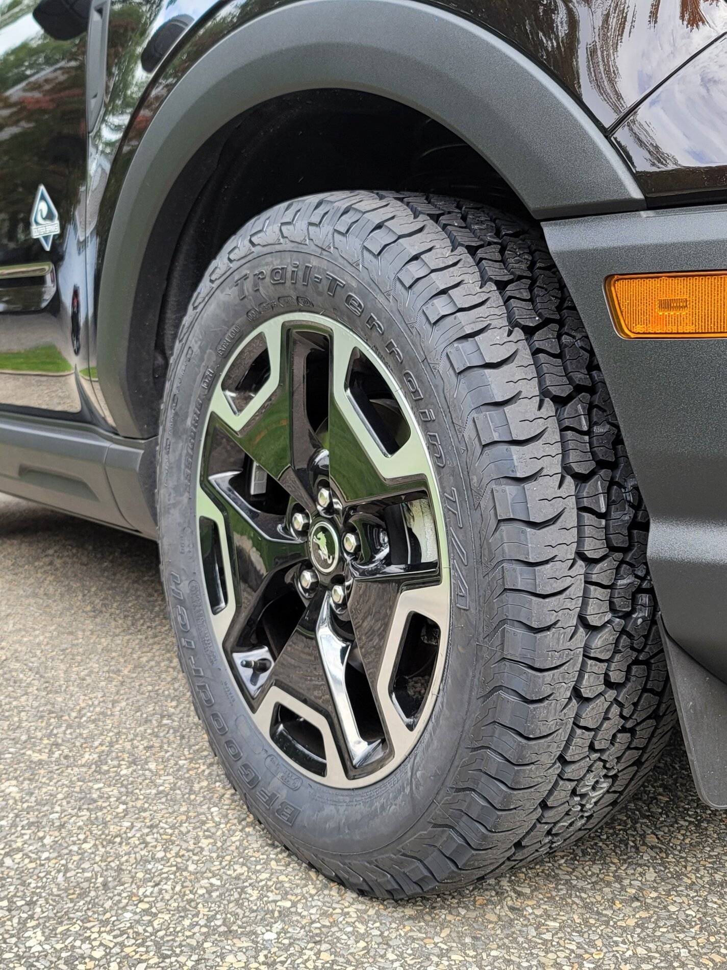

I put Toyo Open County AT3's 235/65/R18 on my Outer Banks with the stock 18" rims. There is no rubbing. I can't compare the Toyo's to the stock tires because I had them put on before I picked up my BS from the dealership. Here are some pictures:
Ford Bronco Sport Bigger Tires for my Outer Banks, keeping the 18's IMG_1333
Ford Bronco Sport Bigger Tires for my Outer Banks, keeping the 18's IMG_1132

Toyos for me as well. I did the same open country AT3 like others. Much better than stock tires. Whatever you decide on, do it. Can't go wrong w Toyos or what others have suggested. Crap pic - need a better one.

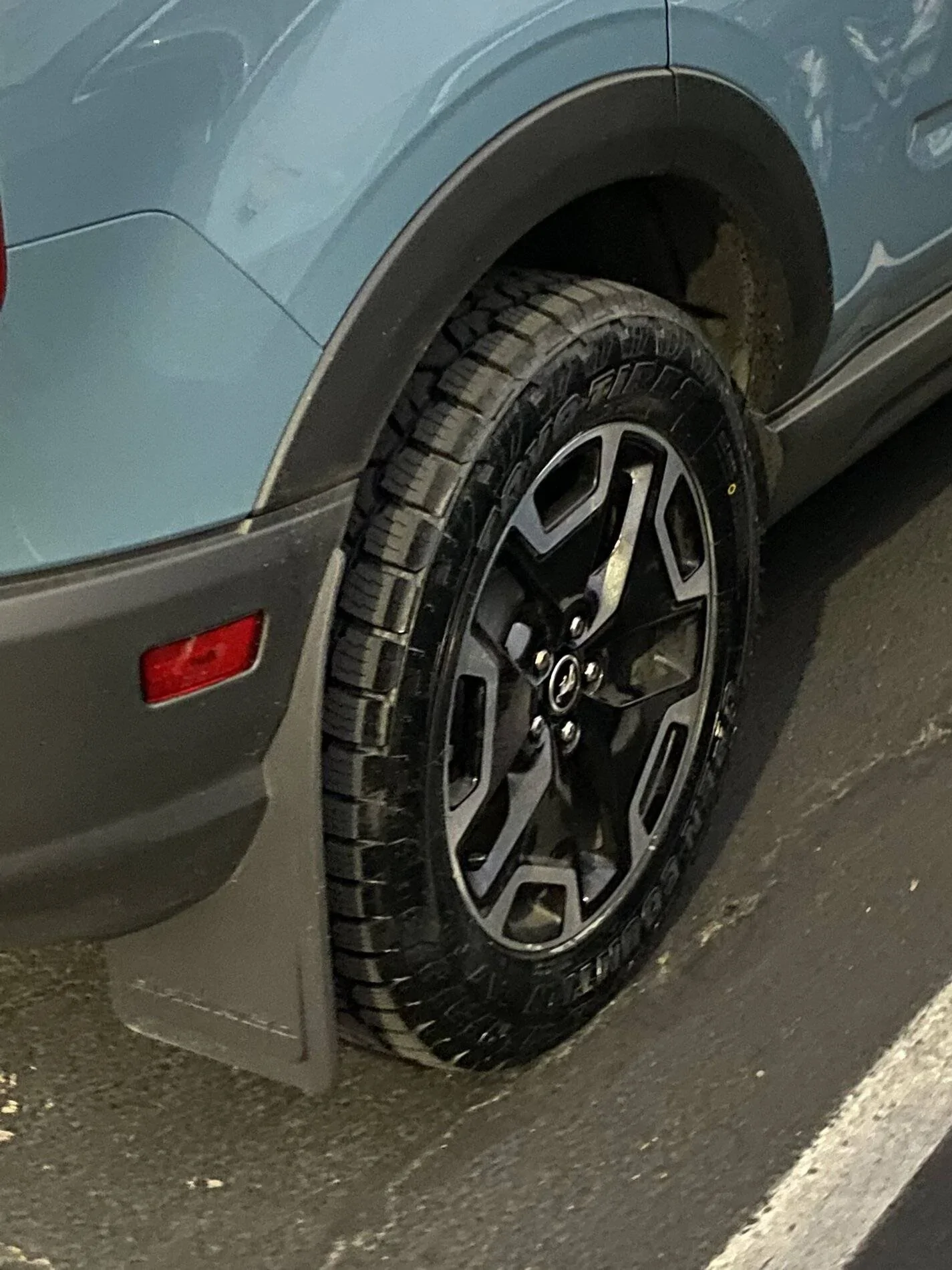

I put the General Grabber UHP 255 / 55 /18 on my Outer Banks. Close fit but plenty of room. I do not have a lift kit on it. I have not had any rubbing when driving on rough roads. You should be good with any tire this size.
Ford Bronco Sport Bigger Tires for my Outer Banks, keeping the 18's CAR3.JPG

I dont think there was really any drop in MPG. I put them not too long after we got it. I have taken plenty of road trips with a lot of weight in the vehicle and its handled great. Feels more planted on the road. Probably not going to do a lift on it anymore since there is zero rubbing and not really a need for it.

Looks like my local tire shop has these in 235/65/18's so I may go with those. The 65 ratio might give me just a bit more height, and I don't think I'll mind the drop in width. Still worlds better than the stocks.
