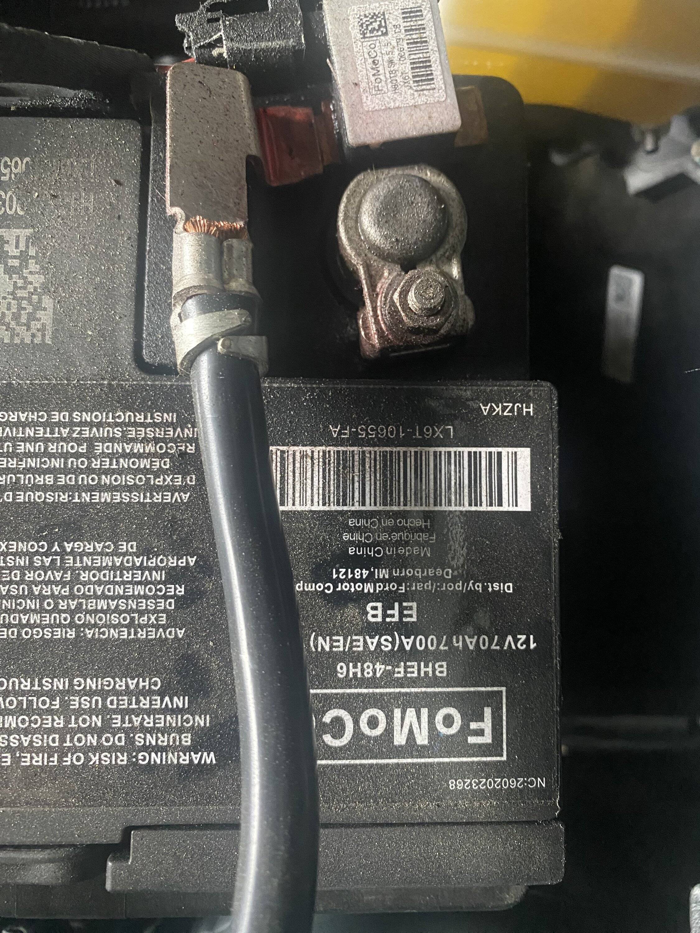

Might be a stupid question but how do you know which battery you have? I hate acronyms. That said does anyone know what AGM stands for?
AGM means absorbent glass mat. EFB is enhanced flooded battery. Usually you'll find either acronym somewhere on the battery label and sometimes it's part of the part number. Cheers!
