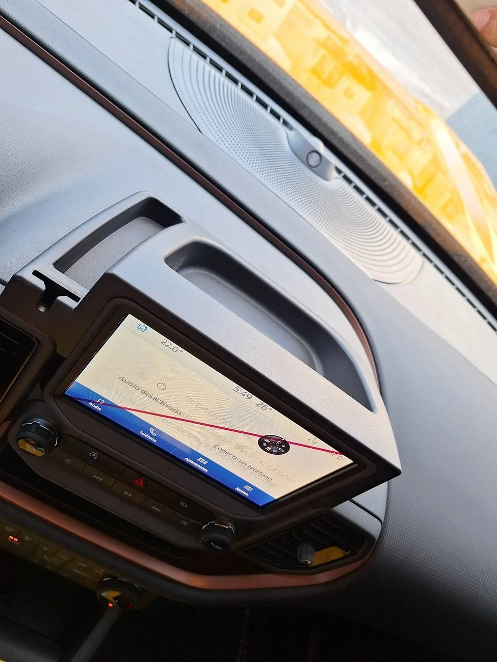

The better sunshade seems to be helping a lot with heat in the Sporty...but when I am out and about the back of the monitor screen gets super hot.
I have a service appointment on Thursday :)
The monitor screen will feel super hot (relatively) but is it still going black and shutting down? That’s the abnormal aspect
Which of the Ford dealerships did you decide to take it to?
It's done it twice before I got the new sunscreen and started covering it with a small cover that was meant for steering wheels.
I'm going to San Tan Ford - they sponsor my Mustang Club and it's where I bought the Sporty.
These vehicles are designed for interior temperatures your vehicle is exposed to
My guess is San Tan will not be able to observe the display to shut off due to heat because it sounds intermittent (they might try it with a heat gun)
If San Tan can observe the issue but states no repairs are needed, ask for an explanation why heat causes the display to shut off
There is no need to cover the display or use a sunscreen except those do help the interior look nicer for much longer

Was San Tan Ford able to diagnose the display issue ?
yes - it was an update issue - and now I have a sunscreen that was made for a steering wheel that I place over the monitor area.
I also am using the heavy duty window sun screen and it helps a lot.
Of course it is 104 plus here now...
Good thing all you needed was the latest Sync 3.4 version
