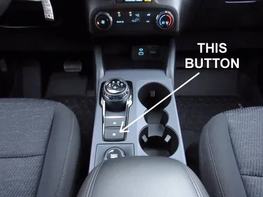

My wife said it started yesterday. Baby bronco shuts off when you come to a stop, when you release the brake it doesn’t kick back on until you hit the gas.
Anyone else?
Headed to Ford Monday morning...

does she have the brake hold turned on? If you have brake hold turned on, it won't restart until you hit the gas because you are "braked" still
Good to know! So easy to accidentally hit that flat button. Especially when you have a dog in the Sport. ?
