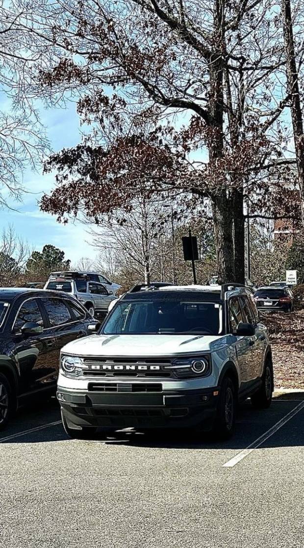

Hi everyone! I have a BB BS and the dealership I got it from has a lifetime power train warranty attached to my car. I really want to lift it.
Has anyone lifted their BS and it hasn’t voided warranty? Not sure if this is a thing to be worried about but I don’t want to lift it and regret it later.
Ford Bronco Sport Lift Kit/Package DDDE554C-FC52-4BC8-9F5B-51D60D279CF5
