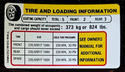

The Combined weight of cargo and passenger are show on the tire pressure label attached to the B pillar, inside driver's door.
For example, here's the label on my '24 BL:
Ford Bronco Sport What is the weight load in cargo area for Bronco Sport Badlands, without the back seats laying down? Tire Pressure Label
1000 pounds of cargo is way over the limit. For example, with a 200 pound driver, your max cargo would be 624 pounds, assuming no other "stuff" in the car.
Gross Vehicle weight per axle is show on the VIN tag located next to the tire pressure tag. There is no spec weight for the cargo area alone, that I'm aware.
