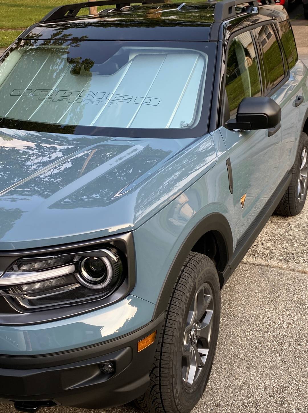

Just my two cents but I’d recommend a well reviewed detail shop for a professional application - usually anywhere from $1,000 to as much as $6,000 depending on job. I decided to coat my still new BS myself both to save money and to DIY this time. Very happy with the results.
Either way, paint correction is key. Wash with Dawn or a wax stripping, demineralizing car wash, clay bar and then 1 to 2 coats of ceramic. I really enjoyed using the new synthetic clay mitt I bought from Griot’s Garage.

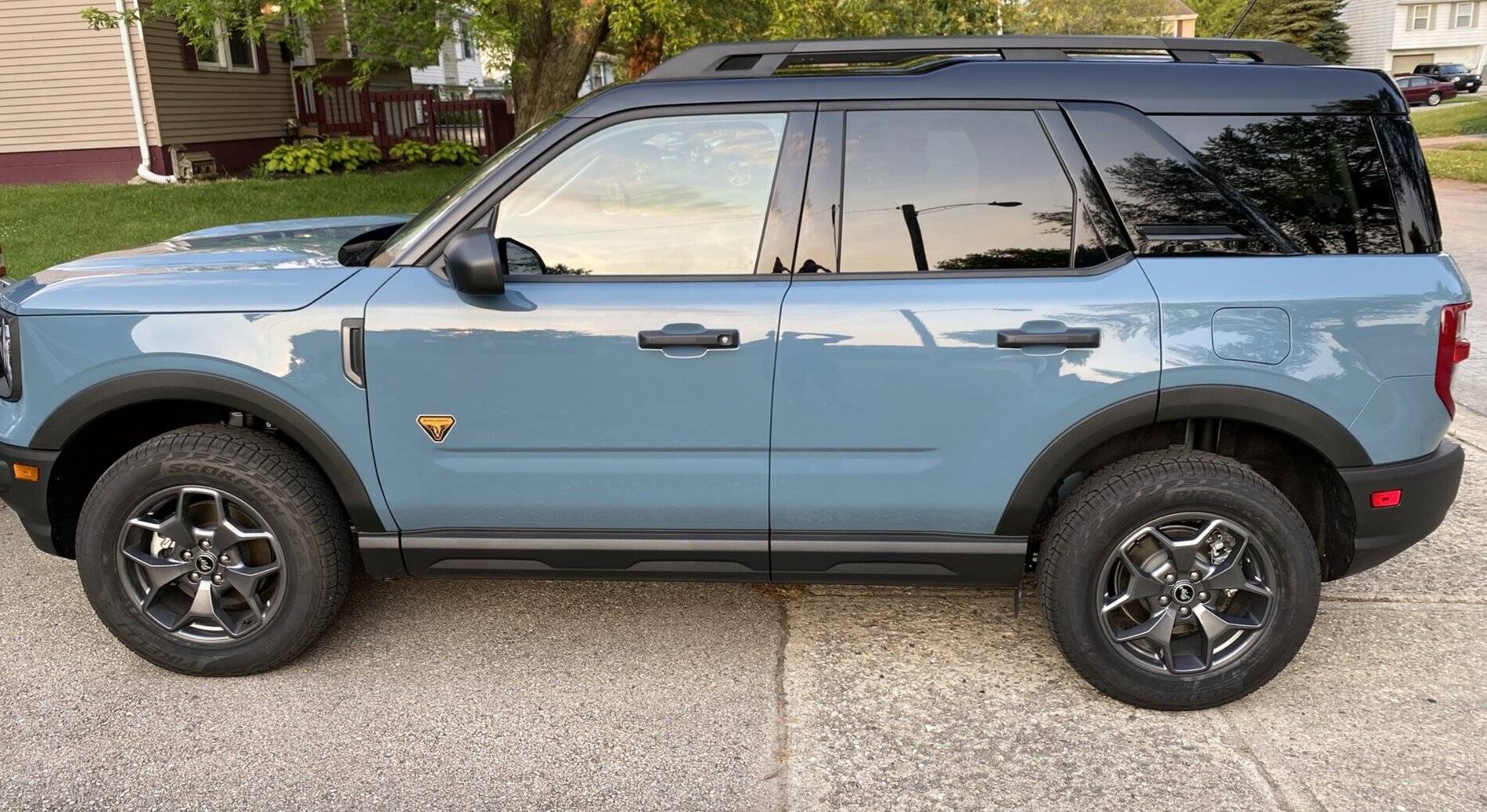

Use Cquartz on my vehicles.
ā€˜Anything that comes in a spray bottle is not a true ceramic coating…it would harden and clog the sprayer after the first use….
Adams grapheme spray is the closest in spray form I’m currently aware of that actually is easy to use,and will protect for about 6 months.
