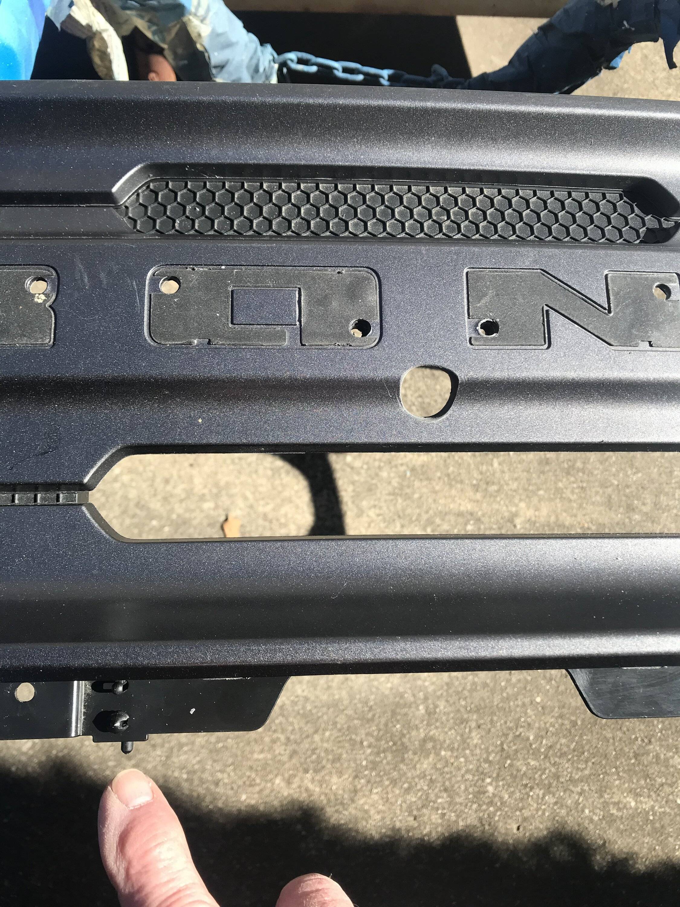

ln case yours gets damaged.
The ambient temperature sensor on my 2022 Bronco Sport Badlands is located on the front grill inner support placing it right in front of the top of the shutter opening. It mounts on the inside. My finger is pointing to the 2 push clips of the sensor.

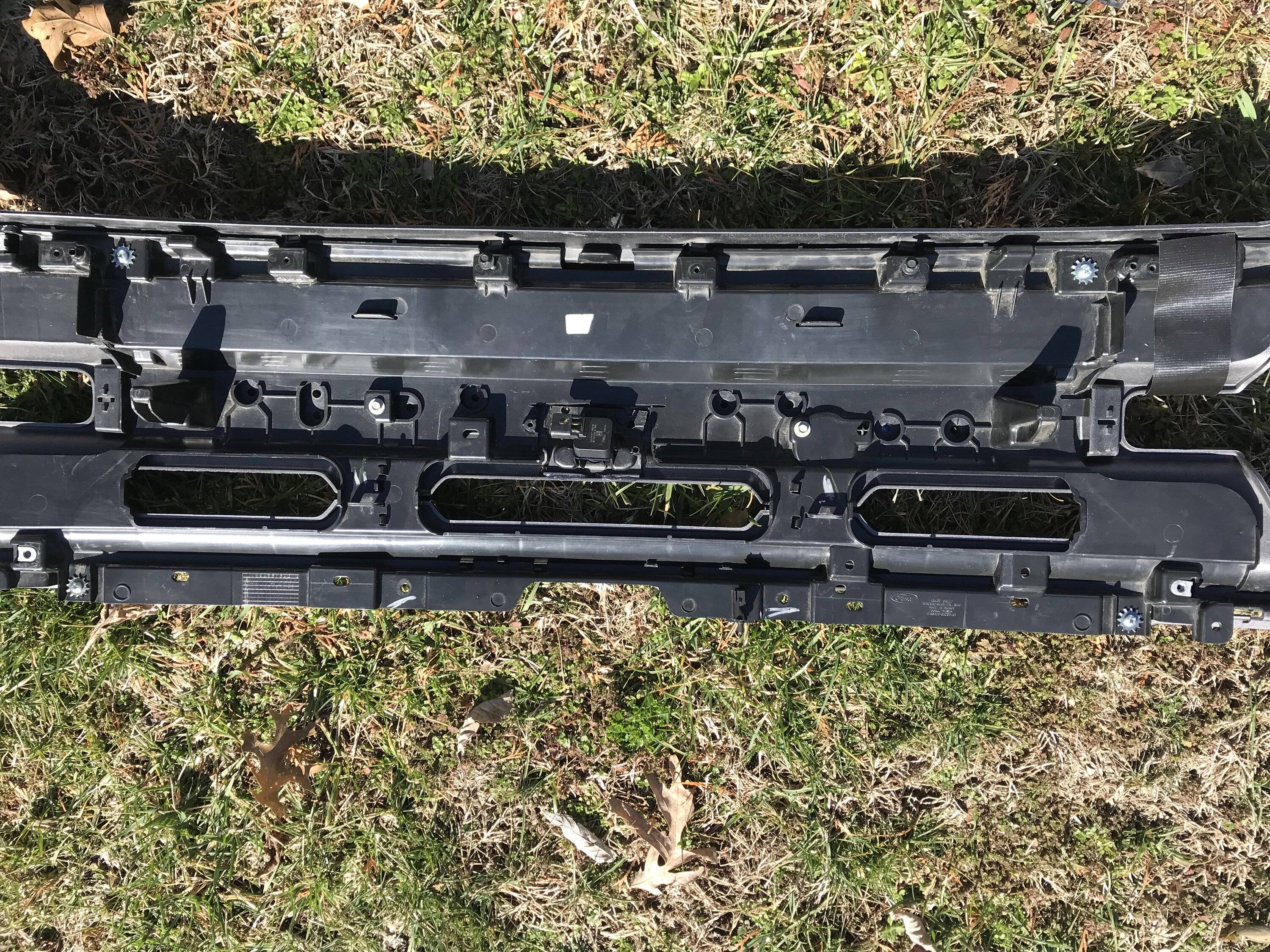

The 2nd picture shows it at the inside bottom just right of center.
May be able to reach to replace without taking the front grill (and everything that goes with it) off

Thanks for the info - took me a while to spot it on the bottom pic - sort of like where's Waldo...
