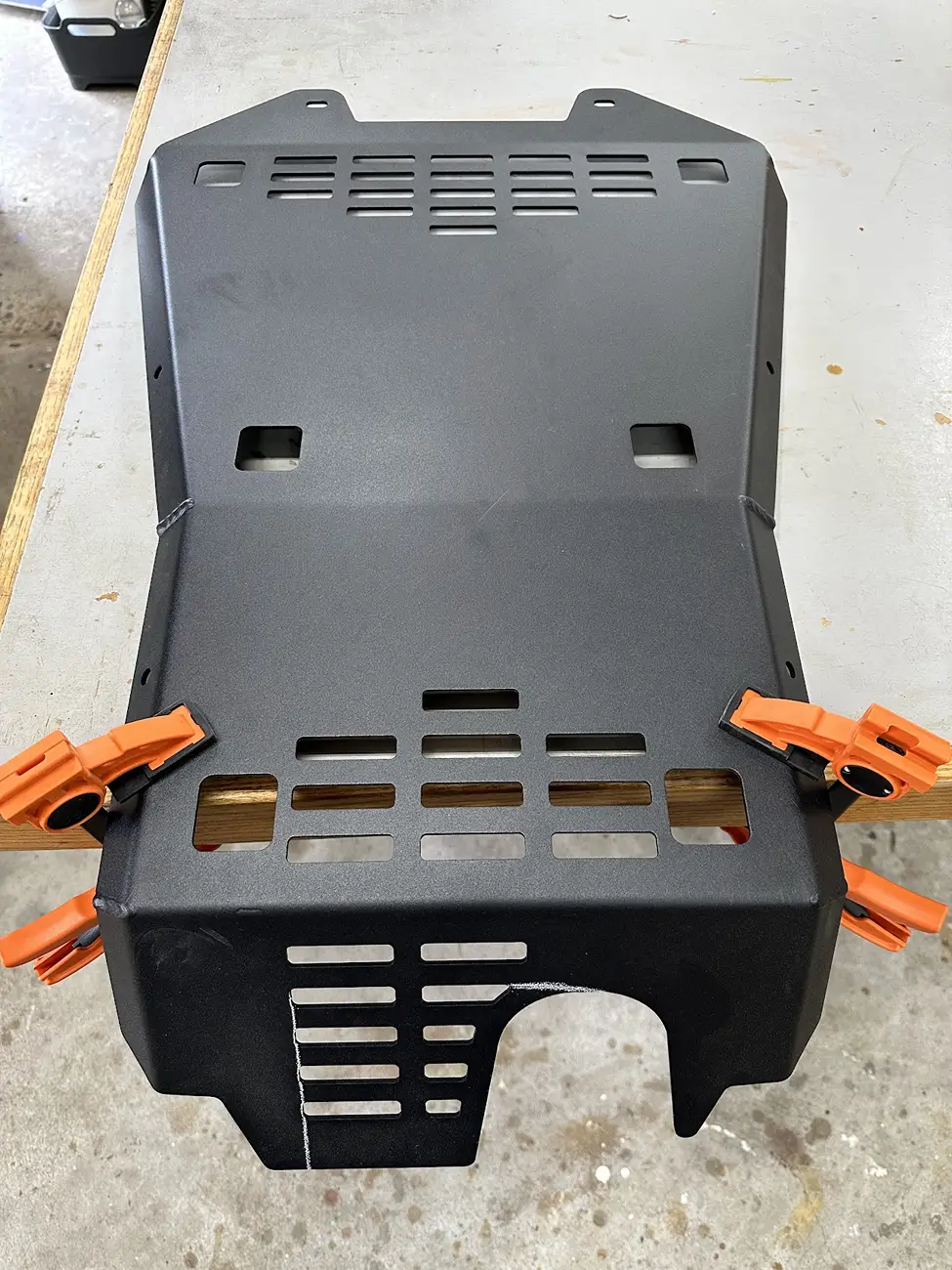

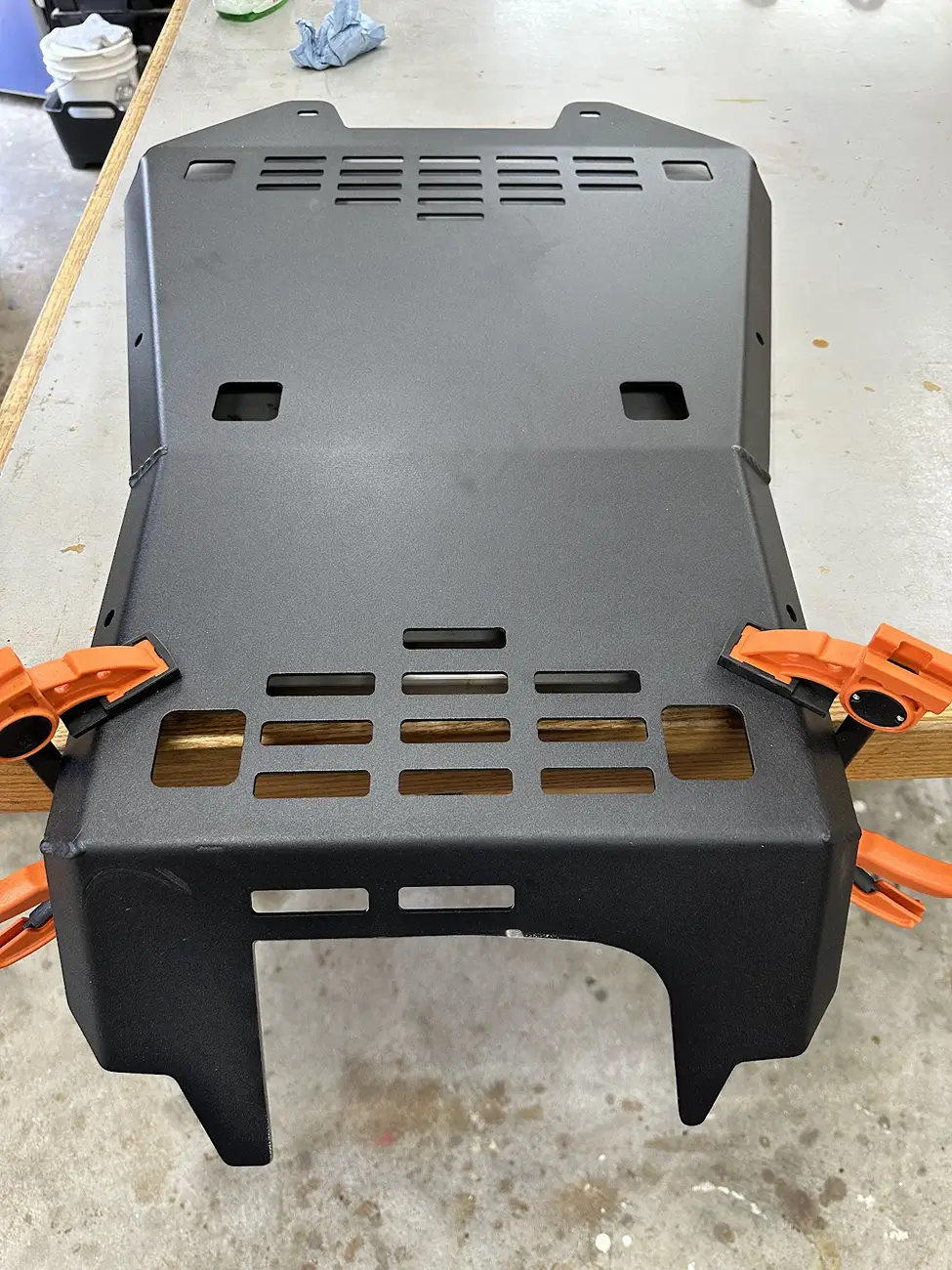

As expected, it wasn't a direct bolt-on. I had to trim the back of the skid plate to clear the rear of the GPF.
Stock Plate: Marked where I planned my cuts.
Post-Cut: The modified plate ready for install, (i did paint the raw cut edge before installing it.)

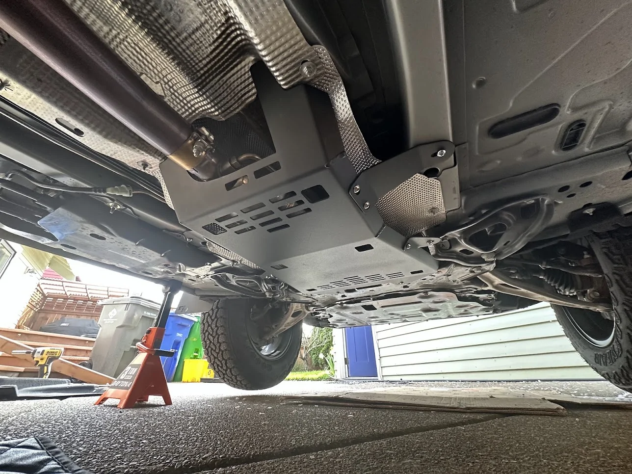

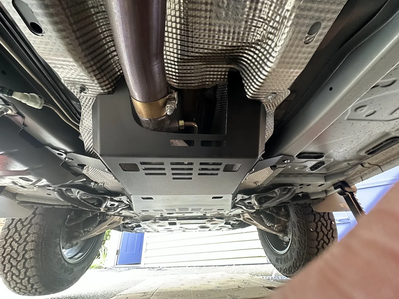

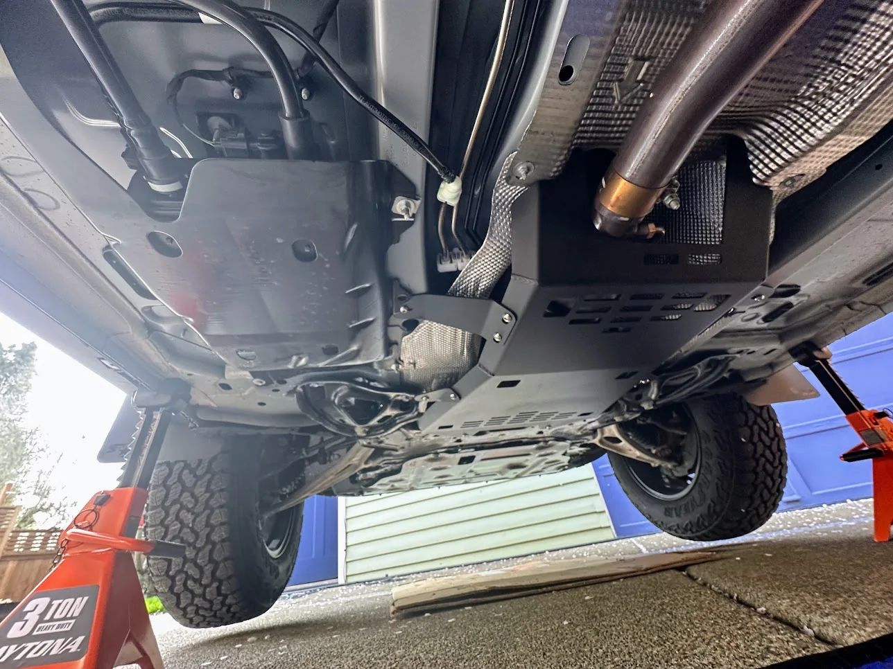

Installed: How it sits underneath with the GPF.
- The Cut: I ended up cutting a bit more than strictly necessary to avoid having to mount and unmount it multiple times, but it provides plenty of breathing room now.
- Clearance: It just barely touches toward the front of the GPF.
- Results: So far, so good. I’ve noticed no rattles and no signs of excessive heat on the plate.
