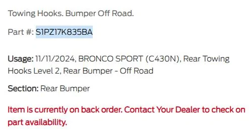

Does anyone have the part numbers of the rear recovery tow hooks / shackles of the 2025 Sasquatch? I would like to add to my Badlands
Ford Bronco Sport 2025 Sasquatch Rear Recovery Tow Hooks / Shackles - part number? 2025-ford-bronco-sport-108-66c746c298e18

I found what you posted, but I don't think it includes the shackles. If you look up the front of the Sasquatch it shows the plate like this, but then it has the shackles listed separately with their mounts.

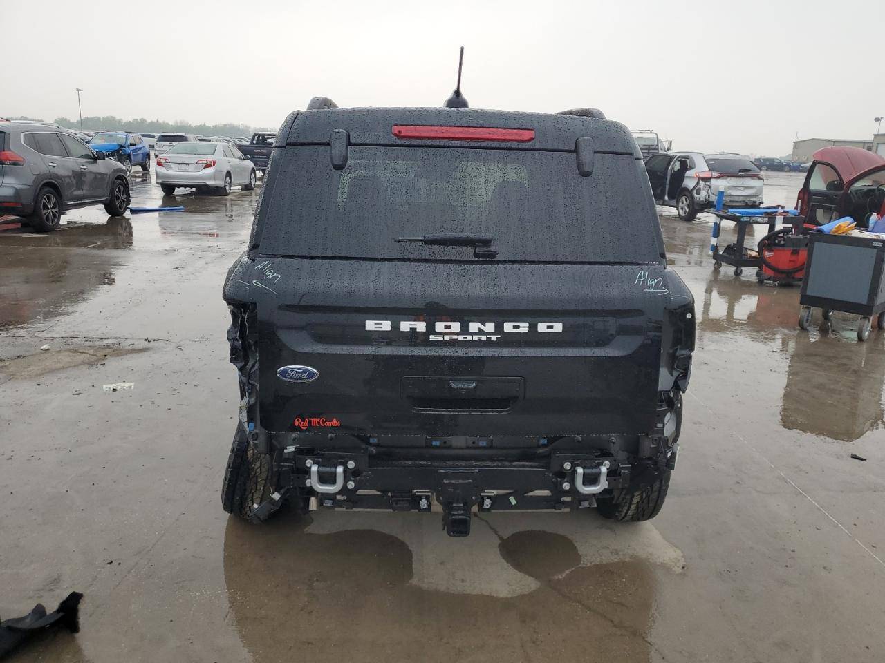

The tow hooks are a part of the tow bar that protrudes through the bumper on the 2025’s. Should bolt right up (to all years as far as i can tell) if you can actually manage to get your hands on one. I want them on my FE

Just FYI for those considering this, I think you will need the factory (or Draw Tite version) trailer hitch for these to bolt to. Without it, there is a bumper beam that extends outward beyond the inner edges of those 4-bolt flanges that hold the hitch/bumper beam/tow hooks in place. If you don't have the factory-style hitch, I believe the main portion of the bumper beam that extends past those mounting points will interfere with the tow hooks.....seems like there was something about two objects not being able to occupy the same space at the same time. :crackup:

At least on the first gen if you don’t have the factory tow bar you have a crash bar that bolts into the same location. It’s tied to the rear body with a few bolts each, and the tow bar also extends back into the unibody for extra strength
