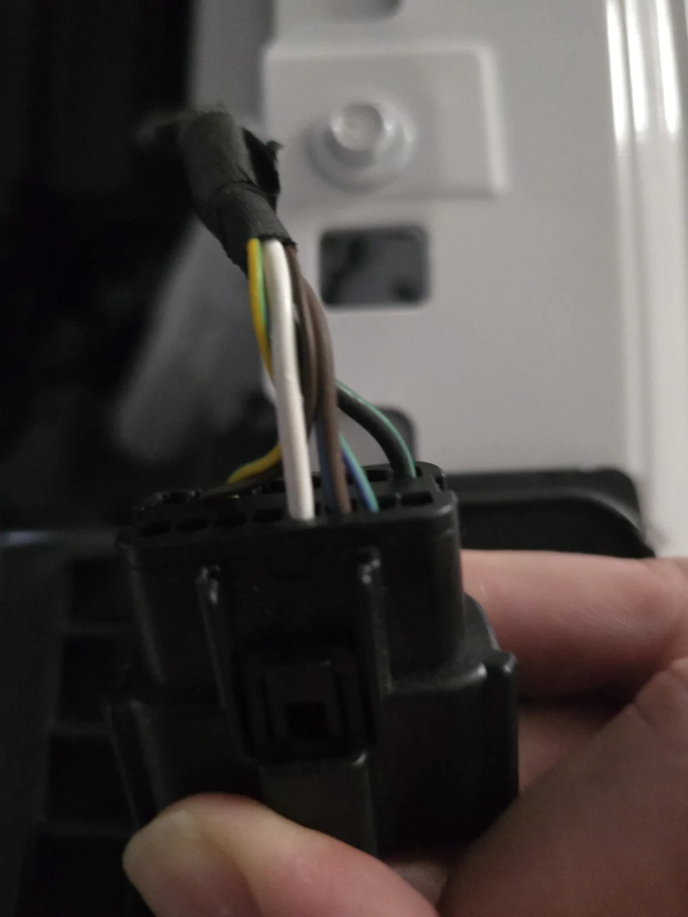

So I want to put in some grill lights. I'm looking at a video with a guy saying to put power in the brown w/blue stripe and ground on black w/green stripe. But I might be going blind and I can't quite tell which is which. I took a picture and *I think* the brown/blue is next to the white one and *I think* the black/green is the far right on the bottom. But colors are messing with me today and I can't quite tell.

Sounds right but your pic is abit fuzzy and not much visual separation to the white wire
Put a voltmeter across those two wires and confirm you get what you expect
And is the info you got specific to the 2025 left side connector?

I don't know if its specific to the 2025
