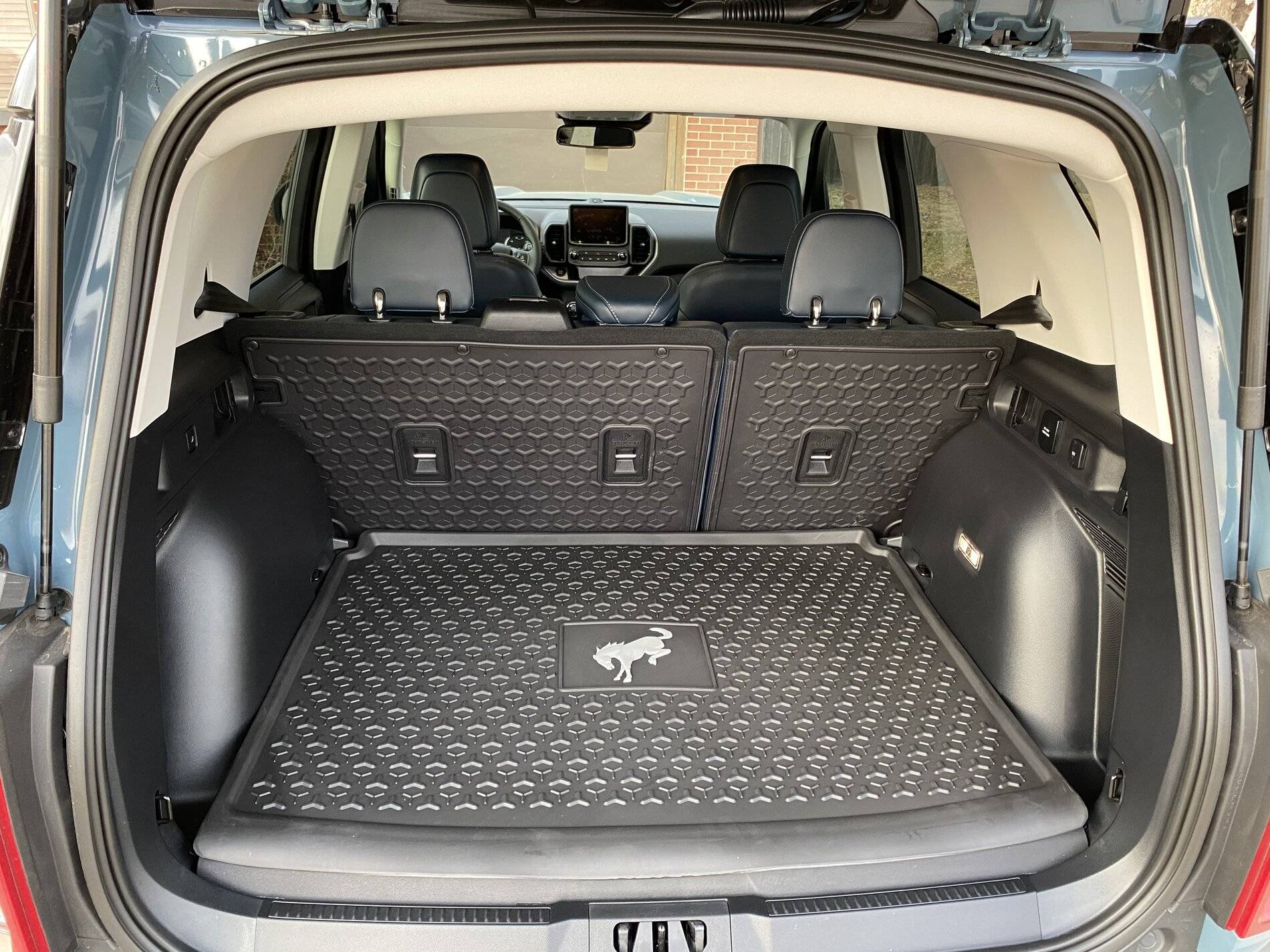

Cargo liner

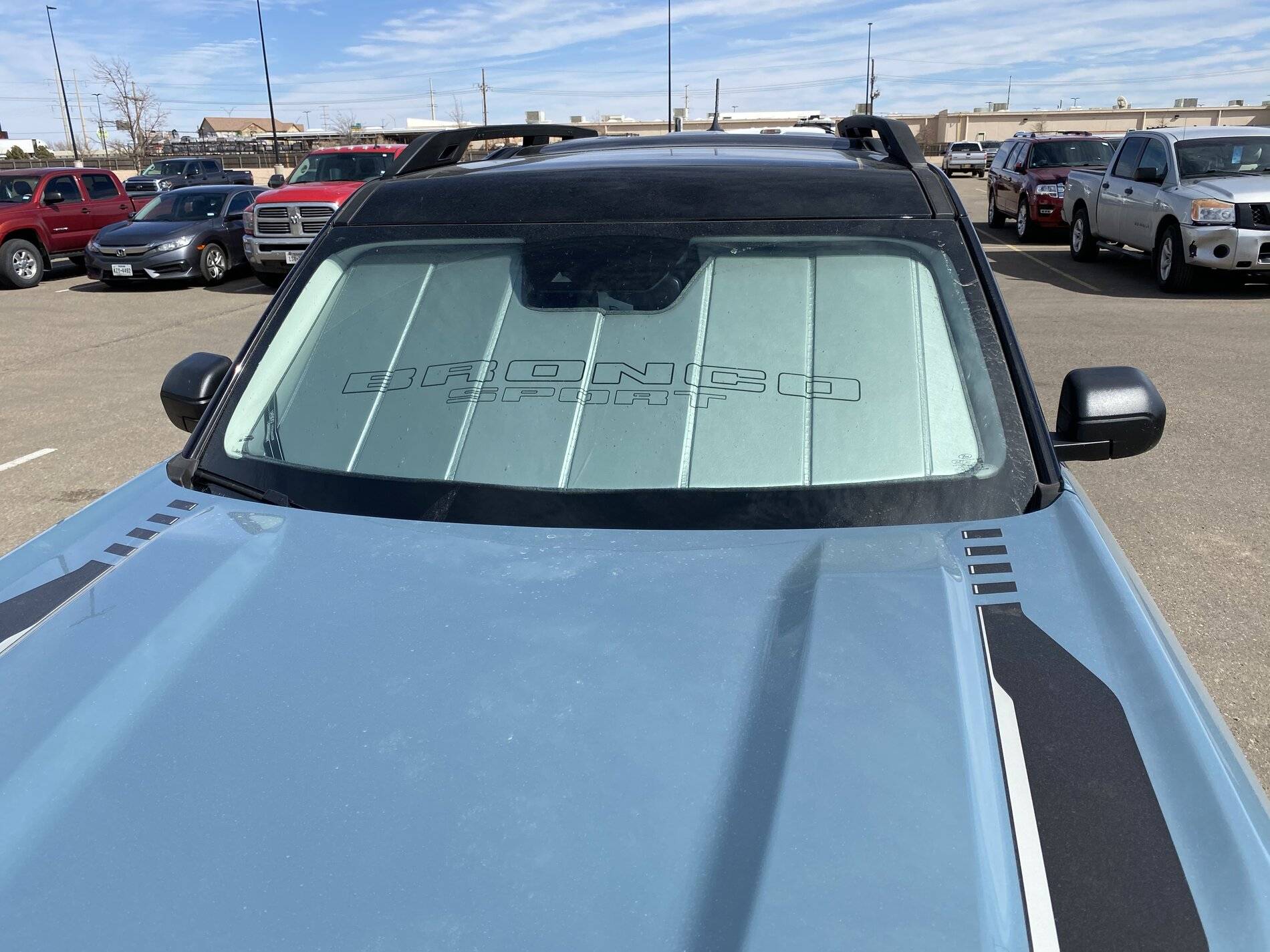

Sunshade

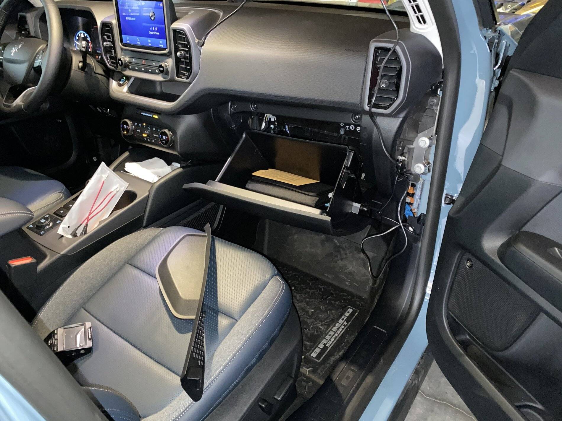

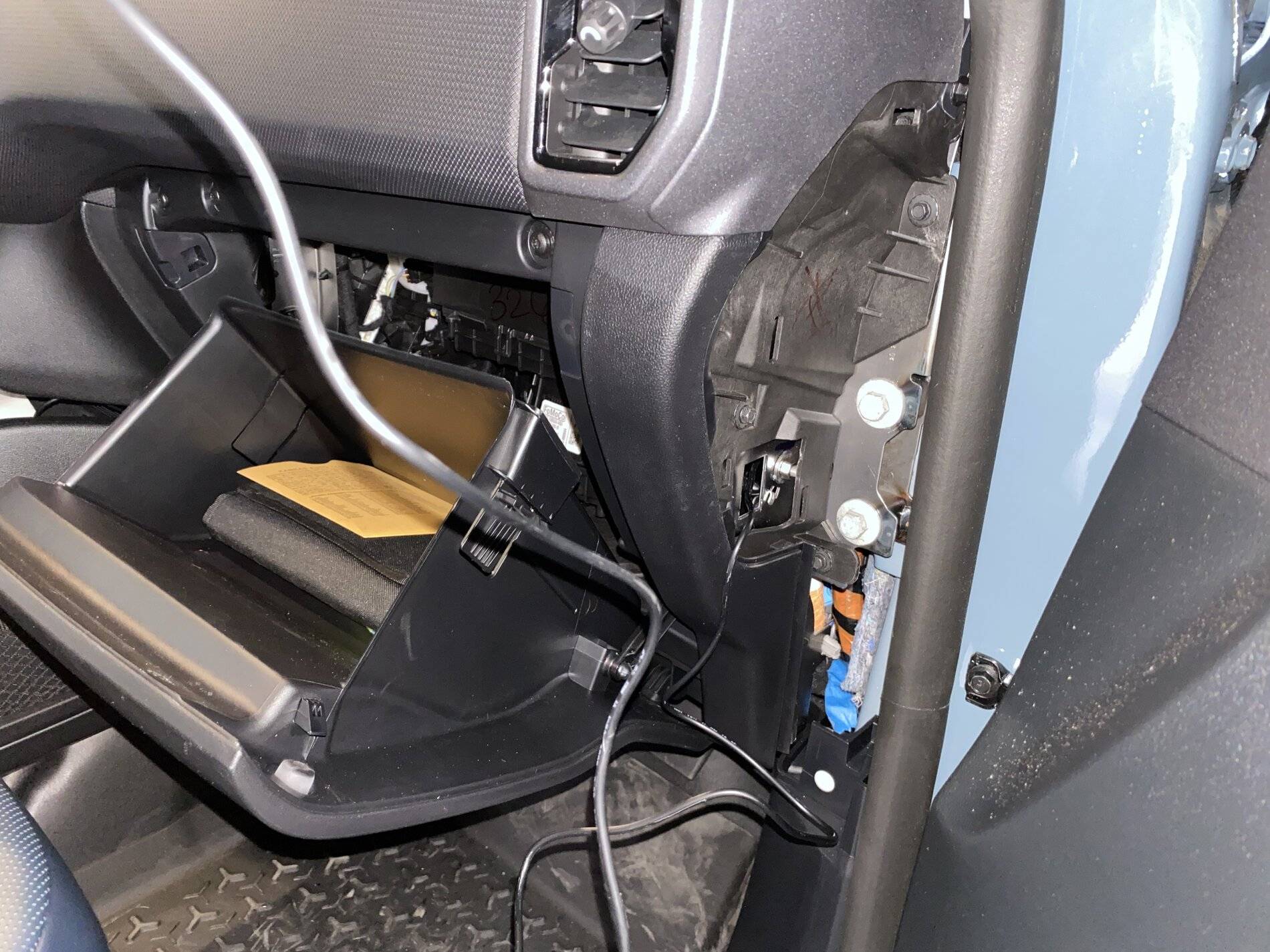

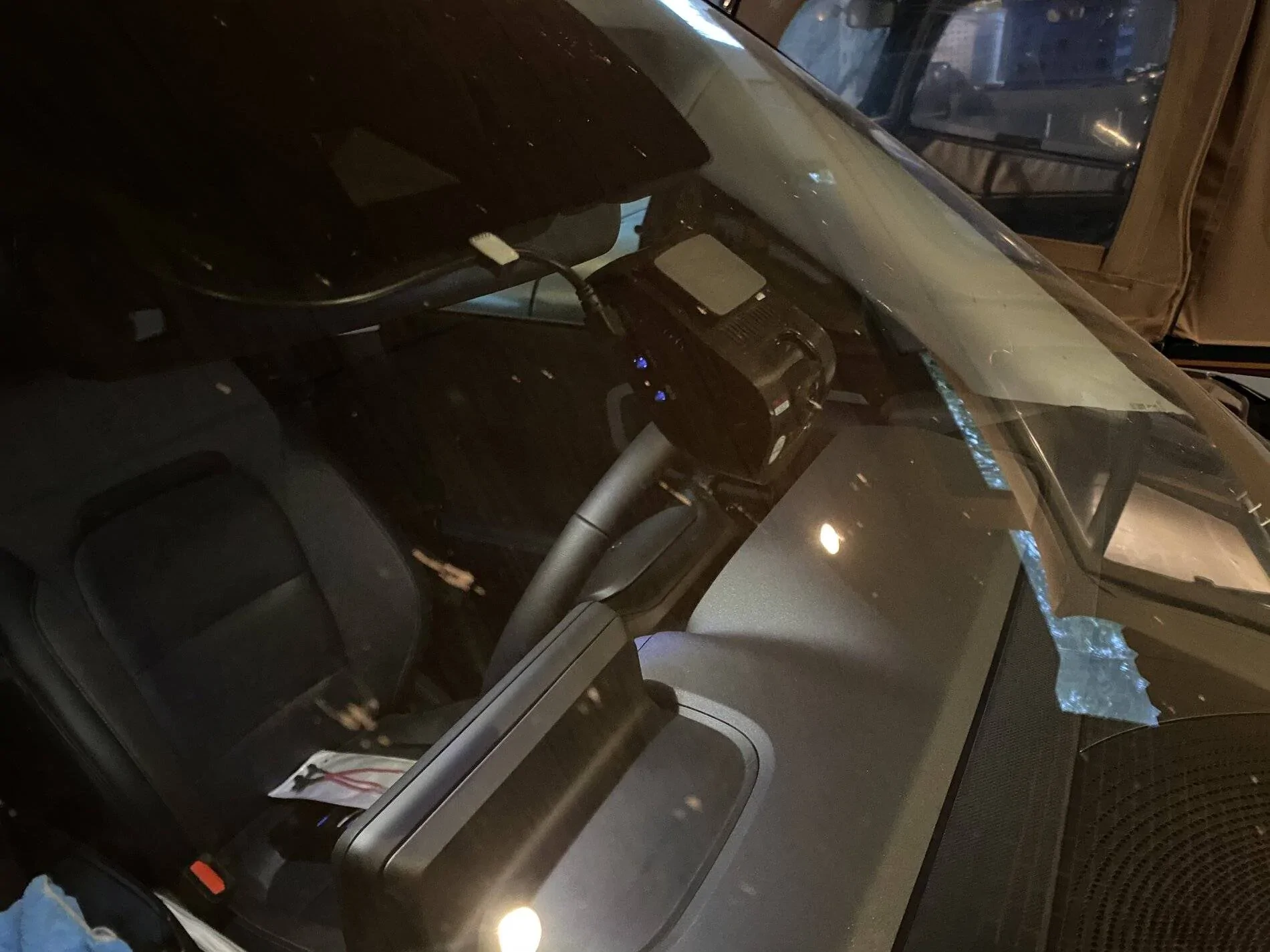

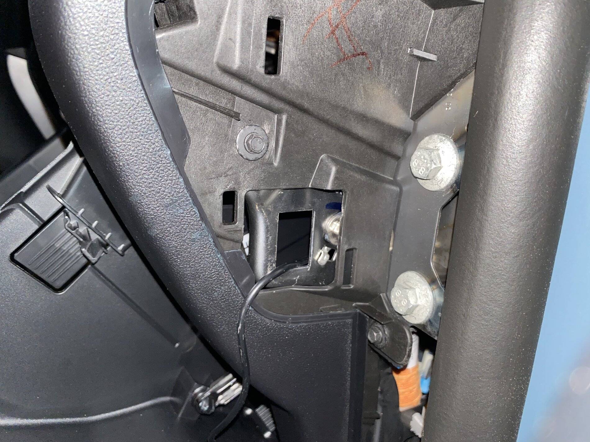

Originally I was going to wire my dash cam into the fuse box and I still might do so, but it is plugged into the cigarette lighter for now. I ran the cord from the cigarette lighter, behind the glove box, and through a hole in the dash frame right behind a trim piece that the passenger door shuts against. From there, I tucked the wire behind the A pillar, going up to the headliner. Then I used the 3M backed clip things that came with the camera to run the wire across the top of the windshield and to the rear view mirror. Next, I mounted the camera to the windshield and plugged it in.
Trim panel removed, feeding wire from behind glove box through hole, up towards A pillar.

The hole I ran the wire through.

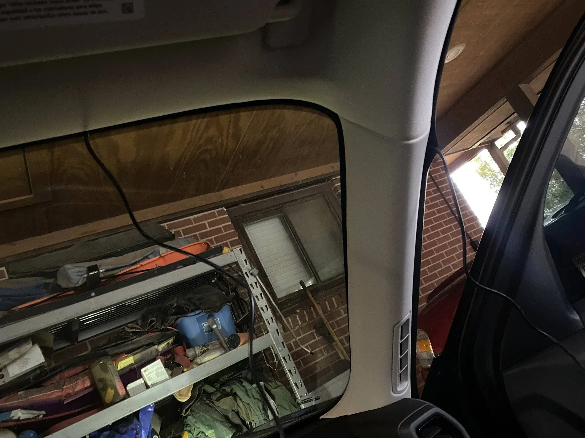

Preparing to tuck wire behind A pillar.
Hard to see, but this shows how I ran the wires across the top of the windshield and to the camera below mirror.

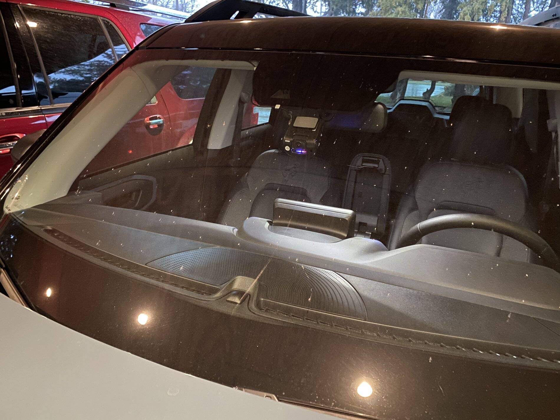

Camera from outside.
Camera from inside. Anyone seen this building before?

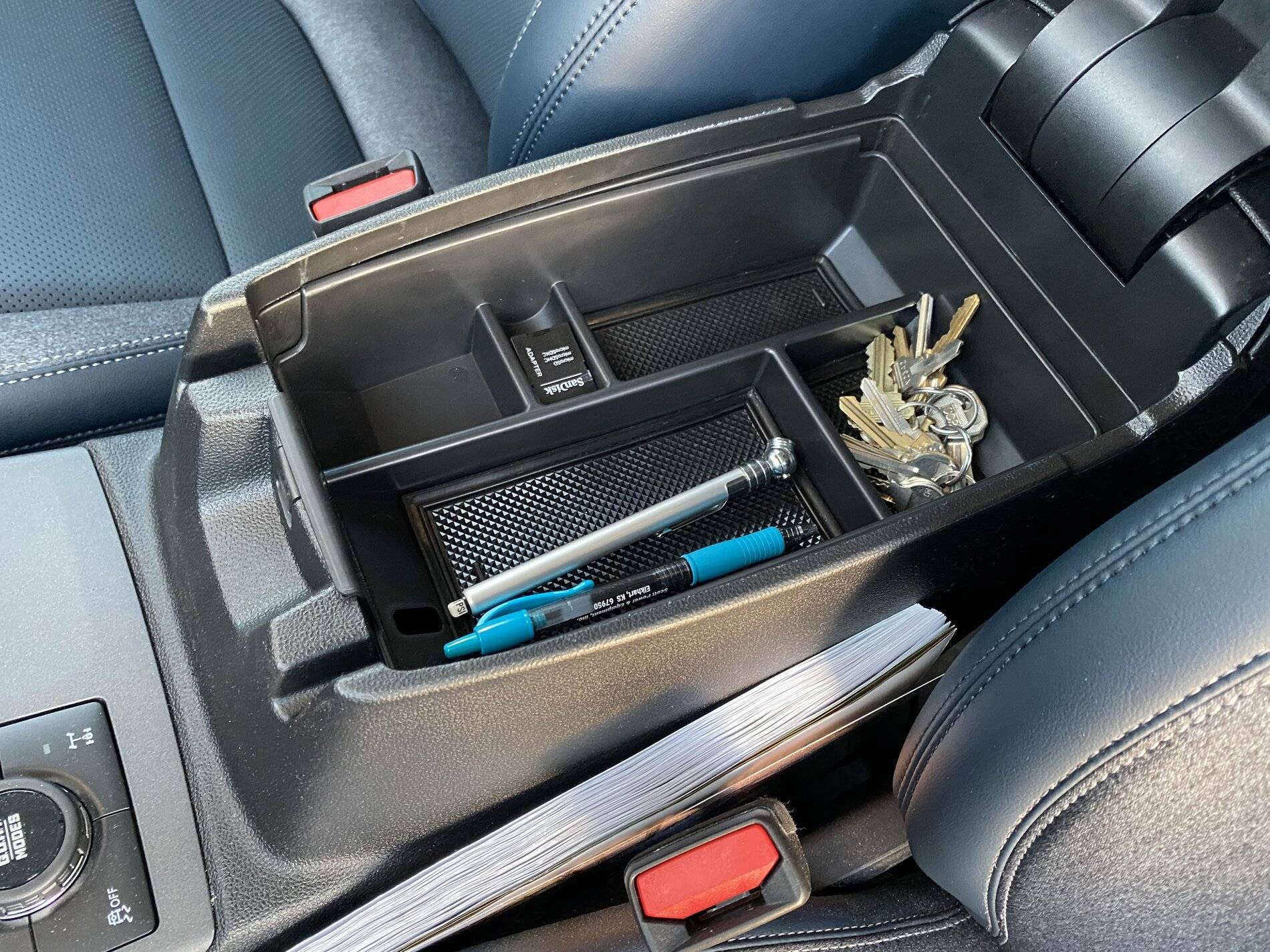

Center console organizer. That’s a road Atlas between the seat and console.

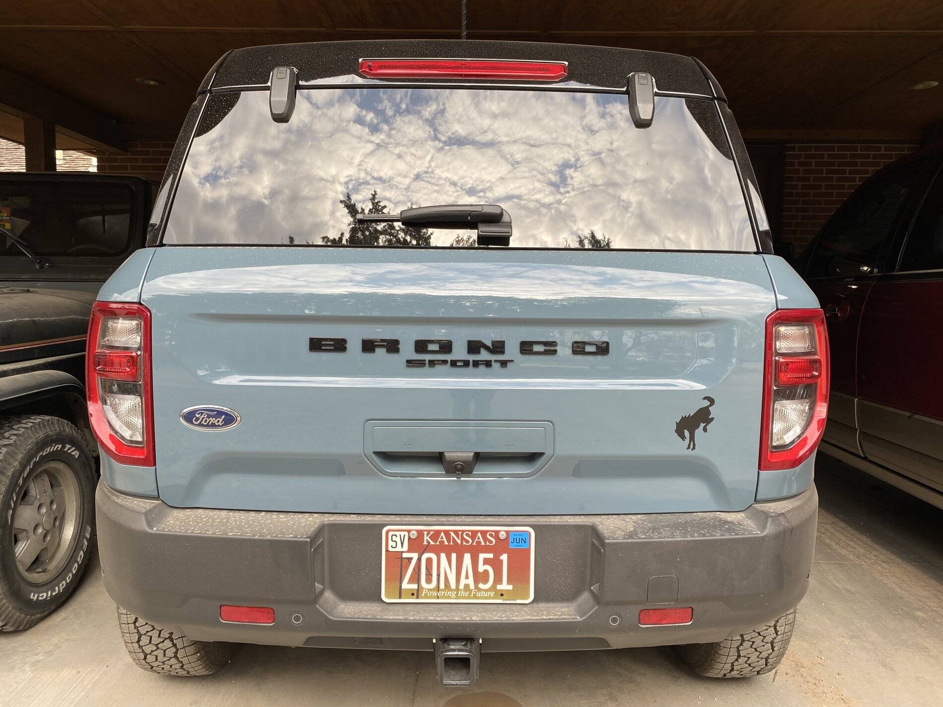

Bronco decal
