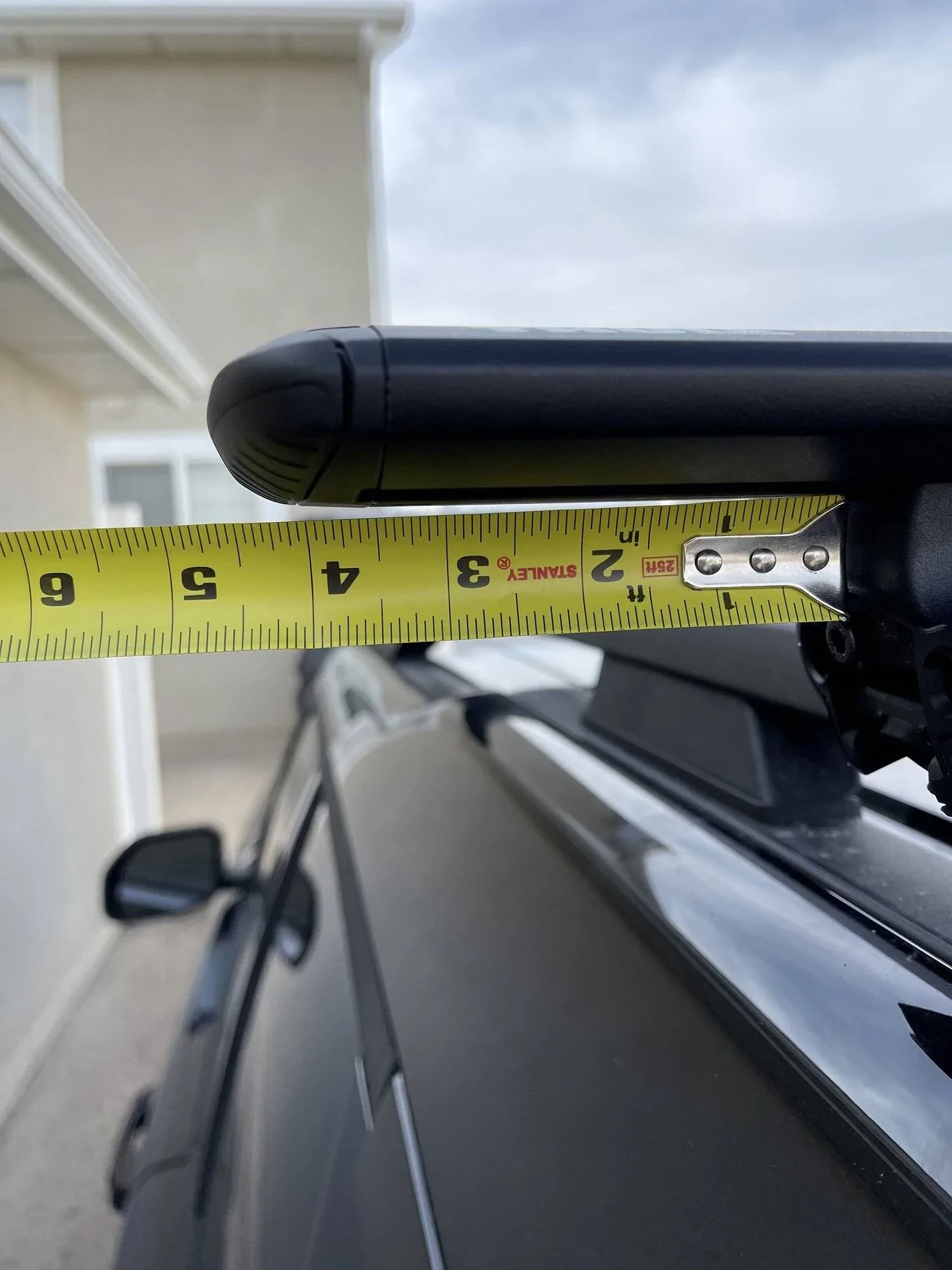

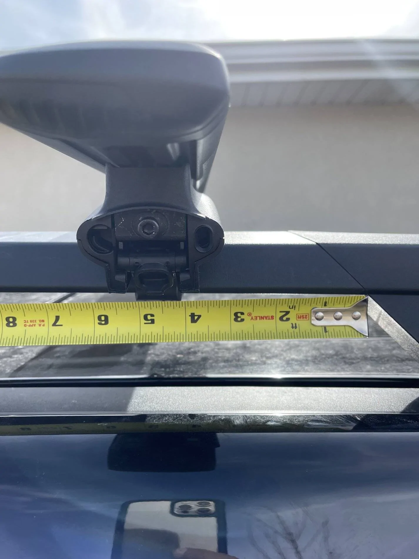

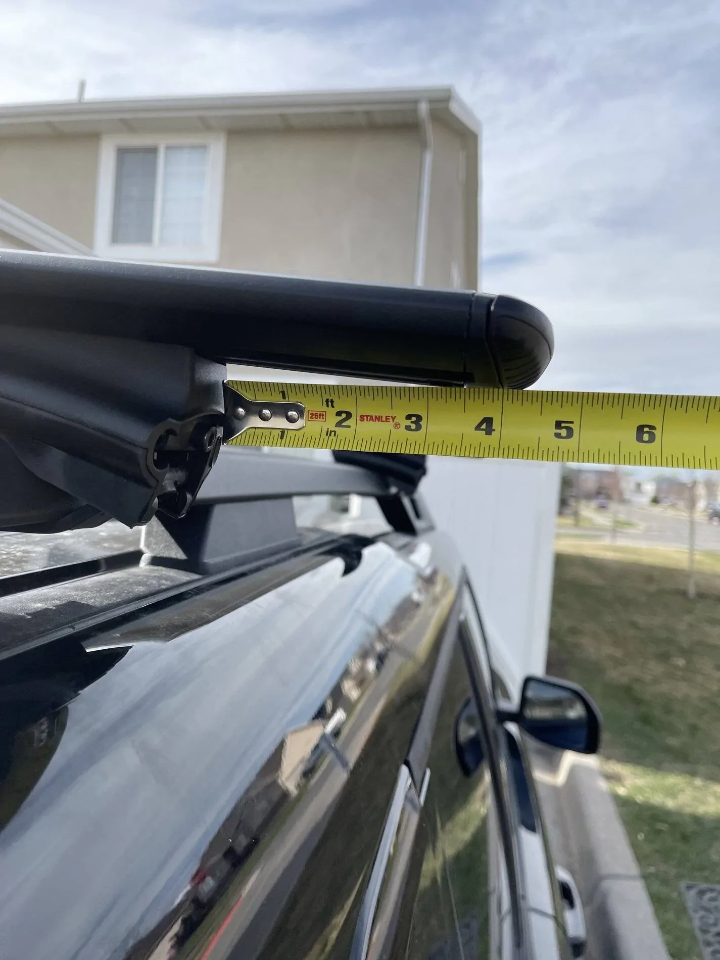

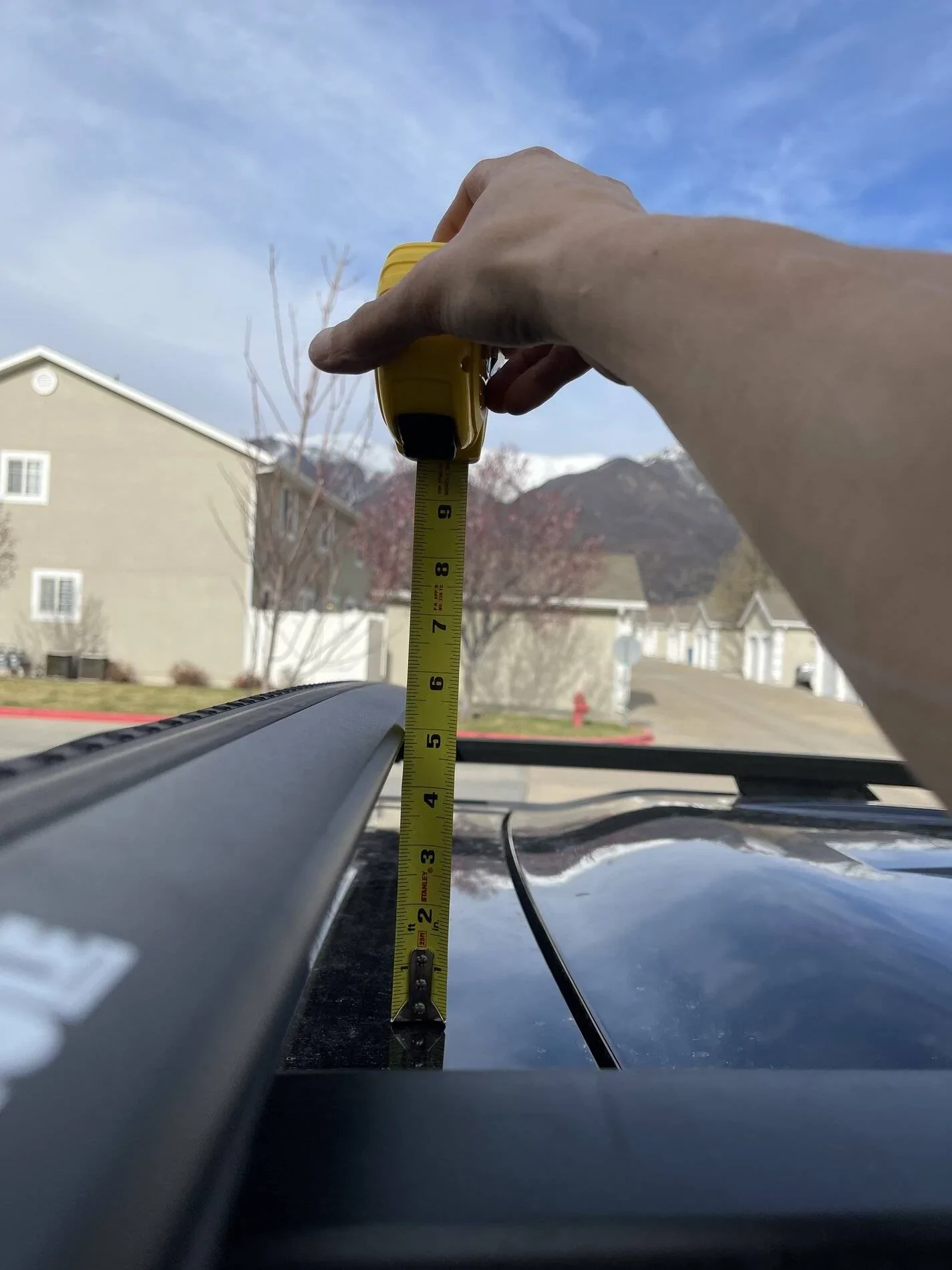

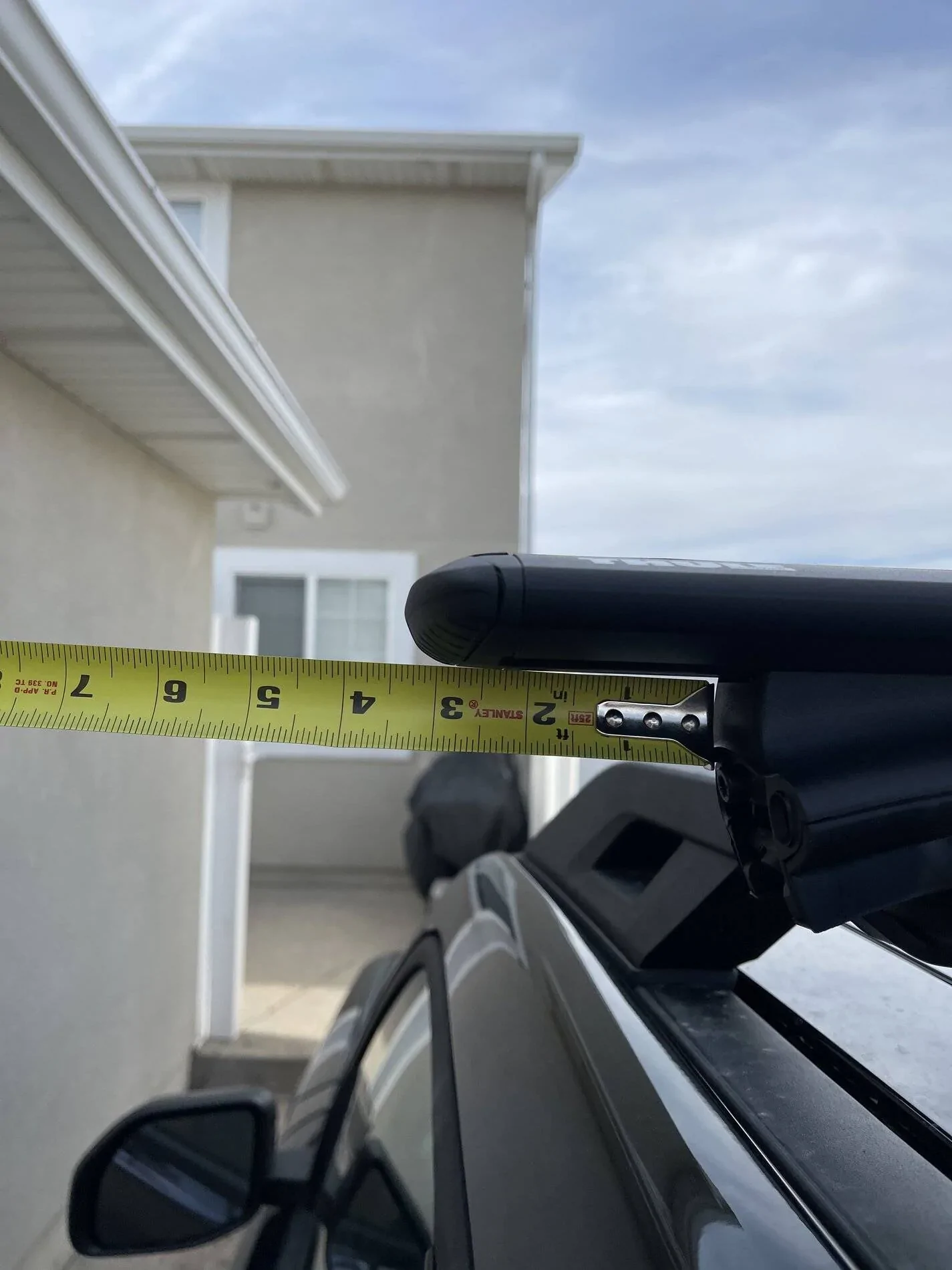

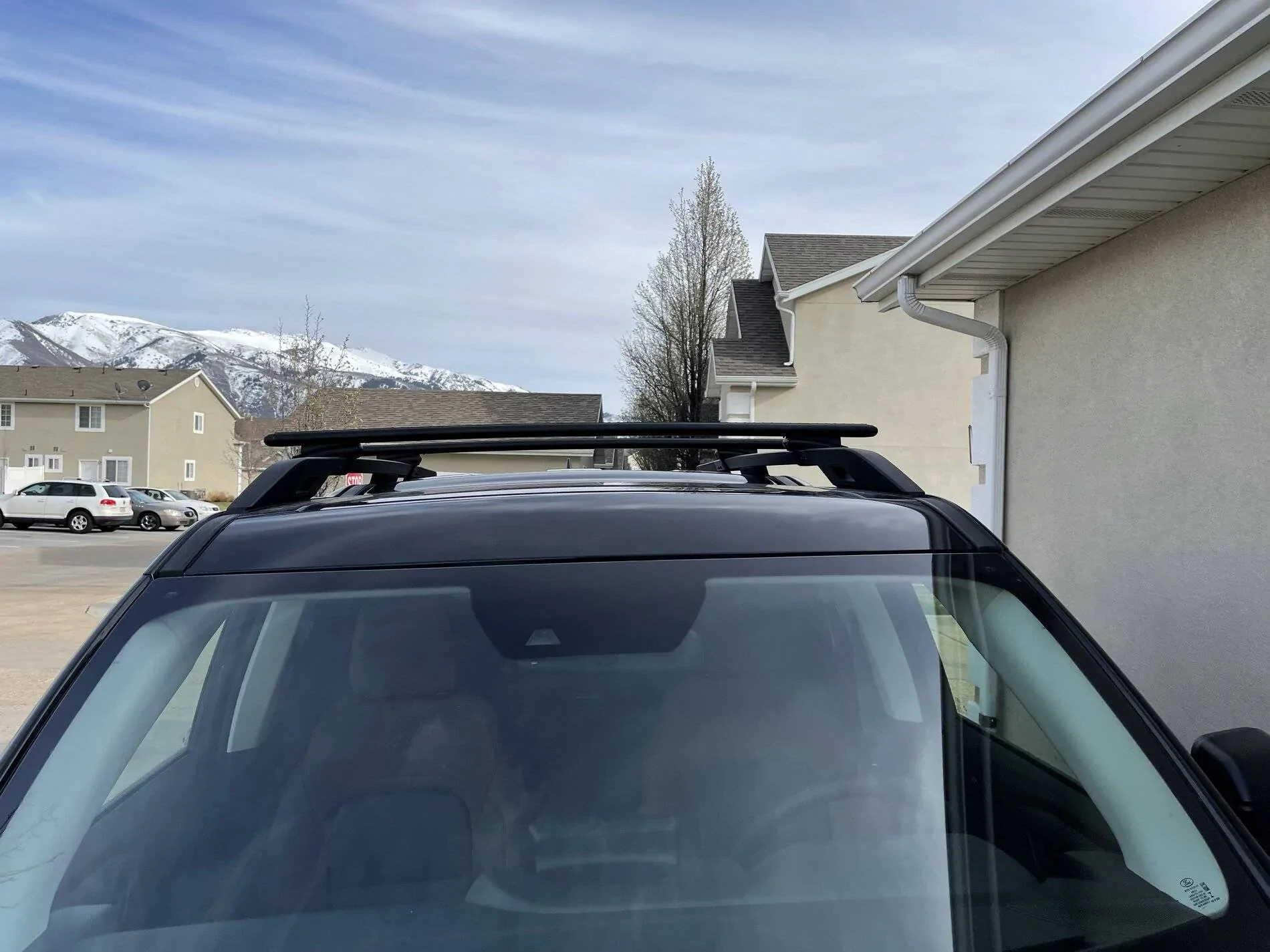

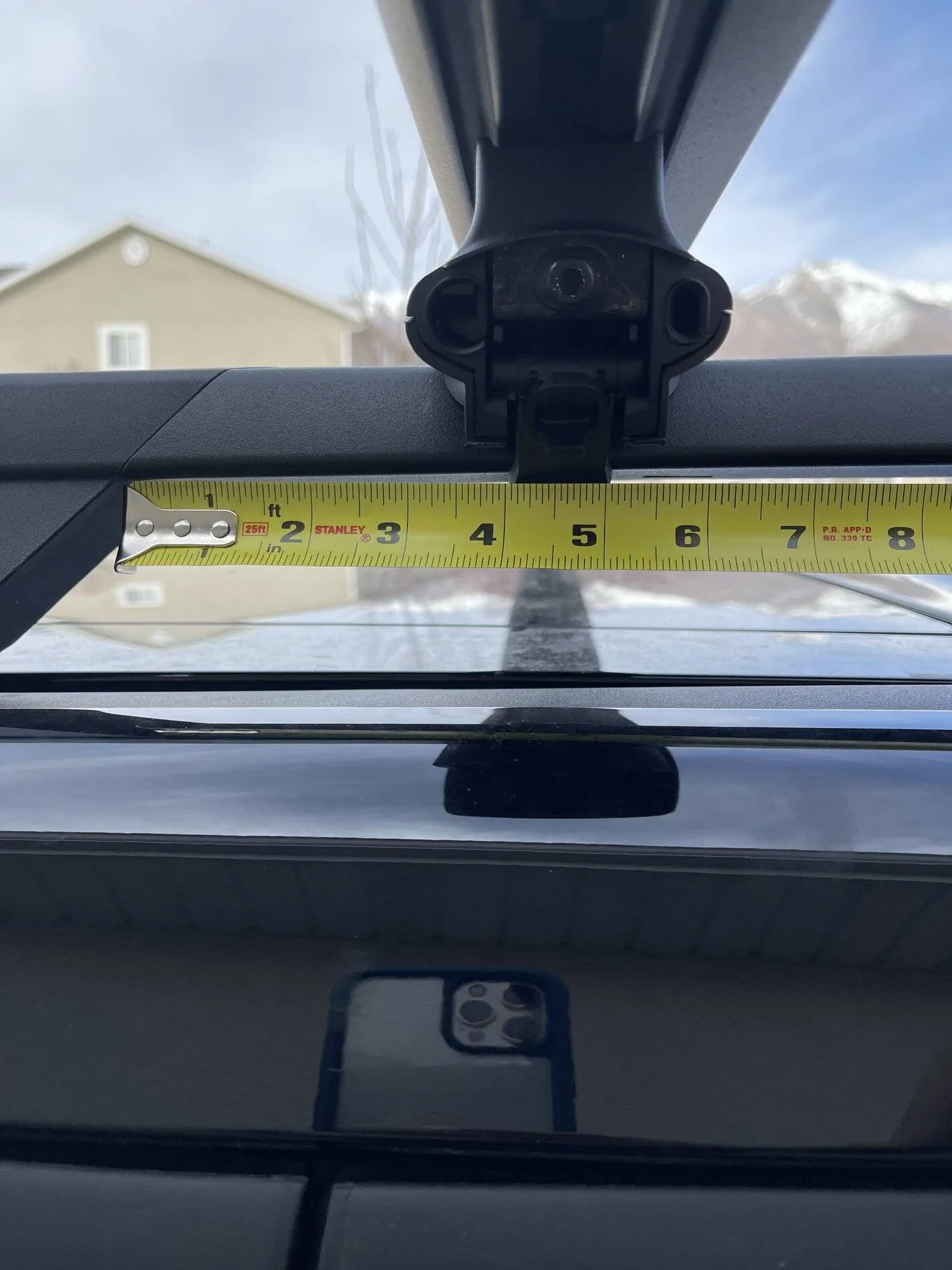

I wasn't digging that the factory cross bars by Yakima didn't lock... so I am trying a Thule set up as well.
The factory "Yakima" bars were $340 installed See(Factory Yakima Install)

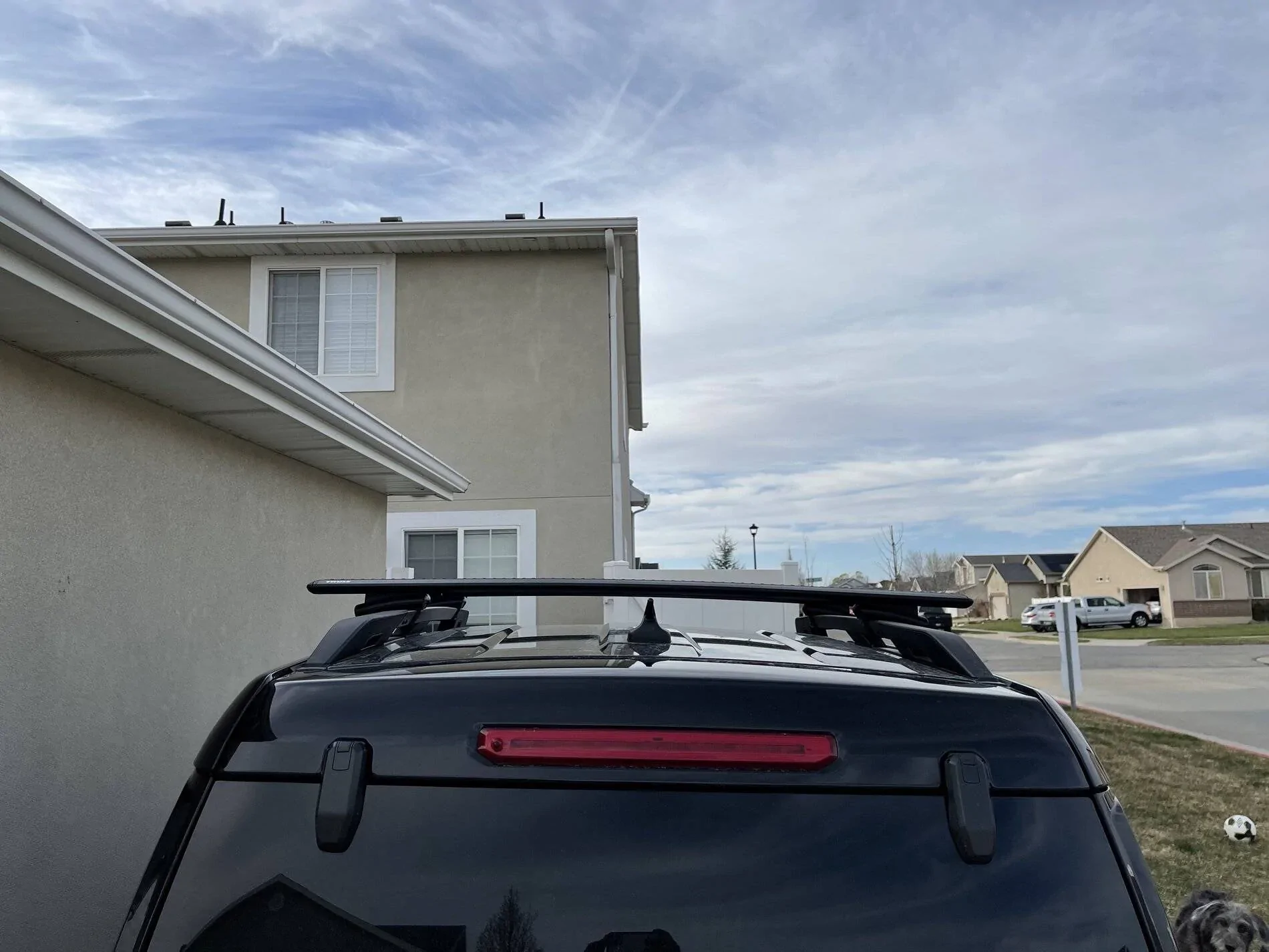

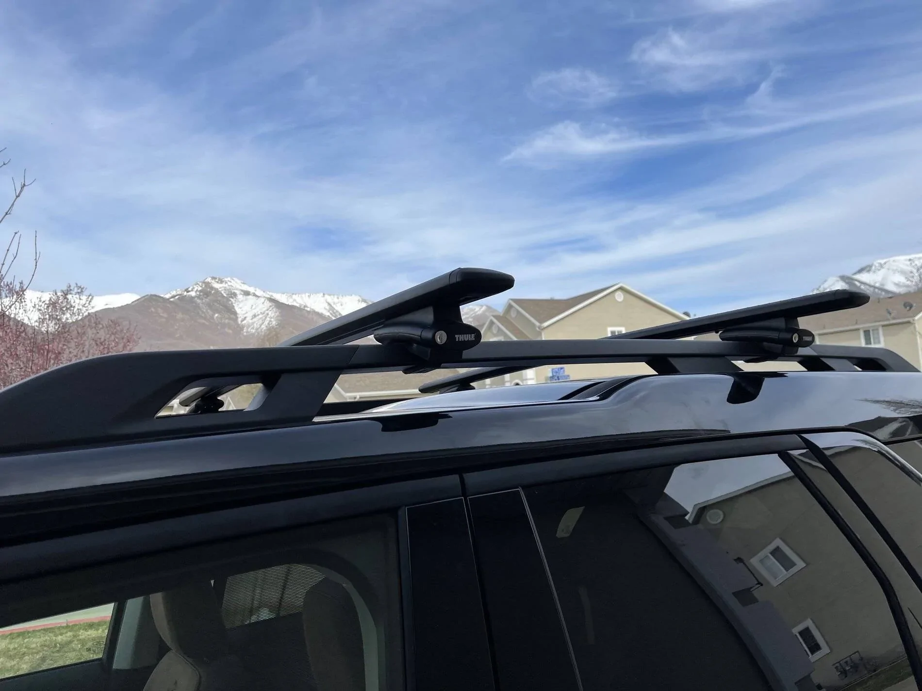

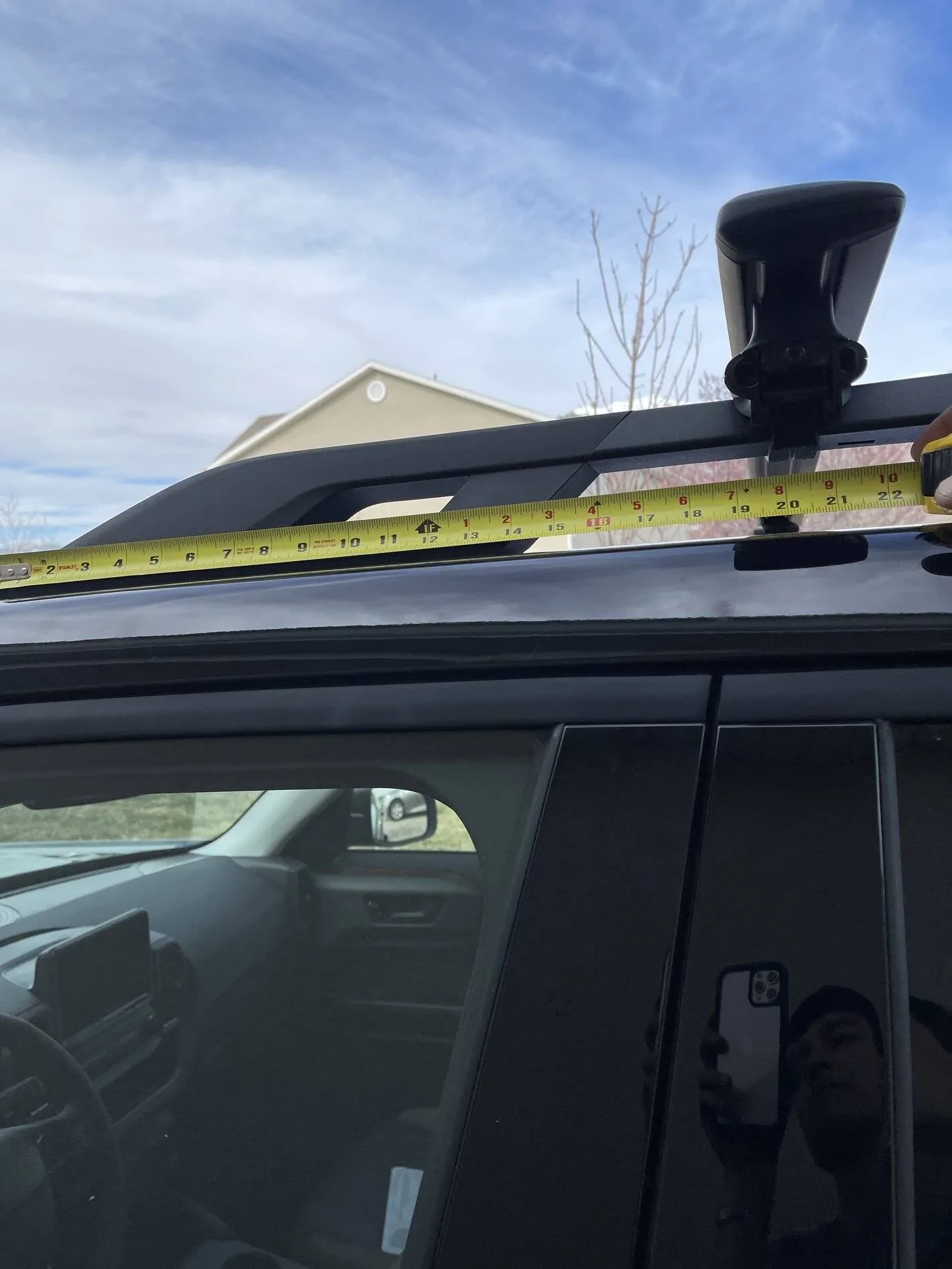

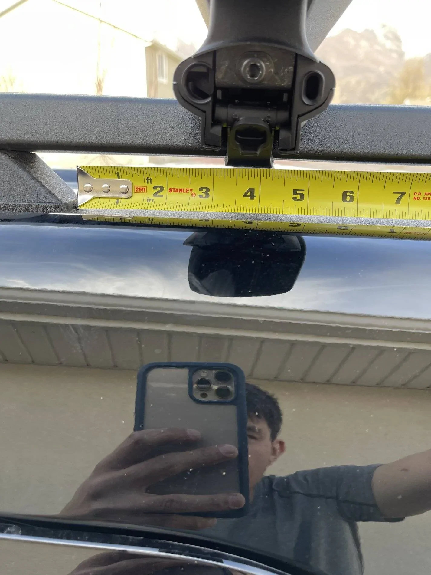

This set up was a bit more expensive. The bars were $220, the foot pack was another $220 and I paid $80 for 6 locks with the same key. They did have a 4 pack for $60. The installation was a bit more tedious than the factory Yakima's, having to center, measure, remeasure, then recenter everything while getting up and down the step stool did get old. But it wasn't hard by any means.
Honestly, I prefer the look of the factory Yakimas, but the fact that they don't have locks is just too much for me to look past. With this set up I was able to place the crossbars anywhere along the track I liked as well, as long as I maintain 24 inches between the rails. which I thought was pretty cool. :)
Front measurements
Back measurements
Distance from front, distance between, distance from rear, height from roof

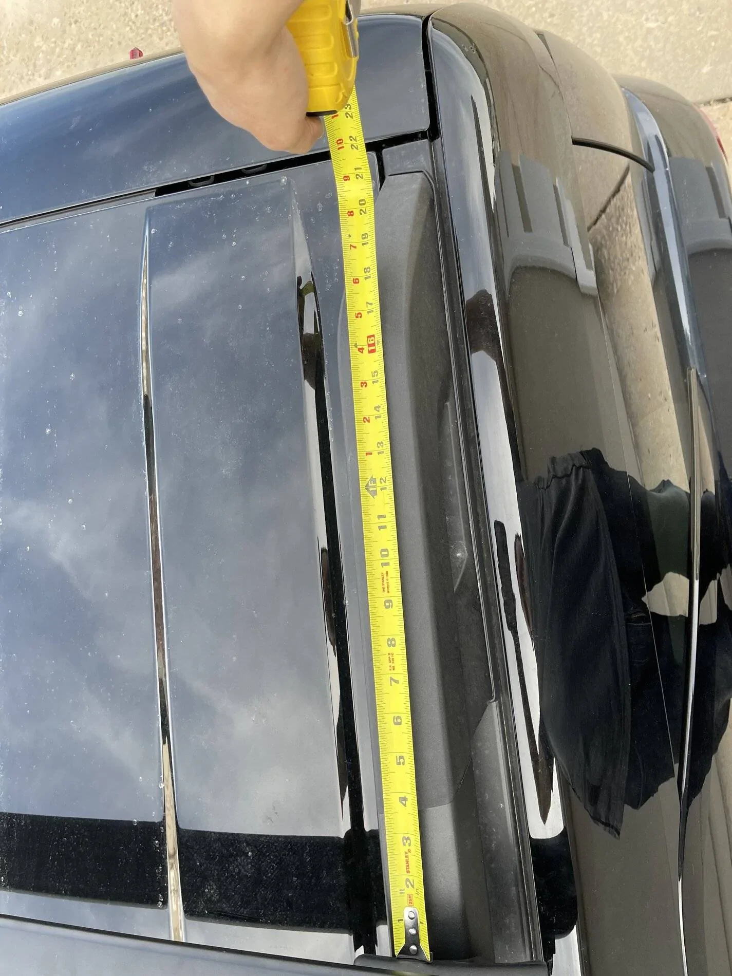

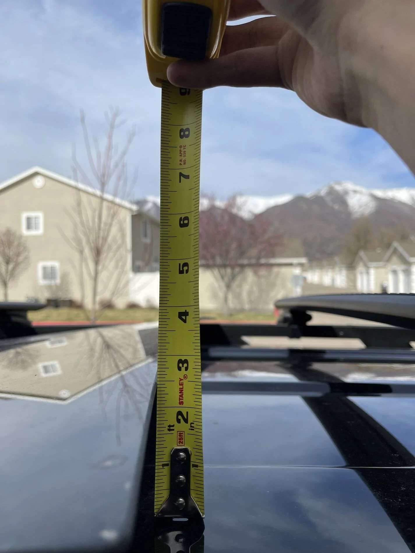

Sun/Moonroof clearances
What do y'all think? Prefer the factory Yakima's of the Thule's??
Side note; I will be selling the Yakima's if anyone is interested.

Thank you so much for posting! I was starting to get concerned my Yakima Jetstream crossbar setup I have on my Escape (which will be traded in for my BL Sport soon) wouldn’t provide enough clearance for the moonroof to slide back. The clearance is similar to your Thule set up, so I think I’ll be good.
I didn’t even really want the moonroof but I wanted the other goodies in the BL package. Once I have it I’m sure I’ll use it if it works with my crossbars.
Thanks again!
EDIT: Also, I much prefer the linear look of the aftermarket crossbars. Its definitely a more rugged look, which appeals to me. Will go great with my BL+BL with the upgraded tires!

You are welcome! I didn't really want the moon roof either because of roof weight considerations, but I damn sure wasn't getting a BL without the BL package lol. And its nice to just pop it open for air flow, not opening it up all the way is kinda the pro strategy.
