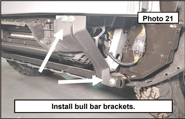

Their pic, from the instructions:
Ford Bronco Sport Rough Country bull bar installation DIY instructions Rough Country bumper cut instructions

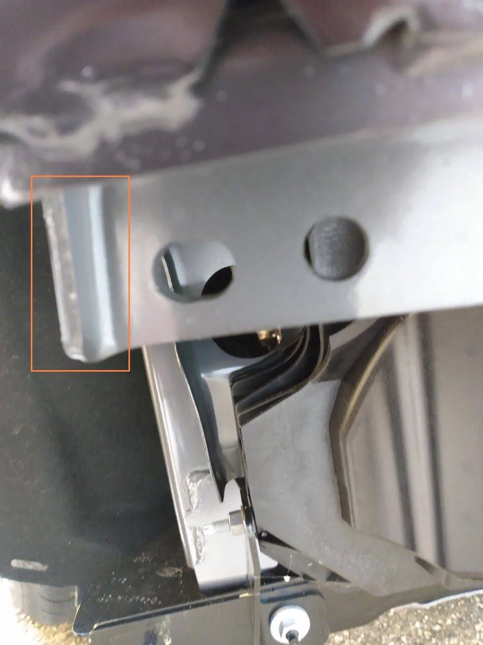

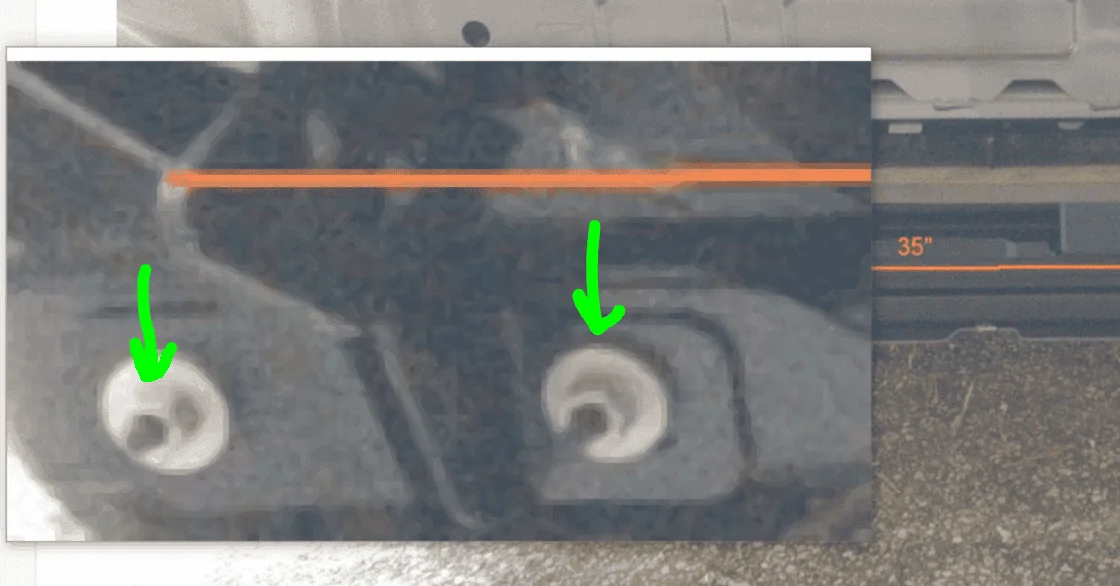

However, the distance between the mounting points on the installed bumper brackets is 35"
Ford Bronco Sport Rough Country bull bar installation DIY instructions Sandefur bumper brackets 35 inches

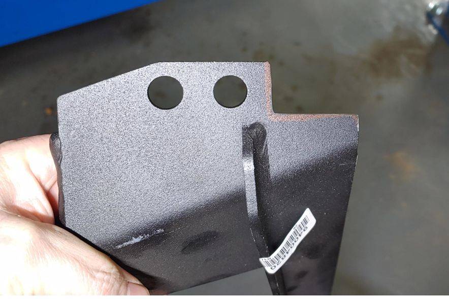

The mounting points on the brackets will not fit through the holes cut in the fascia, because they are 1" off. They will also not correctly mount to the bull bar. I was sent 2 replacement brackets, but they are exactly the same as the first set.
Rough Country shared my pics with their R&D guys and said I had 3 options.
1. Pound the mounting points on the brackets outward with a weighted hammer.
2. Loosely install the bolts on the brackets and tighten them once the bumper is mounted. This won't work since the bolts can't be reached with the bumper installed. Even if this wasn't the case, I cannot see how I'd get the inch of space that is needed.
3. Mount the bull bar to the brackets and tighten the bolts until the bar is forced to fit. While this may bend the bar and/or the brackets, it won't create an inch of space to fit into the bumper cuts.
During our discussion, the rep admitted that the brackets weren't correct and said that manufacturing was outsourced and they were bringing it in-house.
Any ideas? I think #1 is the only viable option, but the steel is very thick, and I doubt hammering it is going to make it bend. Heating it would force me to repaint the brackets which isn't a big deal.
