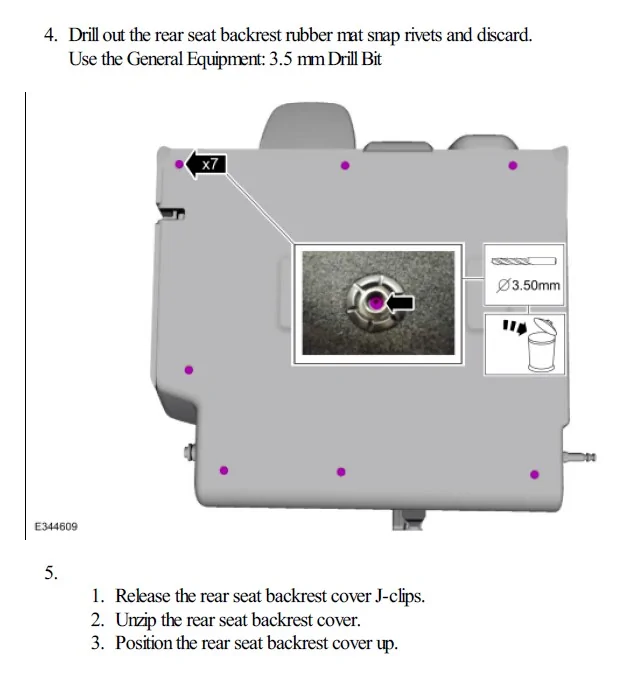

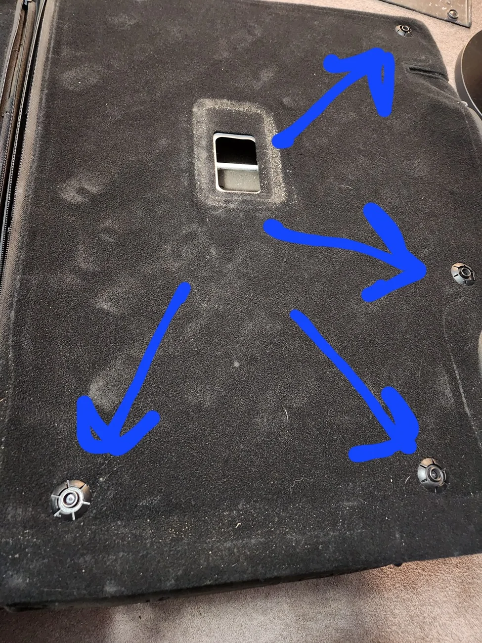

2021 Sport owner. Got my Bronco a few days ago. Came across a nice set of leathers for all the seats. As I'm trying to take off the rear seat covers I came across buckle/snaps on the backs of them. I removed the rubber covers, unzipped the sides of the OEM seat skins but could not figure out how to remove the buckle/snap on the back. It feels like they are pop riveted on? They will spin because I was hoping that they were just screwed on but no such luck.
Am I going to have to drill them out?
Anyone with any experience with them?
