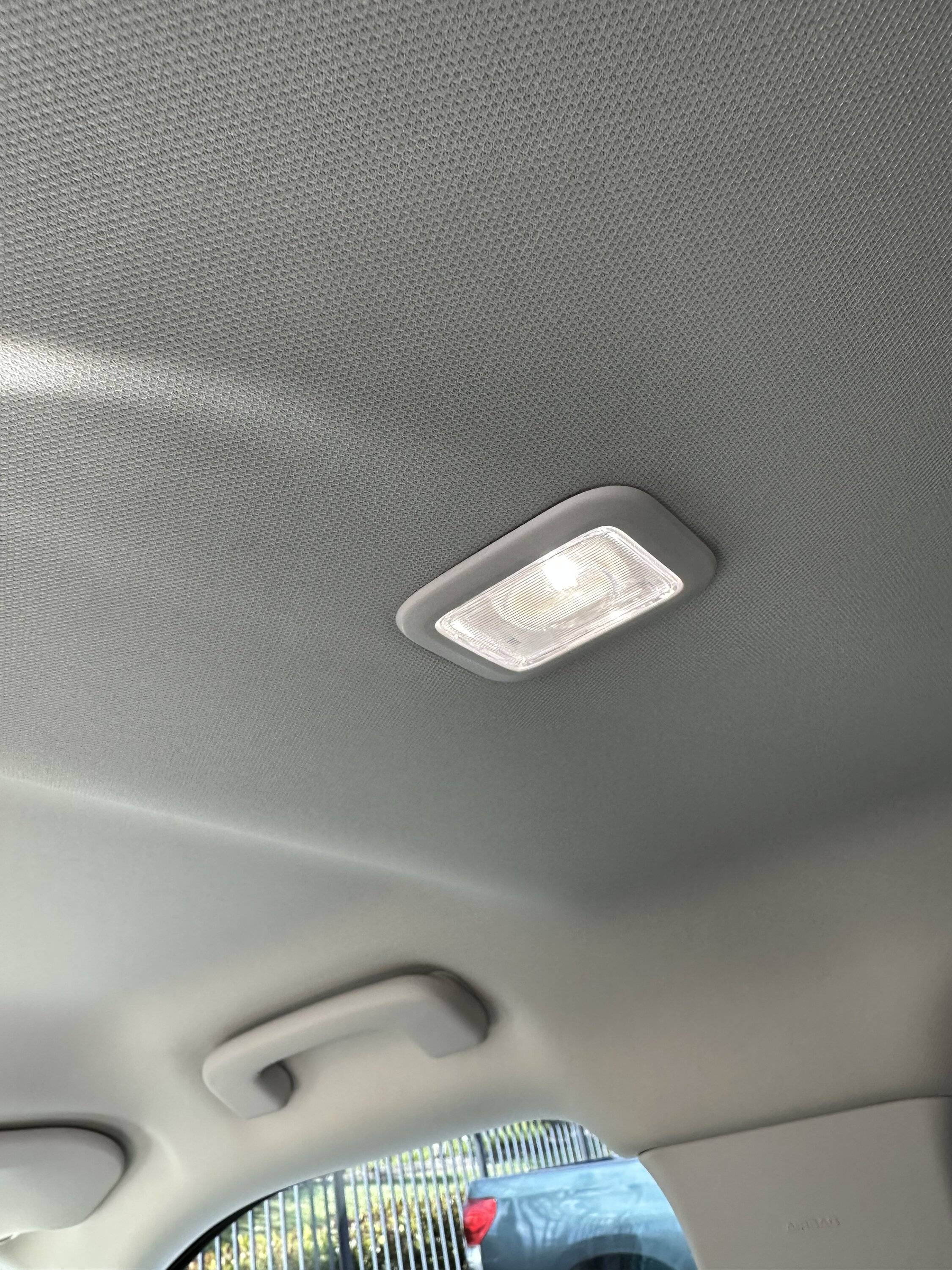

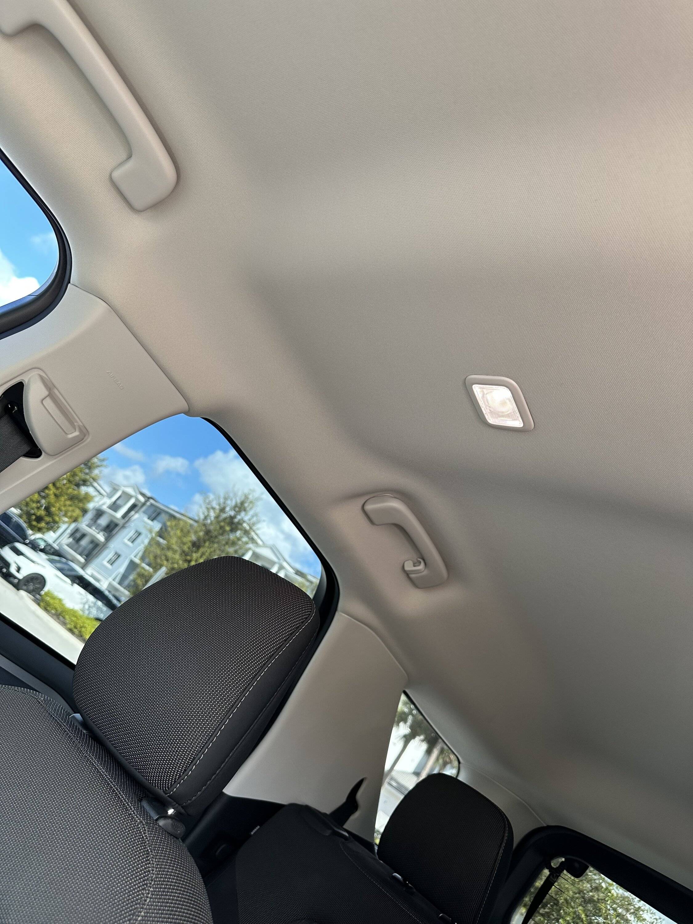

Trying to figure out how to pop the rear dome light out of the headliner so I can soundproof the infuriating annoying rattle that is being caused by the wiring harness connector.
I know there is a clip on one end of the lighting fixture to release it but I’m just wondering if anyone has had this issue or knows how to remove.
I don’t know if I can release this clip and just pop the whole peice out to access the wiring harness connector or if the headliner has to be dropped.

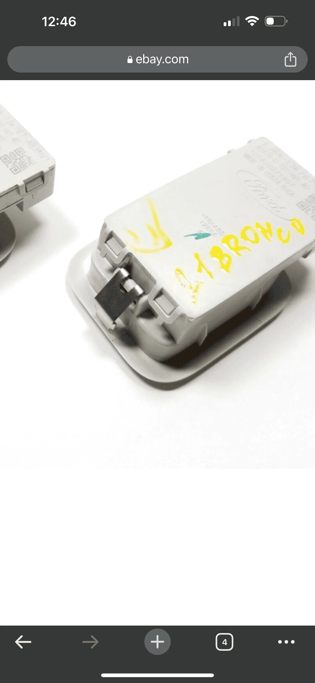

I found a picture of the part and there is just that one metal clip on one and that need to be pushed so it can be released but I’m not sure if I have to drop the headliner or if I can release that clip without dropping the headliner.

Just use credit card or something thin

Just use credit card or something thin push clip in and pull housing down comes out no need to pull headliner to get out.

ok yeah that’s what I was thinking I just have to figure out which side the clip is on.
I tried that initially before I saw the picture of the part and knew where the clip was and was unsuccessful cause I didn’t know where the clip was.
But now that I have that picture of the part the clip is either on the front or back.
anyone know which side that clip is on?

50/50 chance but I would try the front. Thinking it would be easier during assembly to plug the connector then insert towards the rear of the vehicle and then snap the front of the piece upwards. Also would make it easier to pull out if there was an issue. If you have any plastic pry tools, for trim, that might work better than a credit card.
