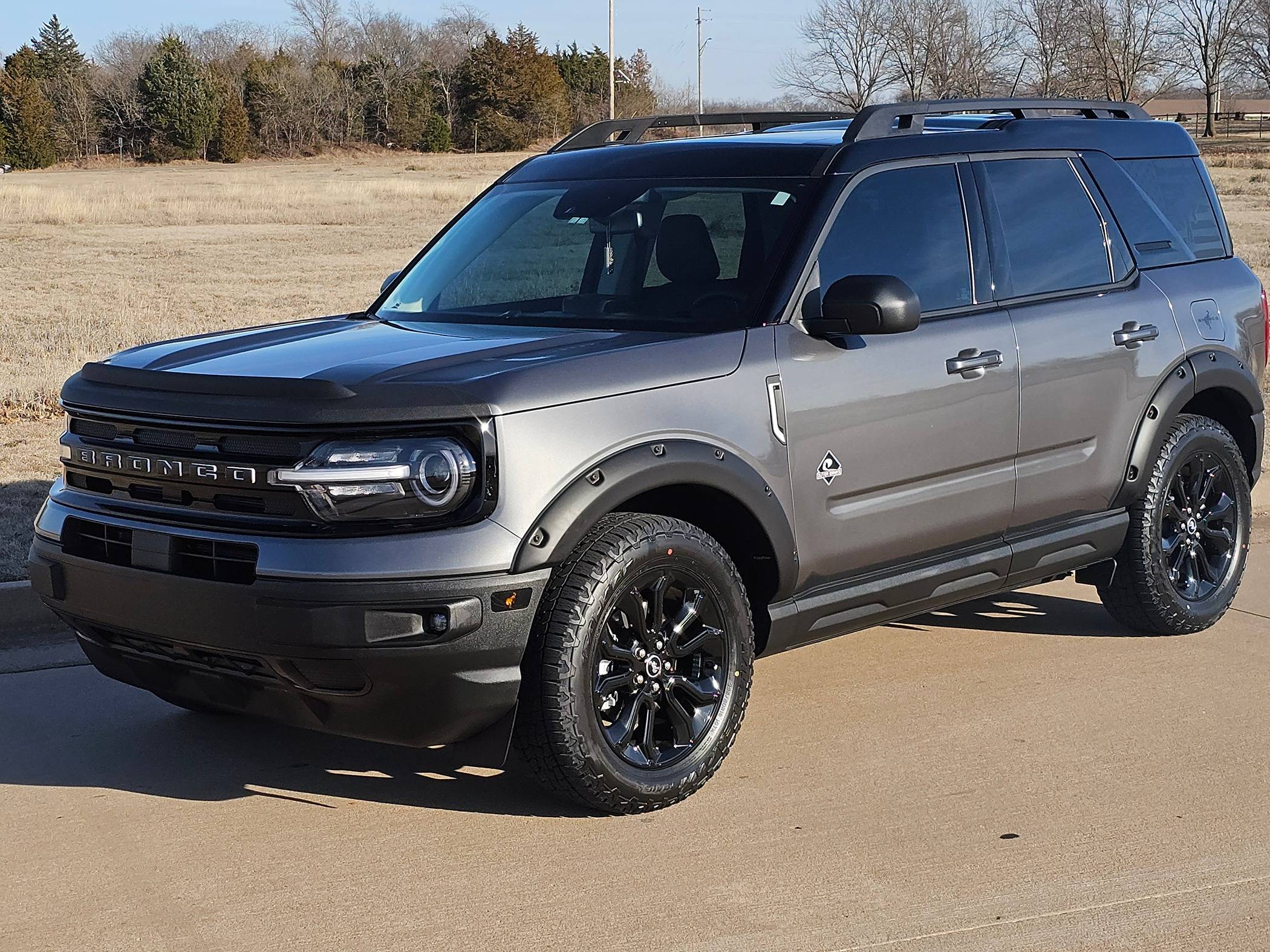

Anyone know what air pressure I should be running on my first edition badlands with 235/70/ 17 Goodyear tires at ? Thanks all
Ford Bronco Sport Question on tires: factory Continental vs. Wildpeak? IMG_1077
Lol. Can of worms here. Some will say 33 like the door sticker says. Others will say look at the charts and see what you need to run based on weight and that tires strength. You could also run a chalk test and see what psi applies even traction across the whole tread. I would say anywhere between 33-35 depending on how your ride feels to you. I run my 245/65/17 Toyo AT3 at 35psi.
If your ride feels good to you, and the tires are wearing evenly then it’s all good imo.
