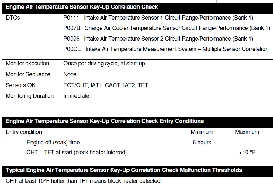

I have never had this fault code on my Bronco sport. For 2019 Ford products, the diagnostic works as described below, which SHOULD be very close to how it functions in our newer vehicles.
P0096 indicates there is a problem with the Intake air temp sensor 2 (there is likely 2 of them, but don't bet a paycheck on this). After a 6 hour soak (engine not running), at initial key on, the diagnostic in the ECU expects the three temperature sensors listed below to be within 30 deg F of each other. The "odd man" out loses and is deemed to be malfunctioning if this comparison doesn't pass. Based on a voting scheme, the sensor that is "out" sets the corresponding fault code.
The most likely cause is either a bad sensor, OR a problem in the wiring (short or resistance due to corrosion, pushed out pin in the connector at the ECU or the sensor itself).
If you want to find root cause and not waste money, you can check resistance between the sensor wires and the ECU and make sure the wiring is OK and check to make sure the pins in the harness are not pushed out and making poor contact. However, this may be a pain in the rear in practice, so depending on the cost of the sensor and your preference to spend more time or spend more money, it may just be easier to put a sensor in it and see if that resolves it. If not, then you can eliminate the sensor and dig into the wiring.
One more thing. You didn't add a block heater or anything like that, did you? Based on your screen name, I'm guessing you're in Texas and I wouldn't think it's likely you would have anything like that there. If so, that can wreak havoc on these diagnostics. The manufacturers usually put in some logic to try to "detect" when a block heater might be present, and then they increase the threshold (the 30 deg F to something higher) to prevent false failures, but this is not as easy as it sounds.
