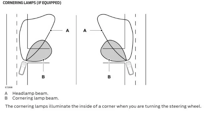

Just got my BS Big Bend last week and just drove it for the first time at night the other day.
I noticed that when I come to a stop the headlights seem to flash/dim a little and when I accelerate from a stop the headlights seem to flash/get brighter.
It is almost as if they a going into a different setting.
It is not the auto high beams because I have turned this setting off and it still happens.
It also happens weather I am in auto headlights or if turn the dial to select the manual headlights.
Is this something that is normal or is this an issue I should have addressed?

That’s not an issue. Those are the cornering lights. They come on when you are stopped and have the wheel turned sharply. They are supposed to shine into the turn.

That is what it is.
It must be just driving below a certain speed and turning the steering wheel. The steering wheel doesn't need to be turned sharply it seems. The fog light comes on when turning the wheel even less than a quarter turn.

I remember a few years ago when I got my first vehicle with adaptive headlights package, I went to the dealer complaining that there was something wrong with my fog lights that whenever I turned the wheel one would shut off, the service agent was very rude and condescending and just said you know I am not here to regurgitate stuff that you should know by reading the manual.
I was so embarrassed and disappointed with the level of customer service after sale that I even switched dealerships for service to a dealership about 60 miles further away, in the end it worked out because they are a better dealership and really appreciate me driving from so far to them when I have a dealership just down the road from the house and bend over backward to make sure me and my friends who I have converted to use them are satisfied.
Anyways I don't have a bronco sport yet but my bimmers all have that feature and normally even and a slight turn of the steering wheel is enough to trigger it, speed is not a factor.

My cornering lights only seem to work when fog lights are off. Haven’t noticed the head lights getting dim or bright.
