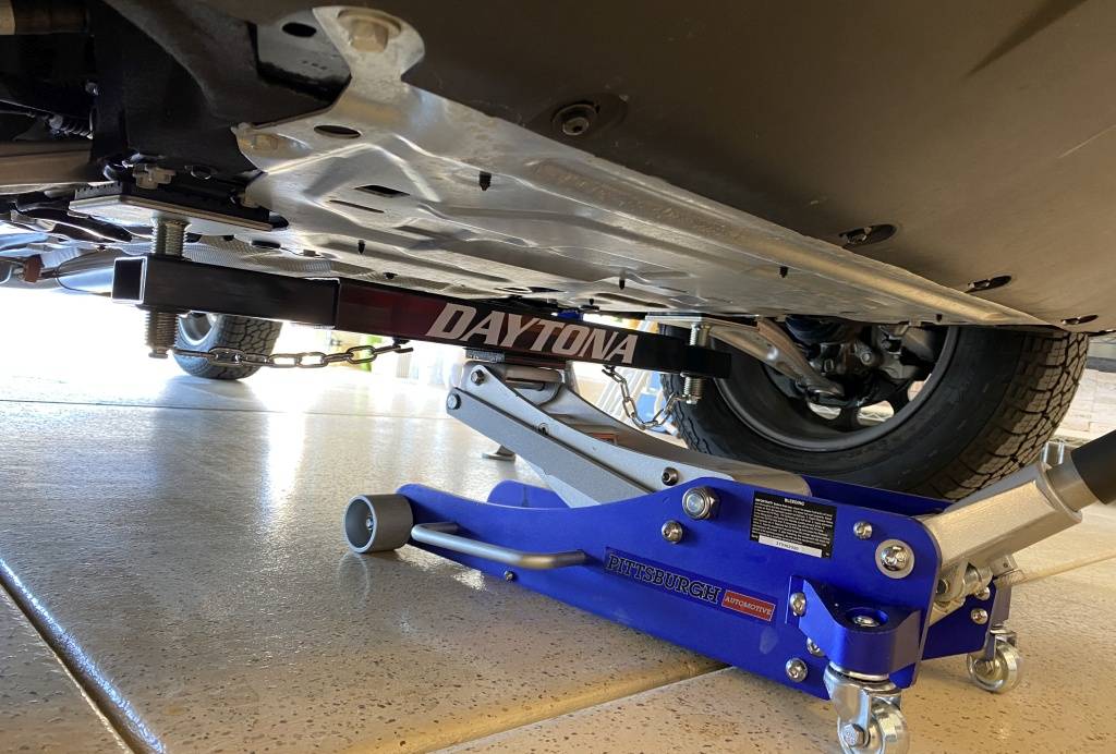

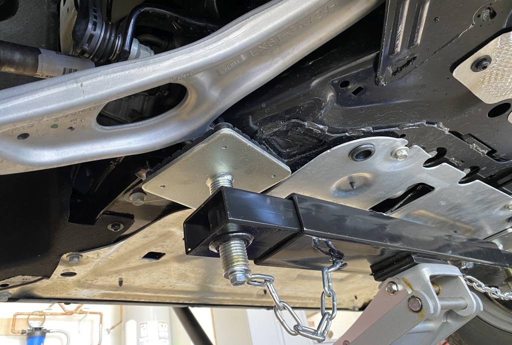

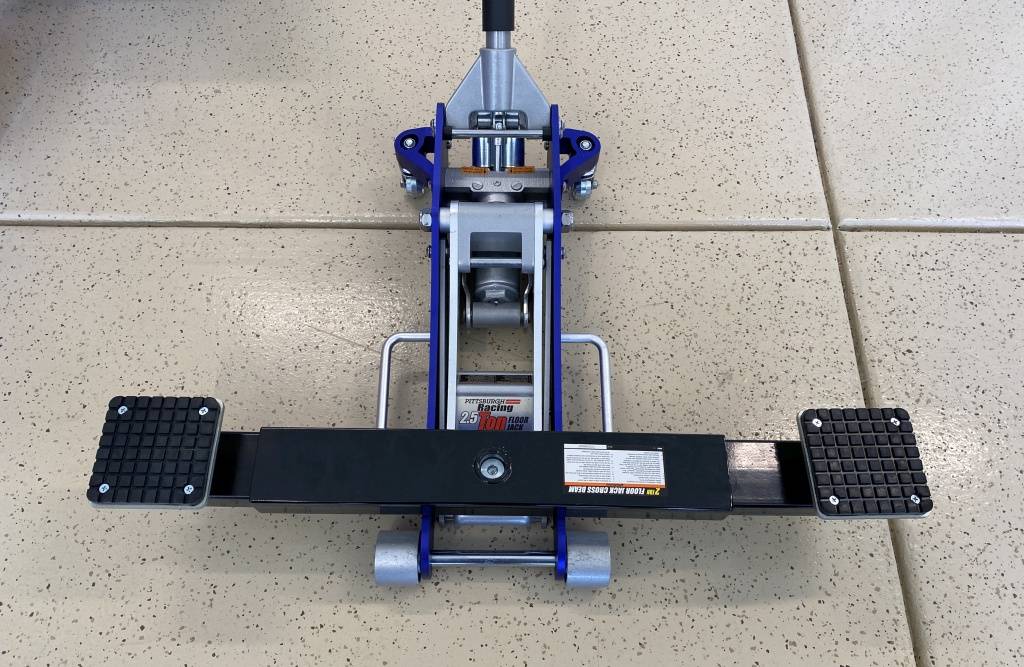

Harbor Freight sells an add-on for their floor jacks that allows you to lift the vehicle with two contact points.
https://www.harborfreight.com/steel-floor-jack-cross-beam-64051.html

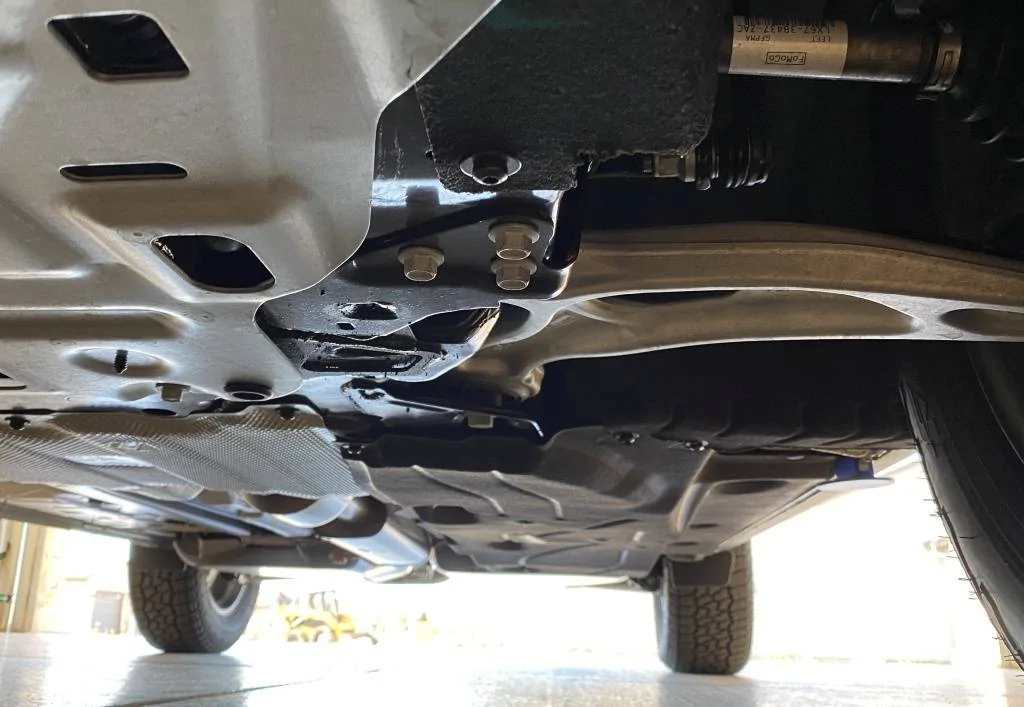

I tested it on my Badlands and it spanned the width of the skid plate that needs to be removed for an oil change.
