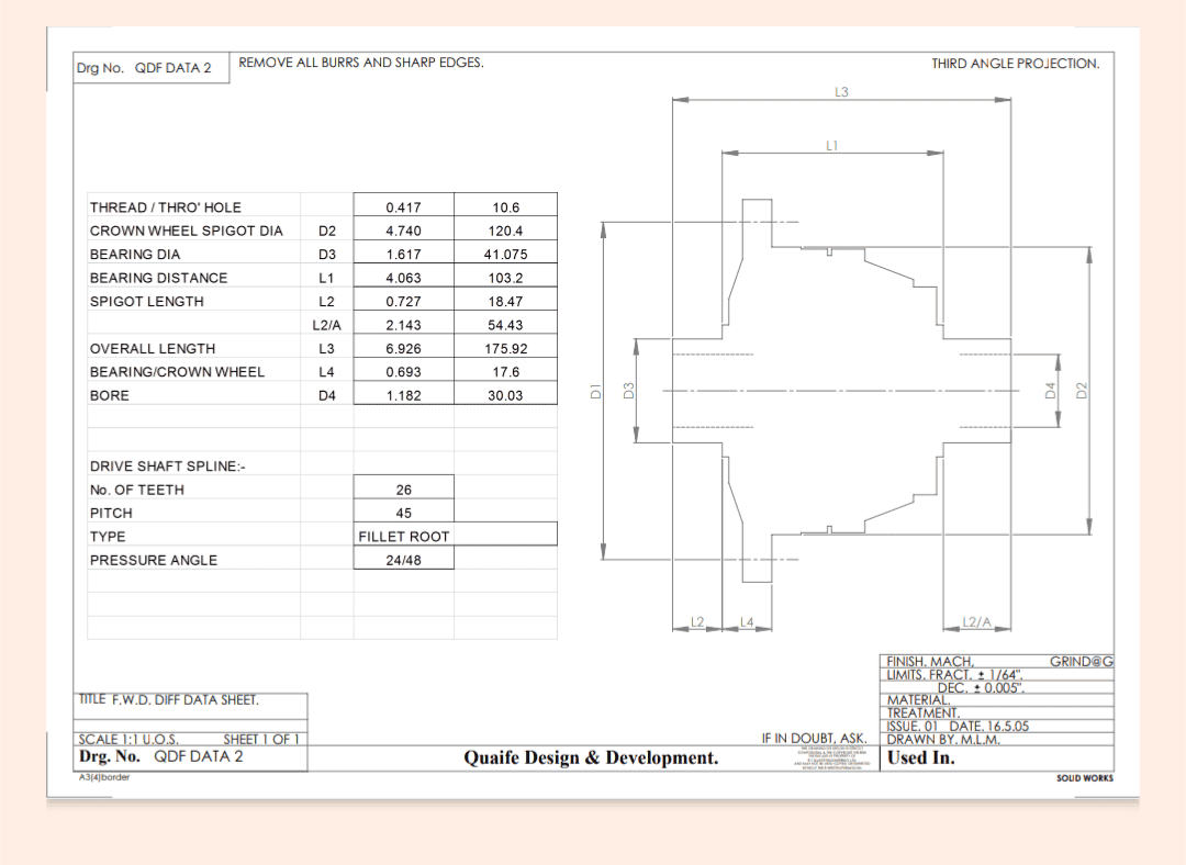

I wanted to put this out there in case anyone can help. I was trying to see if aftermarket limited slip diffs that can go in the focus RS would fit in our bronco sport front diff which is also called the PTU since It seems like the drivetrains are pretty similar, although I know they got the 2-3 instead of the 2.0 but one guy's already proved on the Maverick that those two engines both bolt up the same and at least on the Maverick even the wiring was the same and a guy got it. 2-3 working on a Maverick. Pretty cool. I think it's the same guy who used the Lincoln Corsair 2.3 turbo on a 2.0 to get a little more power.
Anyways I know that Ford even put the Quaife limited slip diffs in stock on the last few years of the focus RS. And I thought it would be really cool if we could have the front and rear limited slips instead of just relying on the braking system for the front because it can only do so much and it can heat up your brakes a lot too if you do it for a long time. I thought it would also be really cool for the lower trims that don't have the trick rear diff unit also and have to solely rely on brakes for traction control.
I was looking at pictures of them online and the cases on the outside are slightly different, but it looks like it might be similar enough that it would work. I emailed quaife about it but all they did was send me a picture of one of their limited slip diffs as a cutout section image. It wasn't like a technical drawing with measurements or anything.
Is there anyone on here that might be able to tell if the center sections are the same and if we could put one of those in a bronco sport. I assume the PTU is the same across the board, but I don't know for sure and I know there's some variation Tl at least in the transmissions for Ford's AWD system, especially from like a full size vehicle to a smaller one like ours. I know there's usually different ratings and internals.

Here's the diagram Quaife sent me of the focus RS unit.

Well, I haven't had time to work on this much since I looked at the initial diagram but it's looking like the housing might not fit so they would have to manufacture a whole new part just for us and on the full size bronco you would see a lot of people buying that, but I don't think a lot of the broncos sport owners would be willing to dish out two Grand for this and actually only bad Land owners would probably do it even though it would really help the other trims too since they don't have the special rear diff, but it is a big out-of-pocket cost you'd be looking at like two grand to have someone else install it a thousand really'd be like $1,100 for the part a couple hundred for the other parts and then probably like $700 to install it or more. So that's why I was really hoping that it would fit the exact same part. Then they wouldn't have to put in any r&d time.

Okay, I can pretty much confirm that this is a no-go at this point. I'm a little embarrassed but I'll go ahead and share. I was under the impression that the differential was in the PTU because that was how it was explained in numerous posts and it looked like it would possibly fit in there from the pictures I've been looking at cuz I'd mostly been looking at the PTU housings from this point.
Our differential is in our transmission which seems really weird to me and I have had some cars that were based on the C2 platform but I never really done anything but change the transmission fluid on them so I hadn't really thought about how any of that worked on these FWD based vehicles. I'm used to how like the full size bronco works, how you have a transfer case and a front axle with a front diff all by itself.
So anyways, I was watching a video about changing the front diff on a focus. I cannot believe I didn't didn't look at this beforehand and was just trying to go off of what I'd read and the differential I found out is inside the transmission. So then I watched a video taking apart the 8f35 transmission that's in our cars. Now it wasn't for an all-wheel drive bronco sport but doesn't seem like it would be very different since it's the PTU that affects the all-wheel drive versus just not having it there and having a longer cv shaft I assume .
So anyways they look to be pretty different and on the focus RS. There's actually 10 bolts that bolts to the ring gear but in the video I was watching the differential looks like on on this 8f35 it is held on by splines possibly cuz he just slid it off and didn't have to unbolt it from the ring gear which stayed in the transmission when he slid off the differential unit and just looks like a totally different unit. So pretty embarrassing. But like I said I hadn't done a lot of looking into this. You know it made sense in my head same platform, sure manual transmission versus an automatic. For some reason I had it in my head that the differential was in the PTU and that was what I needed to focus on and unfortunately there wasn't any information on the internals of the PTU so that's my bad. I'm going to leave this on here for a little bit and then I'm just going to delete this thread because it doesn't seem like it's even worth it. I don't think that it would be possible and I was fine with taking off the PTU to do this but dropping the transmission to try to figure out if they're the same. I'm not doing that. Especially when it looks like I can tell just from watching a video that they're completely different setups. If anything changes I'll let you know
