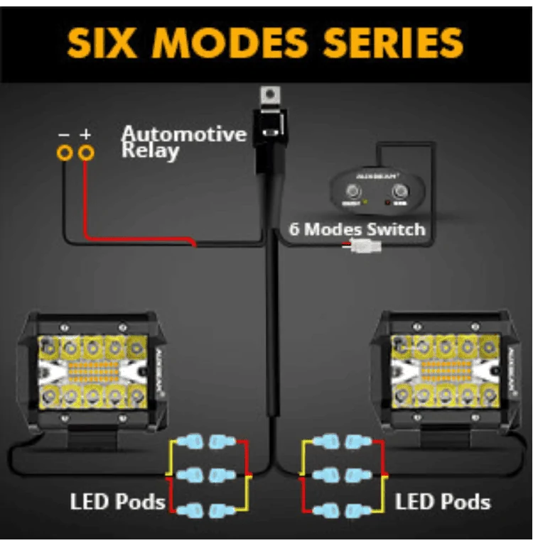

So I am looking at Ditch (pod) lights and one of the ones I like are the dual mode lights that you can switch between the white and amber. Here is my question.
I currently have the Auxbeam 8 gang switch panel and was wondering if it would be possible to hook these dual lights up to them? Could you hook it up so that the whites are on one switch and the amber on another? According to this manufacturer lights, the yellow wire is what hooks up to their switch to toggle between the modes. Is there any way to make this work somehow without using their relay & switch?

If you want to control everything separately as in Left/Right amber/white the Left yellow is one switch . left red is another switch and repeat for the right. 4 switches used.
